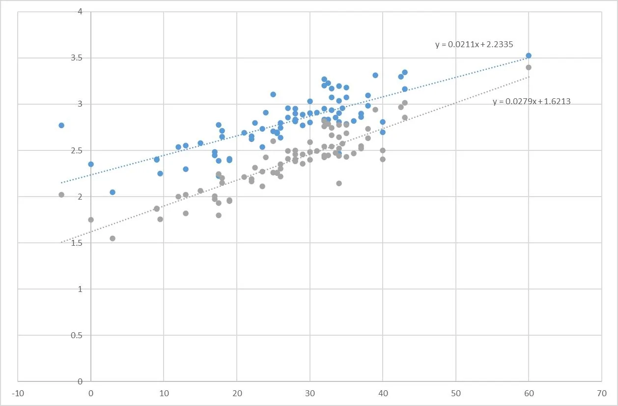

Is that miles and Fahrenheit ?
The horizontal axis is outside temperature in deg F. The vertical access is efficiency in mi/kwh. You can use the best fit linear equation line to estimate your efficiency for a given outside temperature and then multiply that efficiency by your battery capacity (for example 70 or 91 kwh) to get your maximum range. Unless you start at 100% and go to 0%, your actual range will be lower. Note also that the top line is what your predicted efficiency is in mi/kwh. However, the actual battery capacity decreases in cold temperature so that predicted efficiency will overestimate your range. The bottom line adjusts for that effect and should be a better estimate of actual range. Of course, more or less heat usage, speed, and elevation changes will affect the number also and are not accounted for in those graphs.
