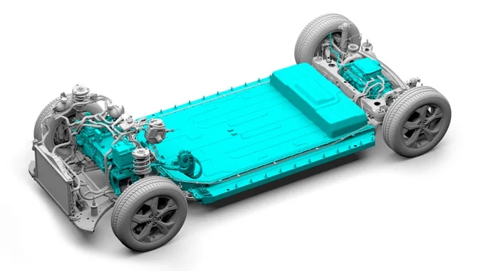

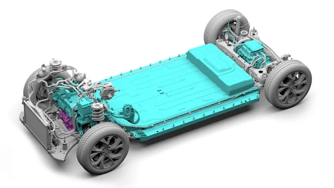

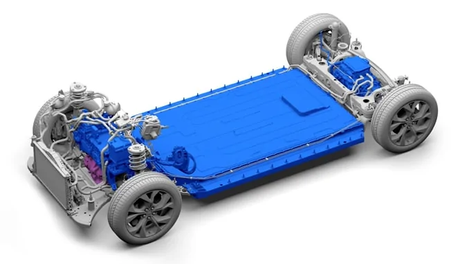

What is the extension on the ER battery? When asking if it you can install the larger battery, do they alter the space between cars? Edit = Sorry I noticed I attached the wrong image. These are both AWD now. (the previous had a RWD and AWD That's the extra purple motor)
This is a cool picture I never saw this before. It looks to me like the extra kilowatt hours are in a couple extra packs at the rear of the tray that stick up under the cargo area. The Sr doesn't have the extra packs but the base is basically the same from this picture
