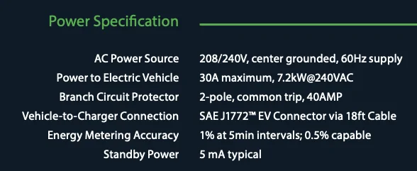

Does anybody know about the capabilities of Sema Connect? Where my son goes to college, they just installed six of them. Below is the spec. How fast will this charge to 80% from say 10%?
The sheet says 7.2kW so on an ER battery, going from 10% -> 80% will be about 60-70kWh of energy (depending on the buffer). Figure about 8-10 hours.
Ooo. Not too fast then. That trip at 180 miles one way, was influencing whether to get an AWD SR or ER. That is not a great situation for having to charge that long over night.
