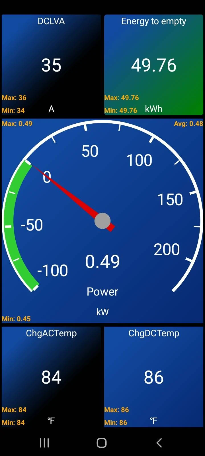

Edit: is there a way to get more accurate readings on how many kWh were added to the battery? Not the wall reading.
Ford has not seen fit to display that info to the masses yet. For a small investment though, you can pull back the curtain and see lots of data available via OBD. Energy-to-Empty can be used to determine how much energy has been used or added via charging.
OBD data from CarScanner app.:
Ford Mustang Mach-E Did I really get extended range battery? 1671376447757

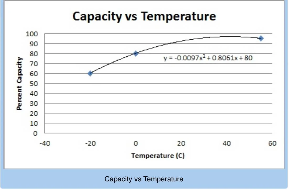

I’ve posted this chart before, but I think it adds to this discussion, so here it is again.
This is a typical Li-on curve, not the specific MME battery, but it gives an idea.
Ford Mustang Mach-E Did I really get extended range battery? 098190AF-C786-467E-A6A5-286BE5350745

Think of cold's effect on your battery like this: The farther you are away from the "goldilocks zone" for temperature for the battery, the more bricks are added inside your gas tank (battery equivalent in an ICE vehicle). You might not notice one or two bricks, but in Chicago cold, you've probably got 30 bricks in that gas tank and can't shove as much gas in as you otherwise would have been able.
Thank you, excellent explanation. I really thought I wasn't going to be the type that asks a dumb newbie question, yet I did ?

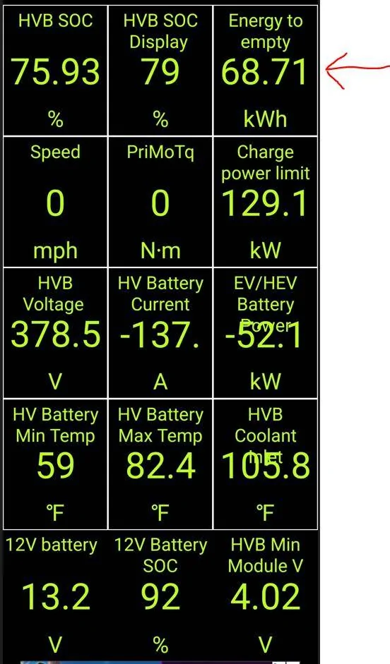

if you really want to see an accurate number for capacity, in kWhr, get a ODB2 reader like Viecar BT version for $25, and the (free) CarScanner app for your phone. You can see ALL sensor data available and define your own custom 'dashboard' .
Ford Mustang Mach-E Did I really get extended range battery? dashboard_4 power-chg temps-lv DC curr-kwhr
