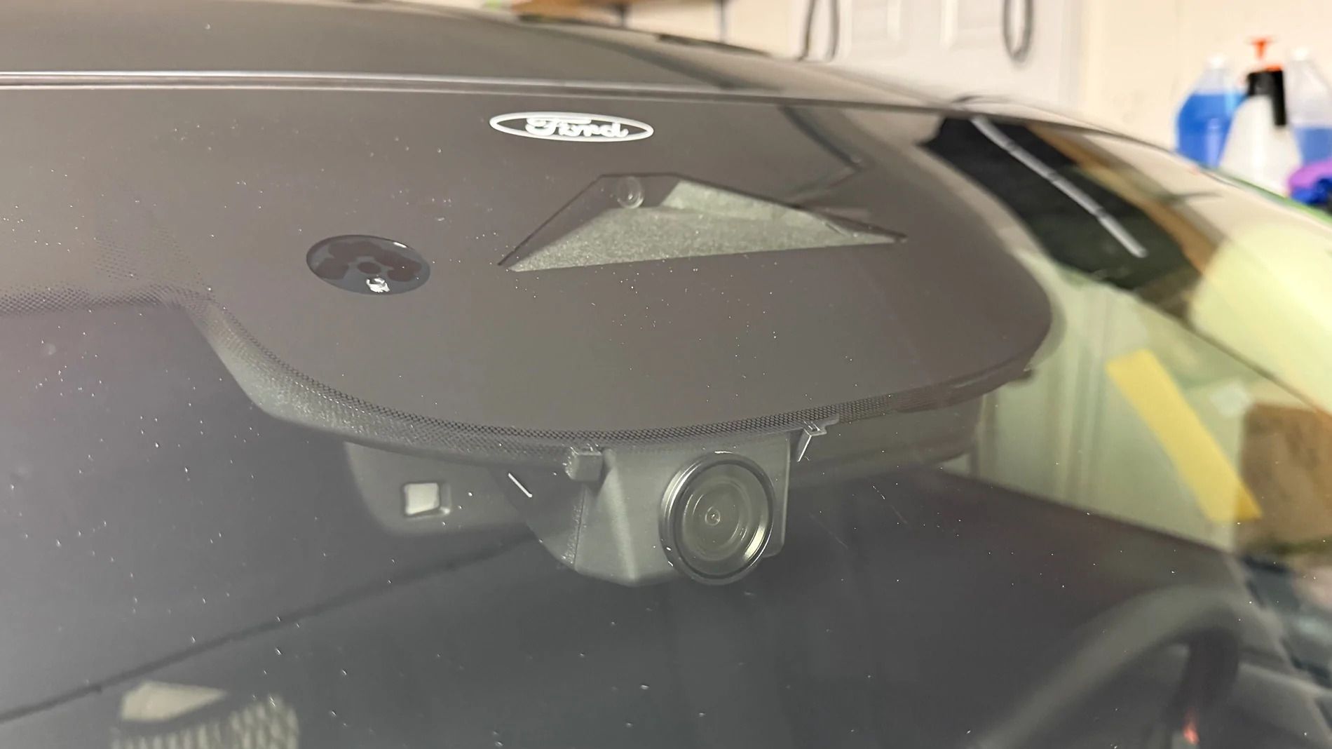

Yeah, my daily commute is about 80 miles or so, depending on which way I go, and have driven almost 11K miles since December. The 3 channel dash cam saved me from a potential insurance scam in my other car a while back, so I believe in them (as well as a good detector)! You can see the rear facing camera in the mirror's reflection. I had to get a little creative with mouting that one inside of the car, as I did not want to mount it to the glass and have the cable exposed enough to flex with the rear hatch opening.
I used a piece of 1/16" x 1" aluminum flat metal bent to a 90, and inserted it through a carefully cut (and cauterized) slit in the headliner material. Camera (of course) is mouted to that. Just painted it black to match the interior, and all you can see is the camera, and about an inch or so of the connection cable as it loops back towards the aluminum bar. I hated to do that, but it came out pretty clean, and is positioned well. I realize this isn't related to the original post, but thought I'd share.

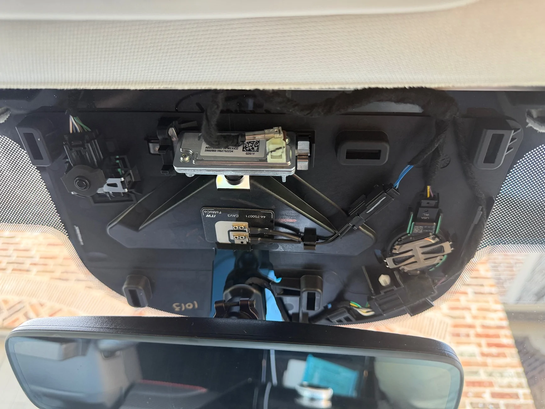

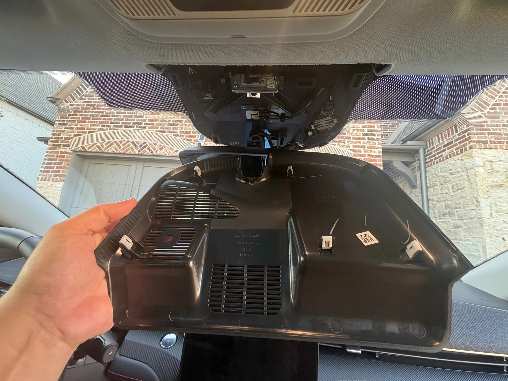

I accomplished the mission…here is my write up!
2026 Mustang Mach-E Premium
Parts
Radar Detector -> Escort Max 360c
Mount -> BlendMount BMG-2001R and the Escort Suction Cap
Wiring -> MirrorTap MTX-1015
  1. Follow instructions included with the BlendMount to reuse the magnet from the Escort Suction Cup Mount
  2. Remove the Mirror Wiring Cover -> for orientation, the rear of the cover is nearest the back of the vehicle. The front of the cover is nearest the front of the vehicle. Left side is driver. Right side is passenger. Start by working your finger between the cover and roof material of the back left corner of the cover until that clip releases. Then work your way along the rear edge towards the right side of the cover releasing two additional clips on the rear edge on right side of the mirror. Work the towards the front on right edge to release an additional clip on right side of the mirror before crossing back to left side of the mirror stem to release the final clip. The mirror cover comes off and down to hang on the mirror stem. That exposes the wiring.
  3. MirrorTqp Wiring -> relevant wiring harness is located at right rear corner. See photo. Red/Positive wire goes in the Purple slot and Block/Negative goes in the black slot. Route the wiring towards the mirror stem before putting the mirror cover back on essentially in reverse order of removal.
  4. BlendMount -> follow the instructions provided with the product. Adjust to your visual preference. Works easiest if installed from the passenger seat vs driver seat. Just more physical room to work given the mirror orientation towards the driver.
Video for Wiring Details (can’t take credit)

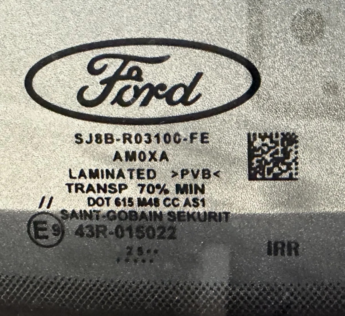

Just curious if your 26 has the IRR letters/label in the corner of your windshield? If so, please post a pic. Nice write up, by the way!
The 2026 does have the IRR letters. See photo. What does the IRR designation mean?

R/L
Bob
Apr 16, 2026
51
SW Michigan
2025 Mach-E AWD Ex
IRR = vehicle windows or windshields manufactured with an Infrared Radiation (IRR) rejecting coating or interlayer.
The owners manual says:
Install any devices that use radio frequency identification, for example, toll readers or vehicle identification cards, to the specified area on the windshield. That area is the shaded area either side of the rear view mirror.
Goes on to say, The remainder of the windshield has a coating that prevents the device from working properly.
