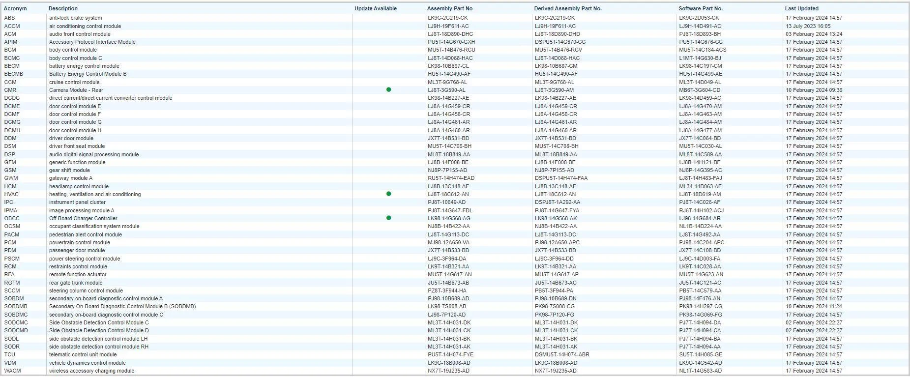

If someone applies this CMR module update manually via FDRS, could you post details about the module software version? If we can verify that the update is available in FDRS, I may manually apply it instead of waiting for it via OTA.
PTS is showing a CMR update available for you. Remind me later to check in FDRS to confirm for you.
