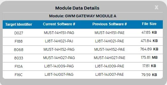

Looks like my GWM was hung and causing the update to hang. After a day of no activity, I reset the GWM using Forscan and immediately it progressed to the next steps and started downloading the update.
Orrrrr you don't wait and you do that I guess

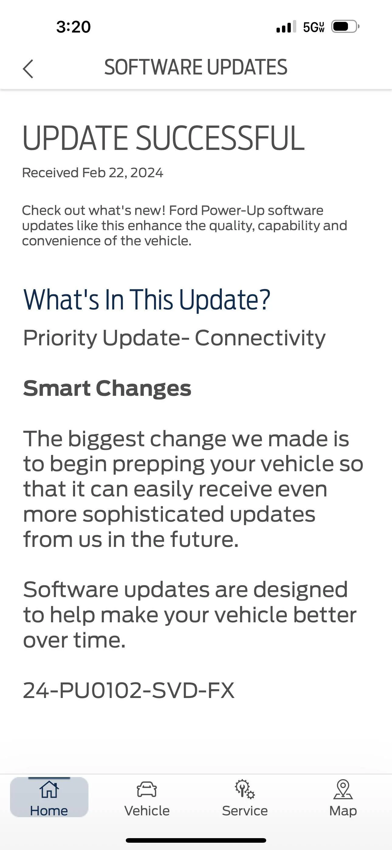

I got the update on the Feb 22. It notified me in the app. I’m on 6.13. If someone wants more info on my car let me know. I bought it Nov of last year.
Ford Mustang Mach-E 24-PU0102-SVD-FX? IMG_2429

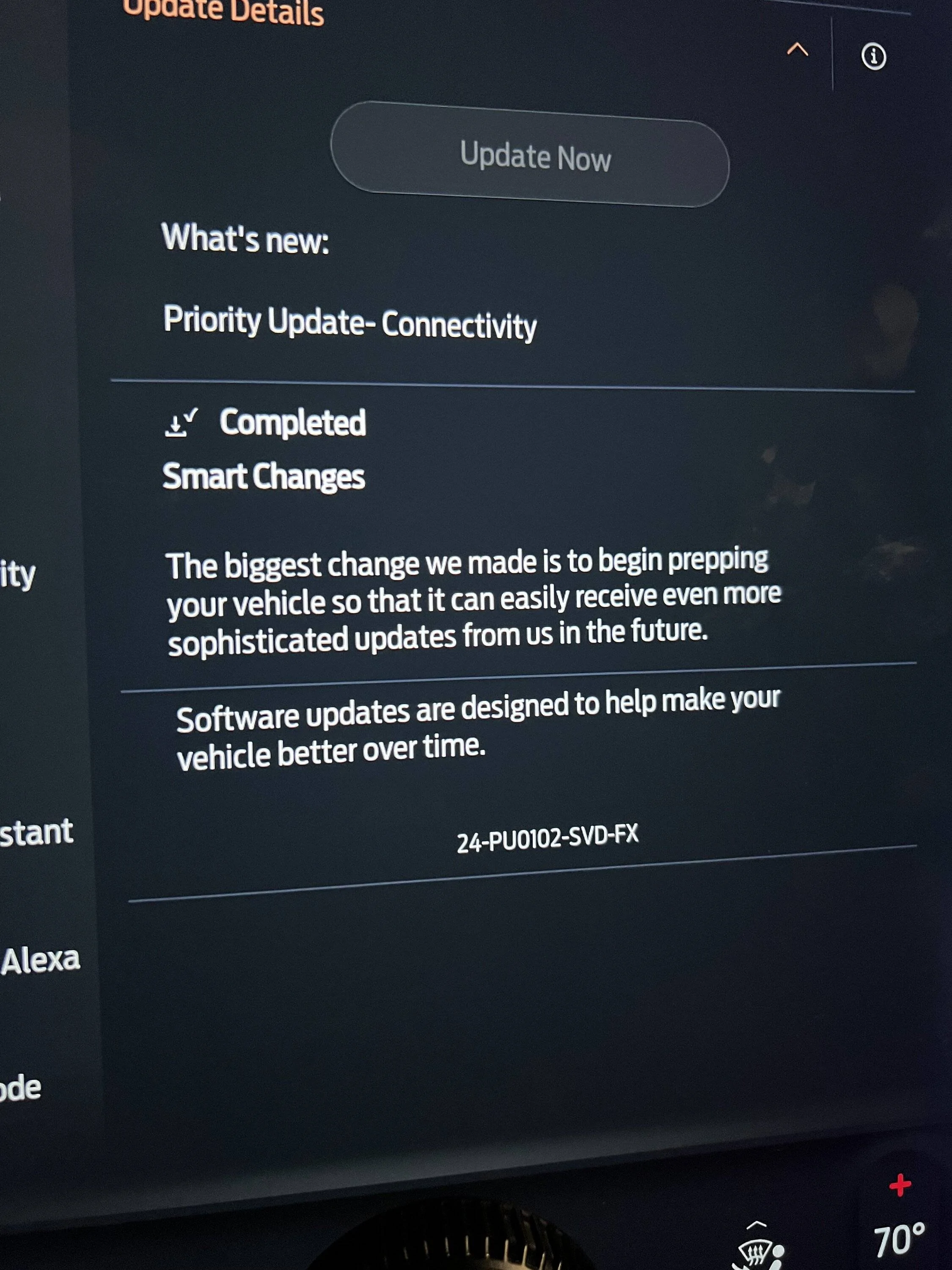

2021 Job 1. Got the update today too. Anyone know what it does? The notes aren’t descriptive.
Ford Mustang Mach-E 24-PU0102-SVD-FX? IMG_3405

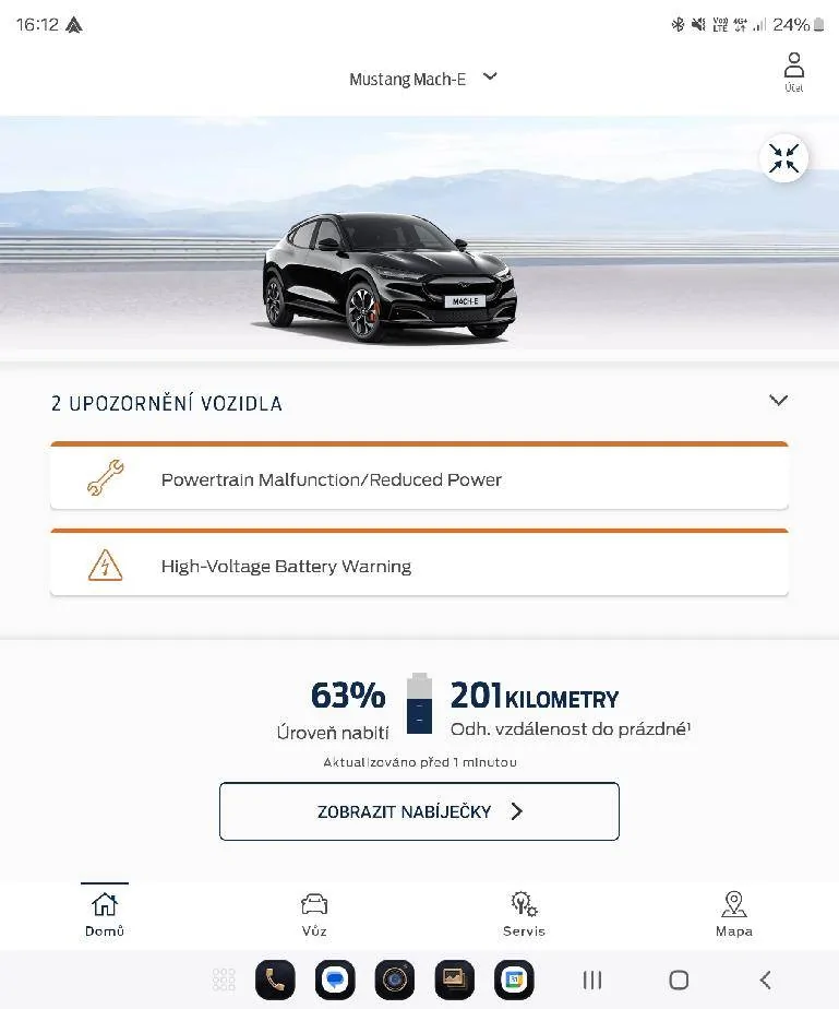

I received this update today. It installed while driving and two errors appeared during the installation. High-Voltage Battery Warning and Powertrain Malfunction / Reduced Power. I noticed a reduction in vehicle performance. Do you think it's a coincidence or the update messed something up?
Ford Mustang Mach-E 24-PU0102-SVD-FX? stáhnout (2)
13,029
17,582
Try cycling power on the car. Sometimes the car will erroneously report an SVS and a power-down, short wait (10 or so minutes), and a restart will clear it. ??
