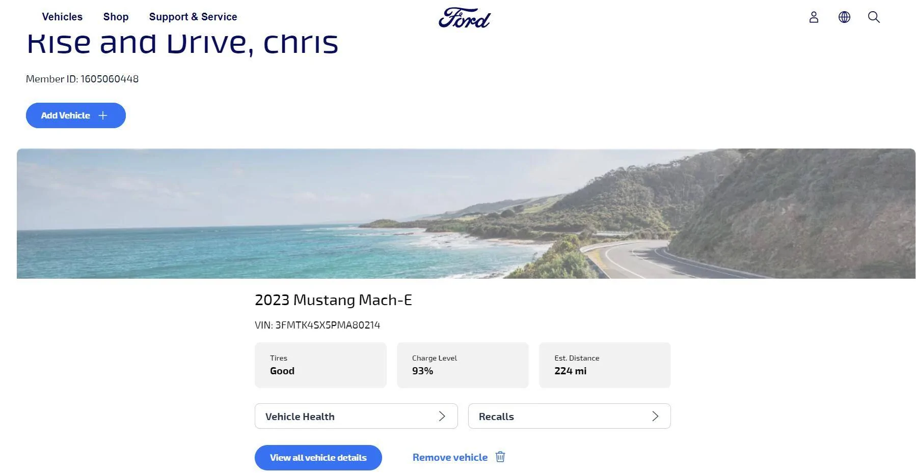

I’ve tried this update about 5 times now. This Is the first time I have had an issue getting an OTA.
zvez
chris
Dec 31, 2020
2,441

what's your state of charge on the 12v? I know someone on the BEV team told me that you need 80% or better for some of the updates (this was when I was experiencing issues with charging not stopping which has since been sorted by ford)
You were right! Checked my 12v and it was at 72. Charged my car to 100% and got the 12v to 83%. Worked!

I've gotten in the habit of checking 12v SOC a few times a week. With the access to the info on the ford site it's easy enough to do.

go to ford.com click on person icon upper right. pull down menu "sign in" once signed in click on the person icon again in upper right, pull down menu you'll see several c
Ford Mustang Mach-E 24-PU0102-CHG-SUFX state of charg
hoices, the first one should have your first name or such (mine is "chris' account). Click on that this is what you'll see, middle is state of charge of 12v battery. This seems to update constantly at least after every drive or charge.

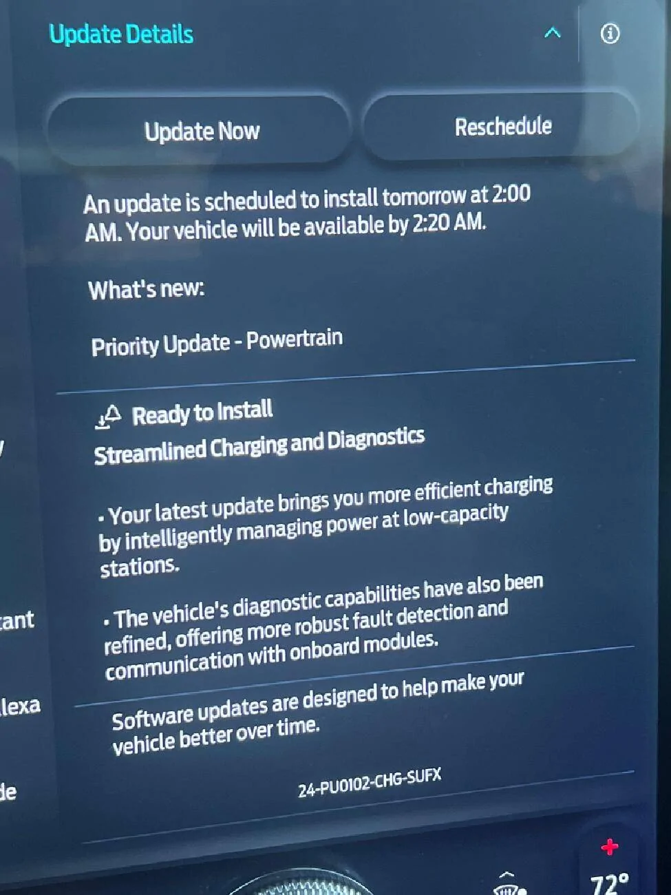

Just got this one queued up. ‘21 J2 GT PE. I was on 6.7.0.
capkmo
Feb 9, 2024
Oregon
2021 Mach-E GT PE

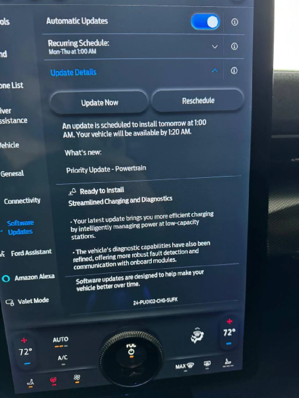

‘21 Mach E GT PE and I just received the update. Instead of waiting for it to install automatically I accepted when I pulled into the garage and plugged in
24-pu0102-chg-sufx
Ford Mustang Mach-E 24-PU0102-CHG-SUFX IMG_0027

21GTPE got it today 2 days after getting 24-PU0102-SVD-FX. Lets go still on 6.7 since 12/15/23 let the OTA FLOW ??
Ford Mustang Mach-E 24-PU0102-CHG-SUFX IMG_8301
