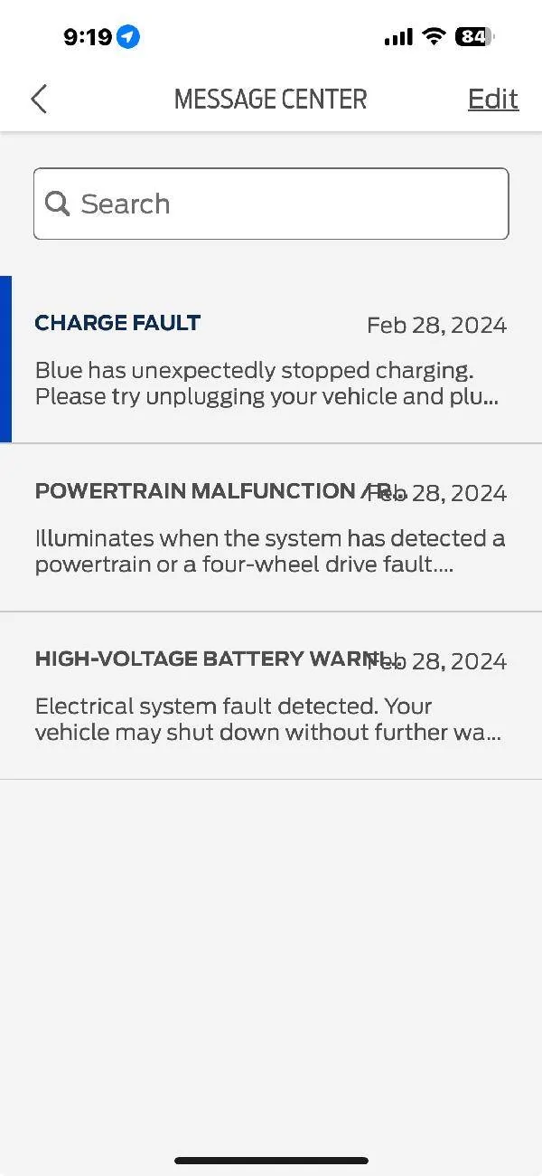

My wife took the car ('22 Premier AWD ER) out this morning and received error messages for Cross Traffic fault, Pre-Collision Assist Not Available, and Hill Start Assist. I checked my phone and received the same notices. We have never received these before and lo-and-behold, 24-PU0102-CHG-SUFX installed last night.
Please be aware and careful on the road if you receive this update. I'll be calling the dealer when she gets back.

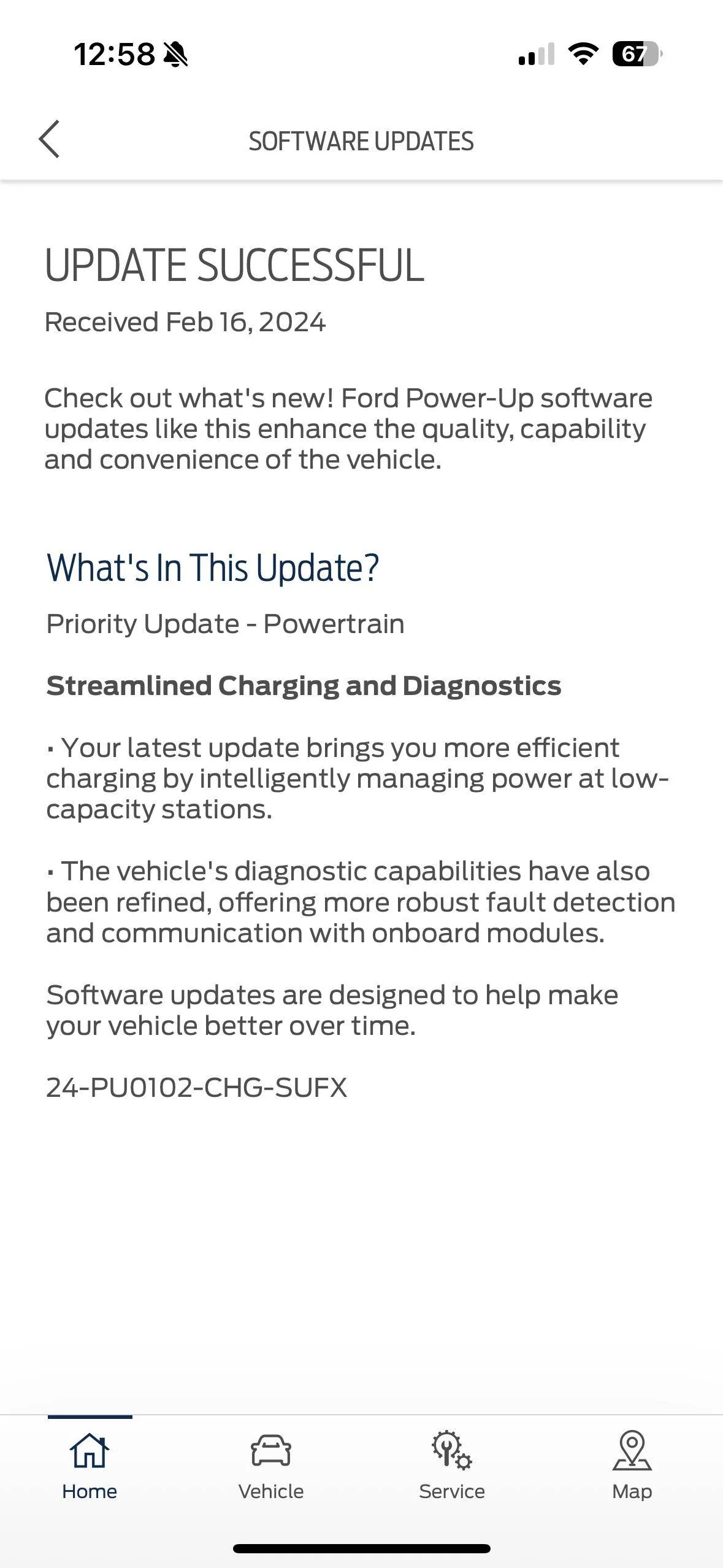

Got a slew of errors yesterday after update . I level 3 charged 2x a week ago after having only used level 3 twice before in the last year. Dropped the car off this morning but would like to know what the codes say so I have some ammo. Vin 3FMTK3SU5NMA41653
** update: The software update was 24-PU0102-CHG-SUFX. The codes showed up after the update.

Well bad news from Ford. They said they have to replace the entire battery and that it will be 3 weeks out. Crazy how fast this went south. Applied the 24-PU0102-CHG-SUFX update and got a slew of errors when I started the car the next day. Wondering if the update found a lurking issue with the battery? Strangely enough the HVJB recall did not affect my 22 MME model and they are not replacing the it as part of the procedure.

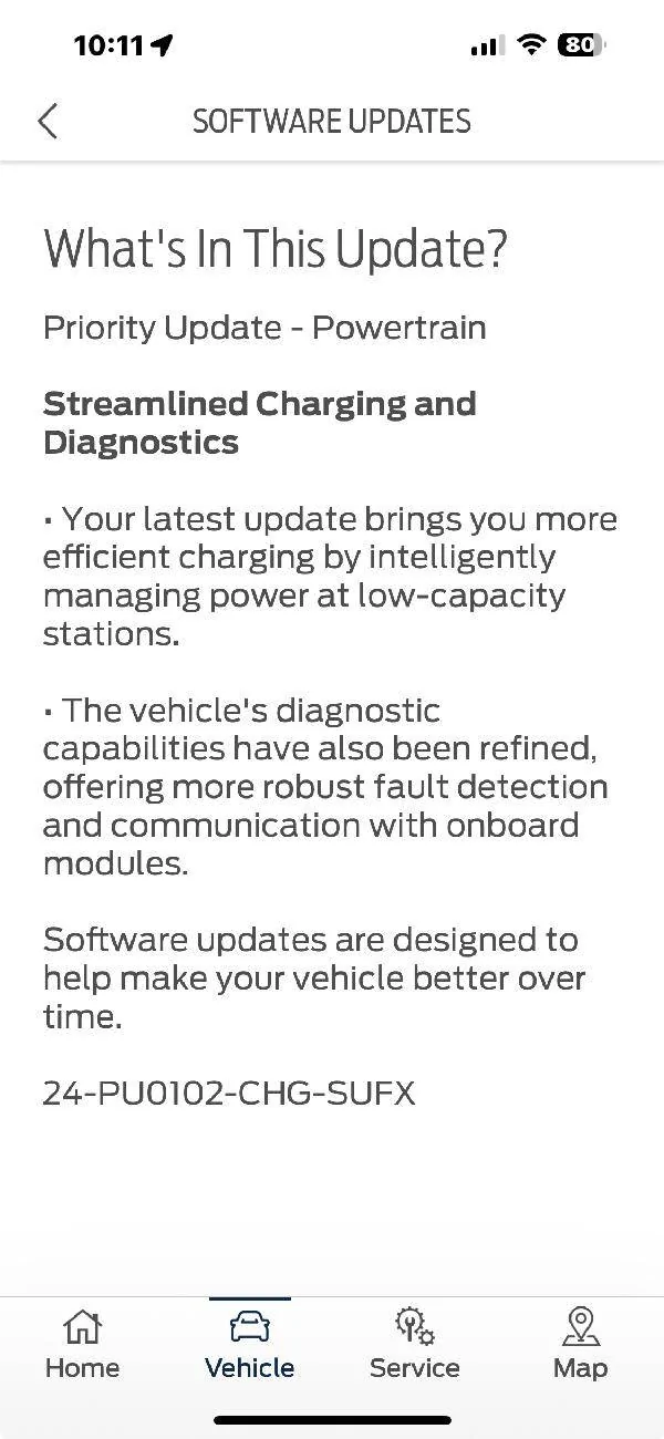

Just received this update. I am on 6.8.0. Says its a power train update and not included in the poll.
