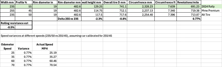

I created a chart comparing the 2 tire sizes:
Ford Mustang Mach-E 255/45/19 VS 235/50/19 1780002137240-ku
Note that the 255 will have more rolling resistance because it is 20% wider, but a firmer (shorter) sidewall for better corning. The 235 should have a slightly softer ride due it its slightly taller sidewall. Your speedometer will have a very small variance (see chart), and negligibly slower 0-60 times.
My Rally has 235/55/19 as stock tires; however, my chart only compares your 2 proposed tire sizes.
Lastly, I suspect you could experience marginally better range on the 235 tires, but handling may suffer slightly.
*** DISCLOSURE *** I am an electronic engineer, but not an automotive engineer. And I recently stayed at a Holiday Inn Express (LMAO). My report is theoretical and not a guarantee of future results.

Thank you so much for this thoughtful reply! I ended up going with a 245/50 to try to meet in the middle. Much appreciated!!!
