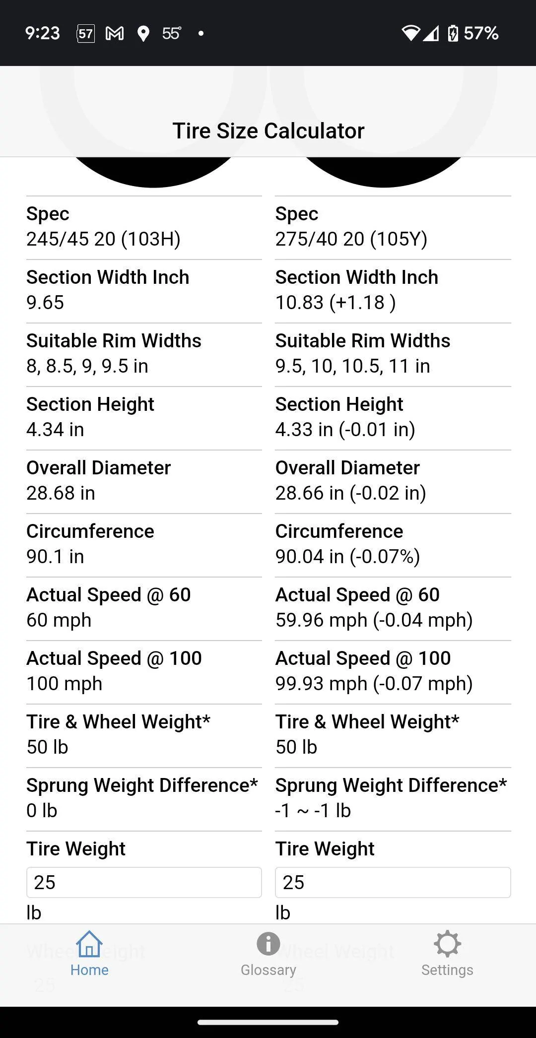

Interesting, my guy.told me you can't stagger the Mach-E.
As Brian said above, you can stagger anything. While it is ideal to have the same exact diameter front and rear with AWD, as long as you are within a 2% difference, you will be ok. Manufactures that offer staggered wheel setups from the factory on their AWD cars (BMW, Porsche, Mercedes, etc) have setups that are no more than a 2% difference front and rear.
Earlier this year, I posted a long winded thread of my Mach-E staggered setups:
https://www.macheforum.com/site/threads/my-staggered-wheel-tire-setups-info-specs-opinions.28097/

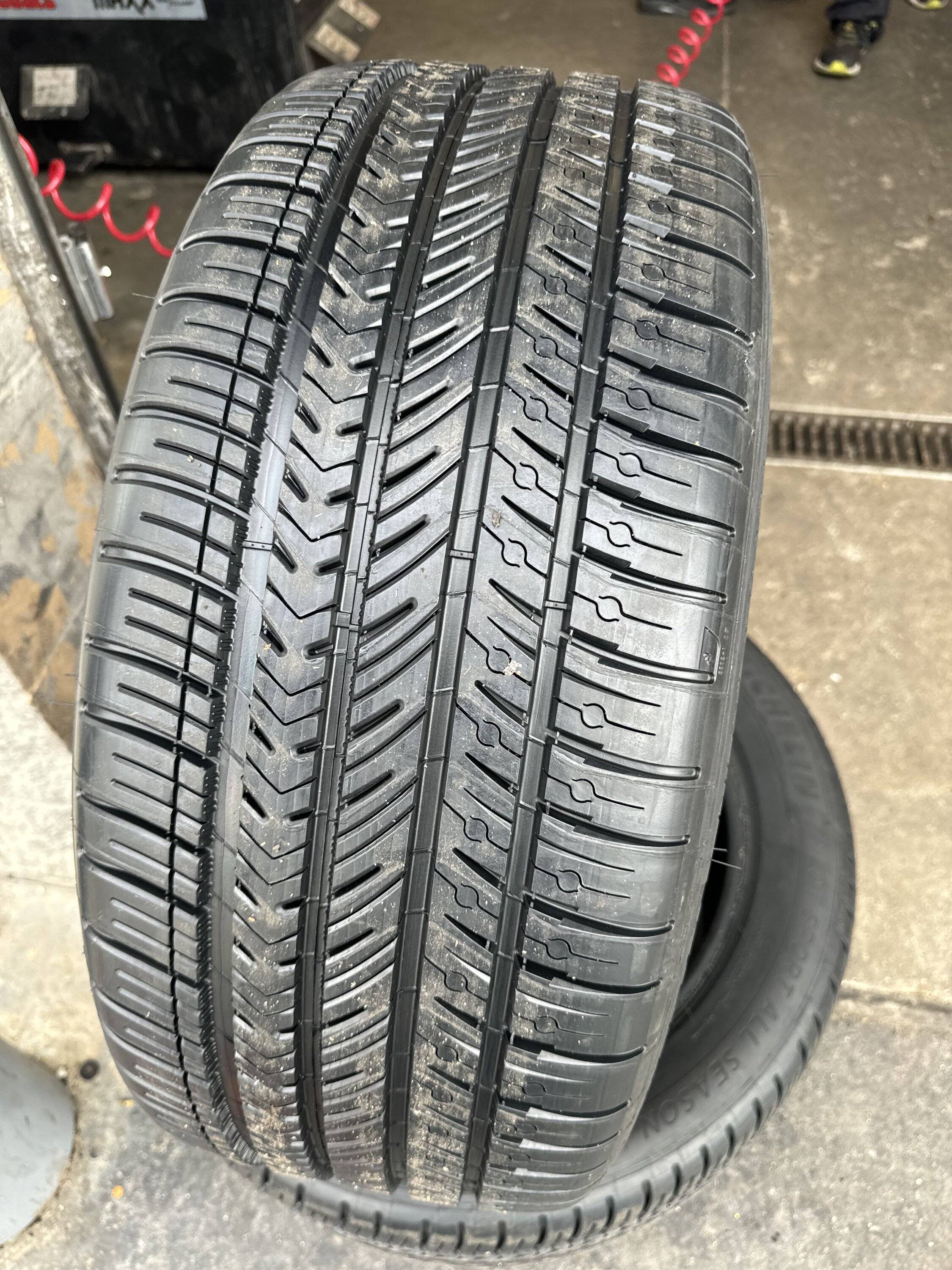

Made the choice; Michelin Pilot Sport A/S 4s in 245/50/19. I was thinking about going to 20s with 255, but decided on keeping stock wheels. These are a very noticeable improvement in overall road feel and I suspect will be an extremely suitable year round choice for my wife's daily driver from the farm east of Austin to Austin. Thanks for the guidance y'all.

Those are a good choice, one of the best all season tires on the market.
I don't mess around with tires, though my last four vehicles have been trucks with ATs. This zippy car thing is new to me (and I like it).
