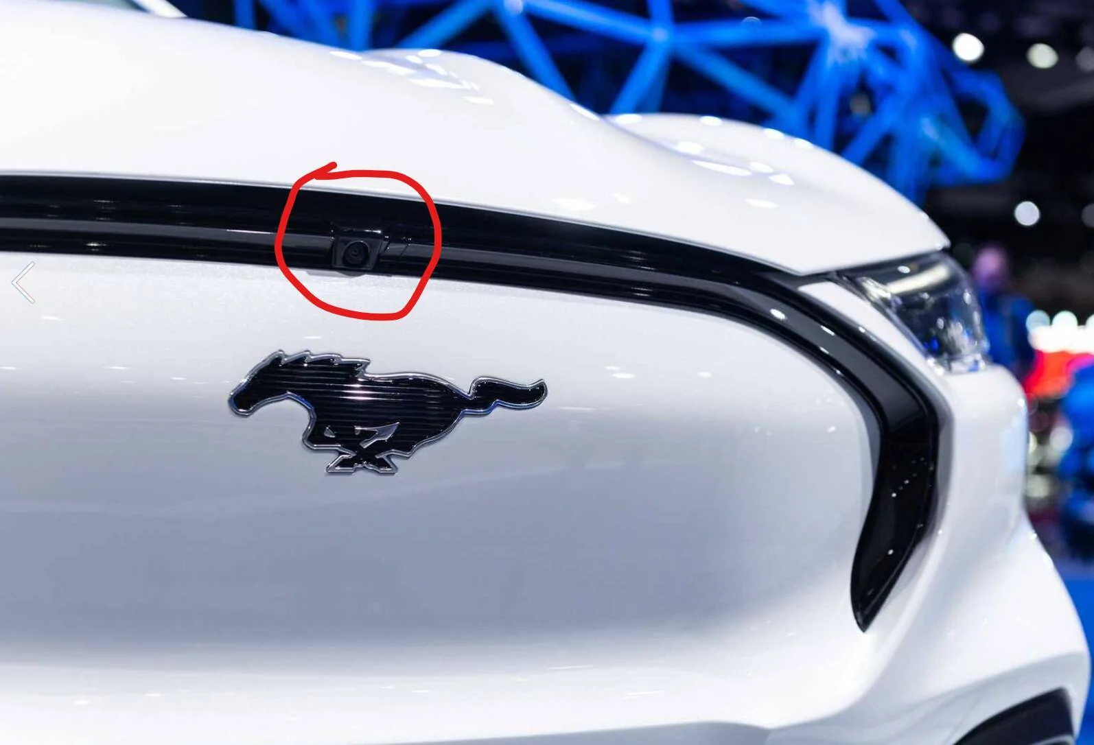

It may be referring to the camera at the top of the windshield that's used for lane centering. It should be pretty easy to tell if you have the front camera or not. It would be right here:

That makes sense! There is definitely no front camera in the grille, I looked everywhere last night. The error hasn’t popped up again either.
I think we’ve settled it now. ?
