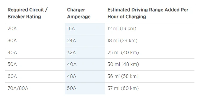

I’m new to this Forum - first message. I have a 2021 GT PE, Grabber Blue. Just had the electrician install the 240 plug in the garage and 40AMP breakers on the box. Problem is, when using the provided Ford charge cord, I’m still charging at the same speed as the 120 plug?
Also, I saw someone posted a calculation to determine the time miles charged per hour when using this setup but I can’t find it again. Can someone copy and repost?

It's the second post in this thread.
https://www.macheforum.com/site/threads/40-amp-or-50-amp.15550/post-372301
I don't like using miles added because it assumes a specific efficiency that you might not get. It is better to look at the charging speed and how many kW you can add per hour, IMO.

That seems impossible, did he check that the outlet was wired correctly? 120V to ground at the two outside slots and 240V between the two outside slots.
Charging MPH = (W * % efficiency) / (Wh/mi) or (kW * % efficiency * mi/kWh) depending on which units you like. 240V charging efficiency is around 90% IIRC.
