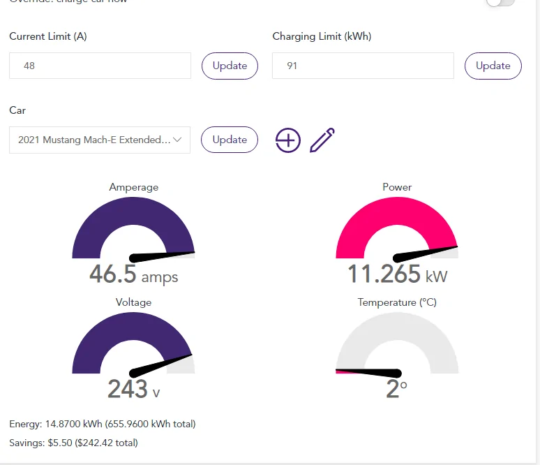

Correct, 48amps, which is 11.52KW. My house varies on the V, seen as high as 248 or 249, so closer to 11.9KW.
I just ran it at 48amps, and it maxed out at 11.27Kw.
Correct - I’ll update my post.
thanks for the verification.... you and @delacruz.c5d clearly show the MME can take 48amps
I was going by the docs; which as we've seen are not always 'accurate'.

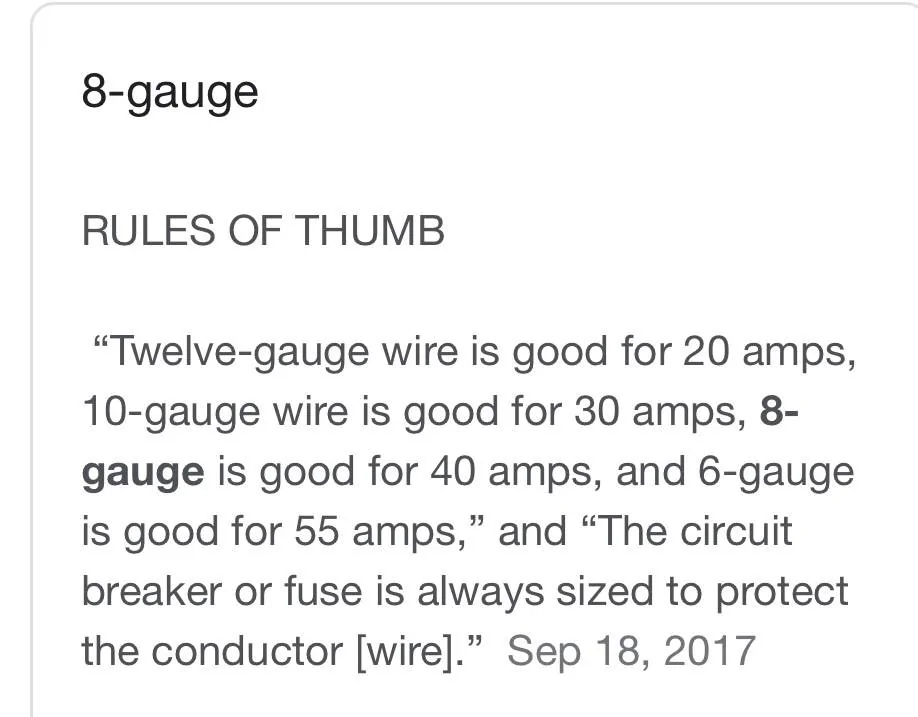

40 or 50 only for a nema 14-50 socket
correct about the 125%, but you are allowed to put a 14-50 on a 40A circuit
yes, with 6 ga copper you can use a 40A or 50A breaker.
6 ga for 40A?

6 ga for 40A?
#8 copper is the MINIMUM for a 40 amp circuit - but you can use heavier wire than you need so #6 will work for either 40A or 50A. The only reason to use heavier wire is "just in case": you never know what the future will bring and as I mentioned before running heavier wire prevents you from having to "do it over". You can run #6 on a 40A breaker with a 32A or lower EVSE. Then, at some point in the future when you have 2 EV's in the house you can replace the single EVSE with a dual-port one that can charge 2 cars at a time.
If you'd rather save the $50 and use #8 for your 40A line it will work just fine. I used #8 off of a 40A breaker to my 32A EVSE because I had leftover #8 wire and the panel is only 15 feet from the EVSE. So for me if I can talk my wife into getting a BEV I will run a second 40A line for her car (we have 200A service with plenty of headroom). If my run was long and/or difficult or my panel was on the verge of being maxed out I would have run #6 on a 50A breaker with the plan to get a tandem EVSE in the future.

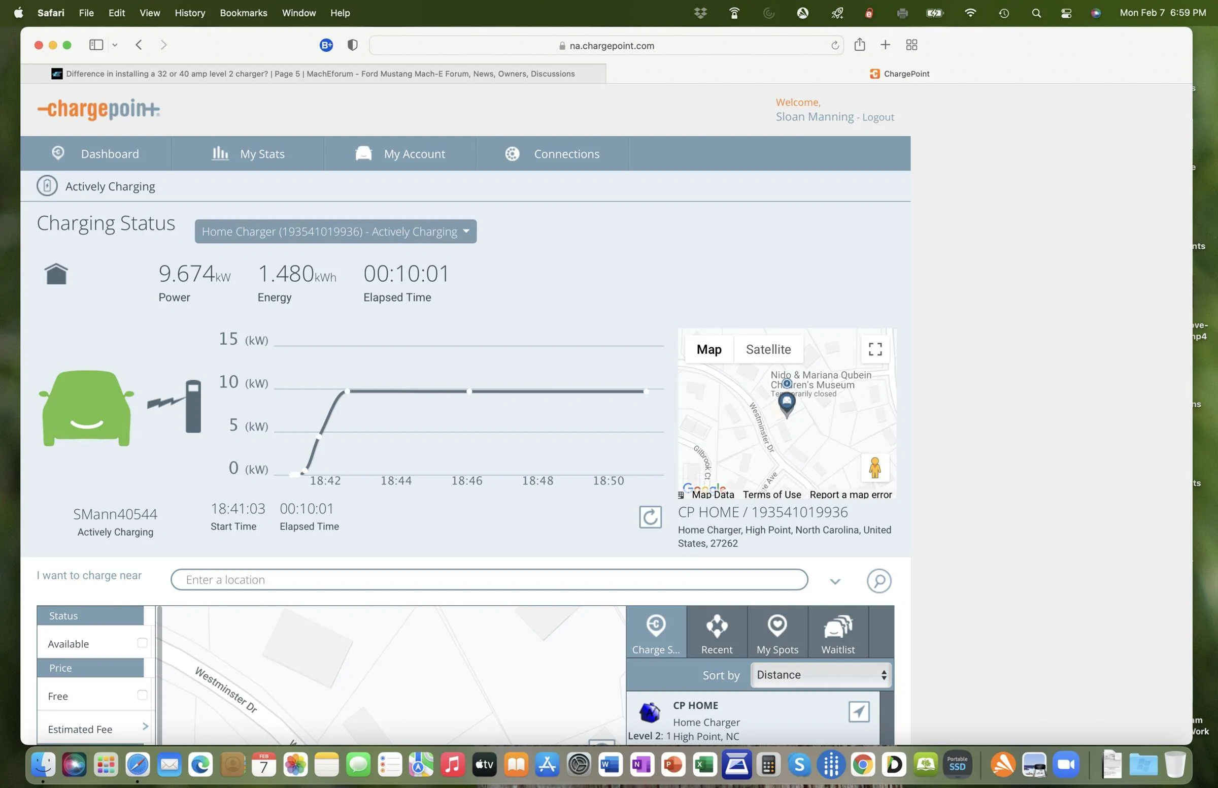

Above is my MME GT charging off of a charge point hardwired to a 50 amp circuit breaker.
V=IR, Amp=Power/Volts
This is 9.674 KW and about 44 amps at 220 Volts.
