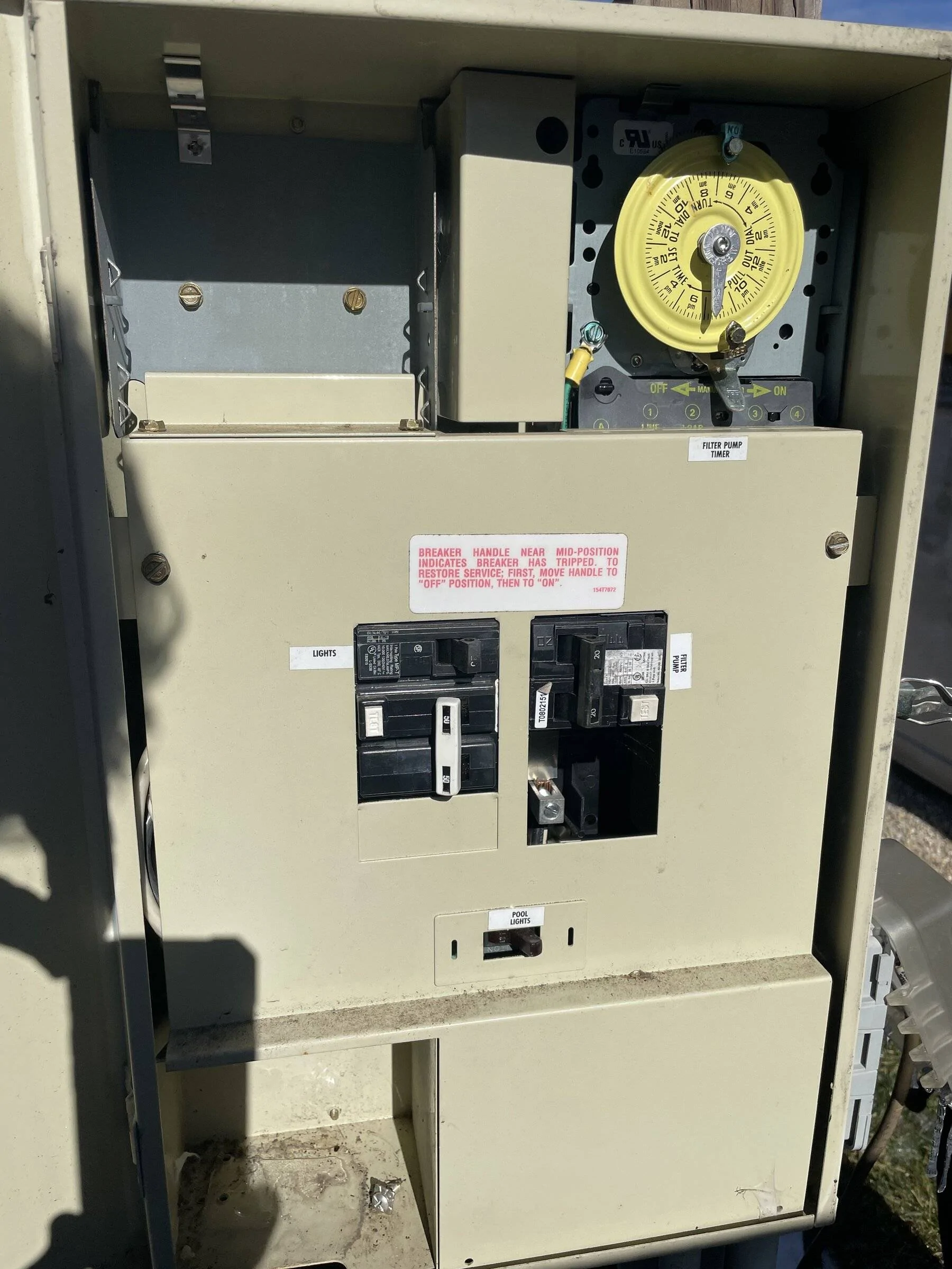

so the nema 14-50 needs a 50 amp breaker? Is that minimum? This is what I have on an exterior sub panel for my pool. You think this will be enough room?

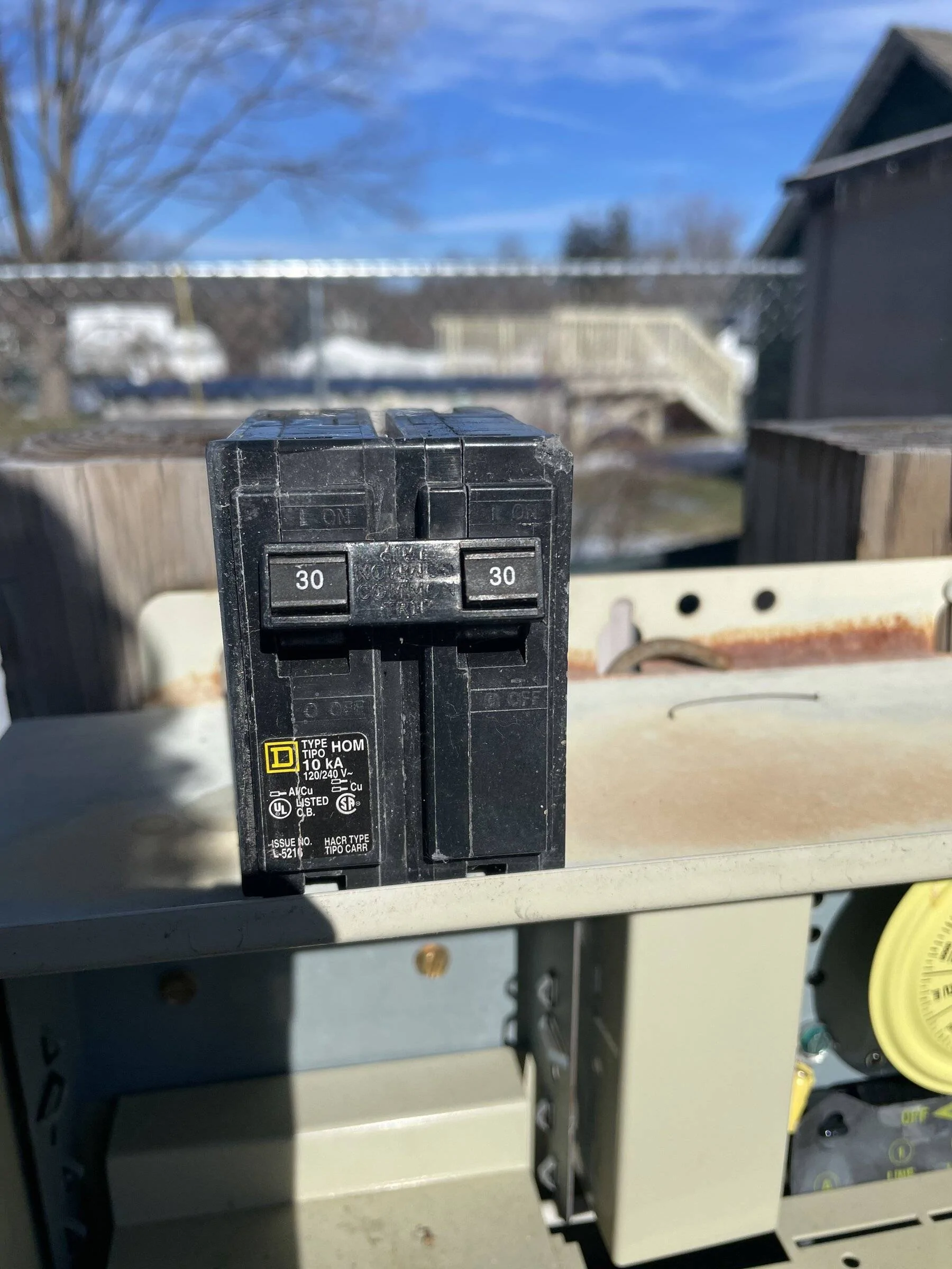

I’m not sure I have the room for a 50 amp breaker. Look at my pics I posted of my exterior sub panel. I think there is a 50 in there already but I don’t use it
you should use a 50amp breaker with a NEMA 14-50 outlet, even though the mobile charger pulls only 32amps, it pulls for HOURS, so it needs a 50amp breaker. And, the wires from the breaker to outlet should be 6AWG for the L1,L2,N and 8awg for G to meet 'best practices' and code in most places.
If you already have a 50amp, definitely use that; fine for 32amp Ford Mobile charger
and make sure the wire from breaker to NEMA 14-50 outlet is 'proper'.... #6awg for L1,L2,N, and #8 for ground
