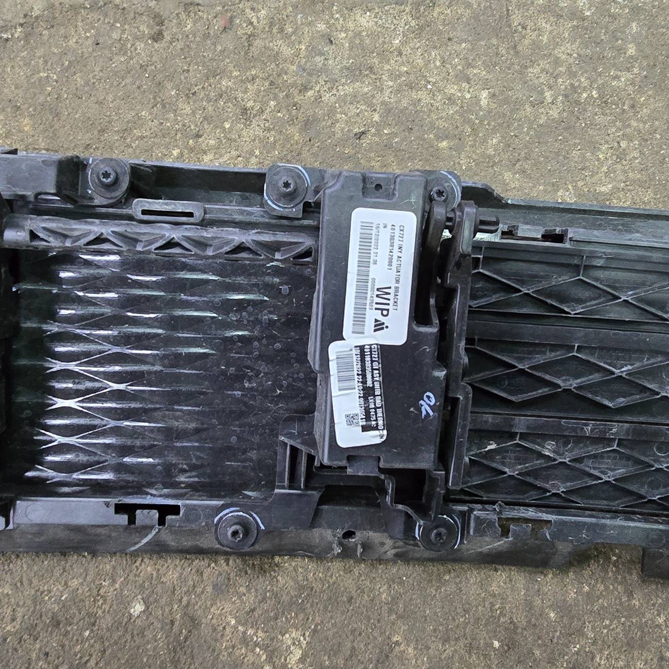

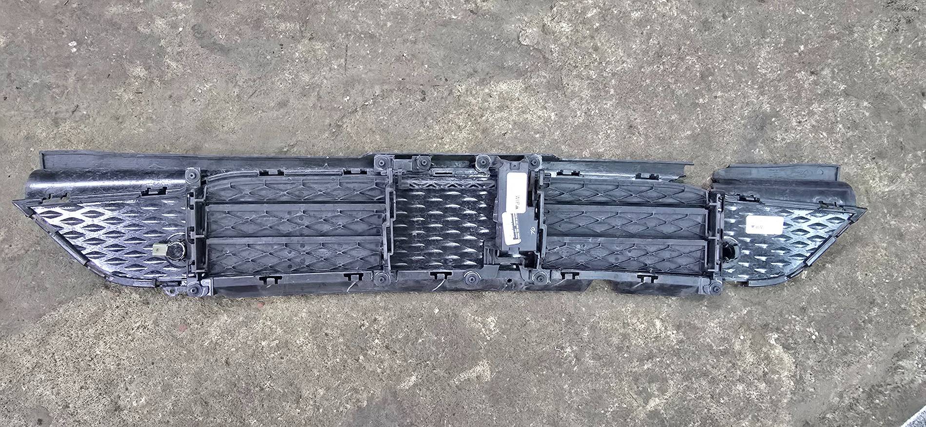

Jack up the car and remove the lower cover. The blind installation will be visible

Great, thank you.
