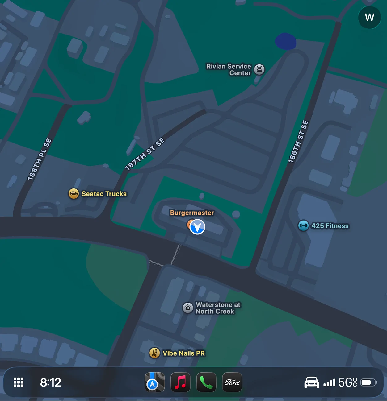

I’m sitting at a drive in and the map thinks I’m pointing the opposite direction of how I’ve parked.

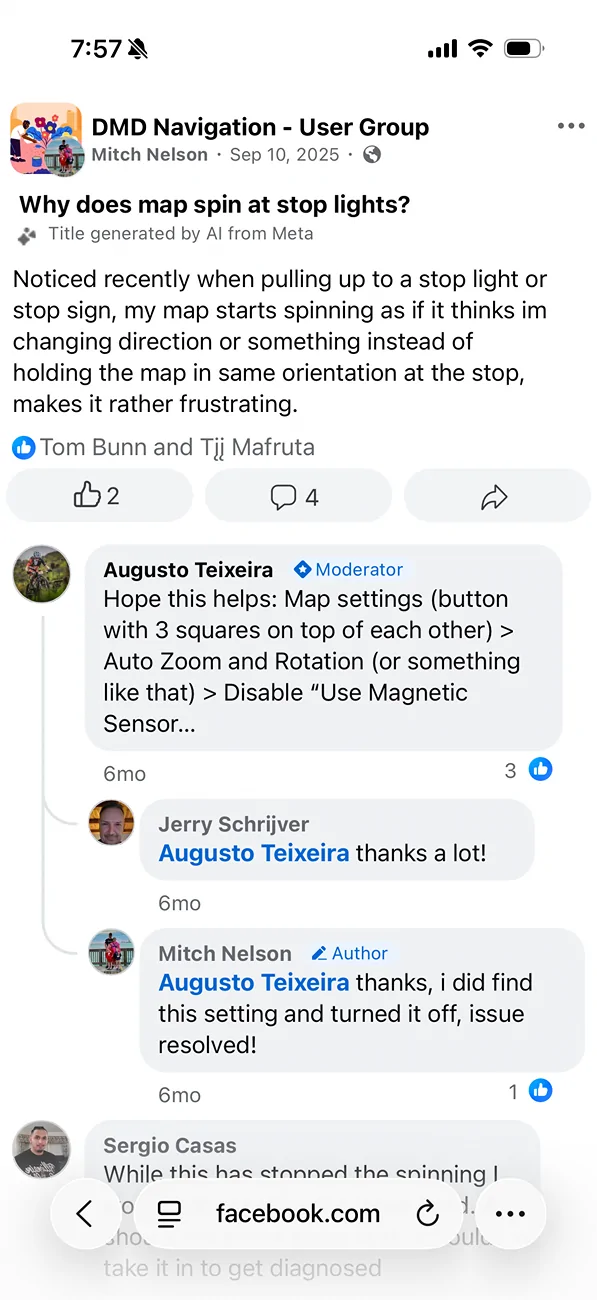

It’s a link to a Facebook post.
Here is a screenshot
I don't seem to have this setting on my Google Pixel. I have set location for Maps as "Always" which seems to lessen the issue to a degree but it still occurs.
I don’t think there is a “real” fix for this.
Your phone is extrapolating your orientation based on the last set of data it had before you came to a stop. It can get confused from time to time.
It’s easy to calculate the direction of travel when you’re moving. Not so easy when you’re standing still.
You can also try recalibrating your phone’s compass
