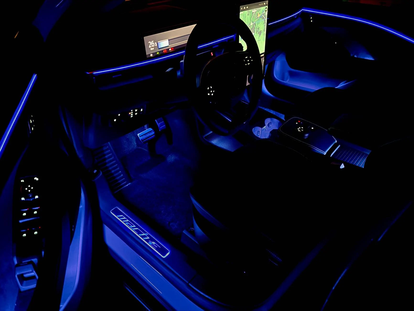

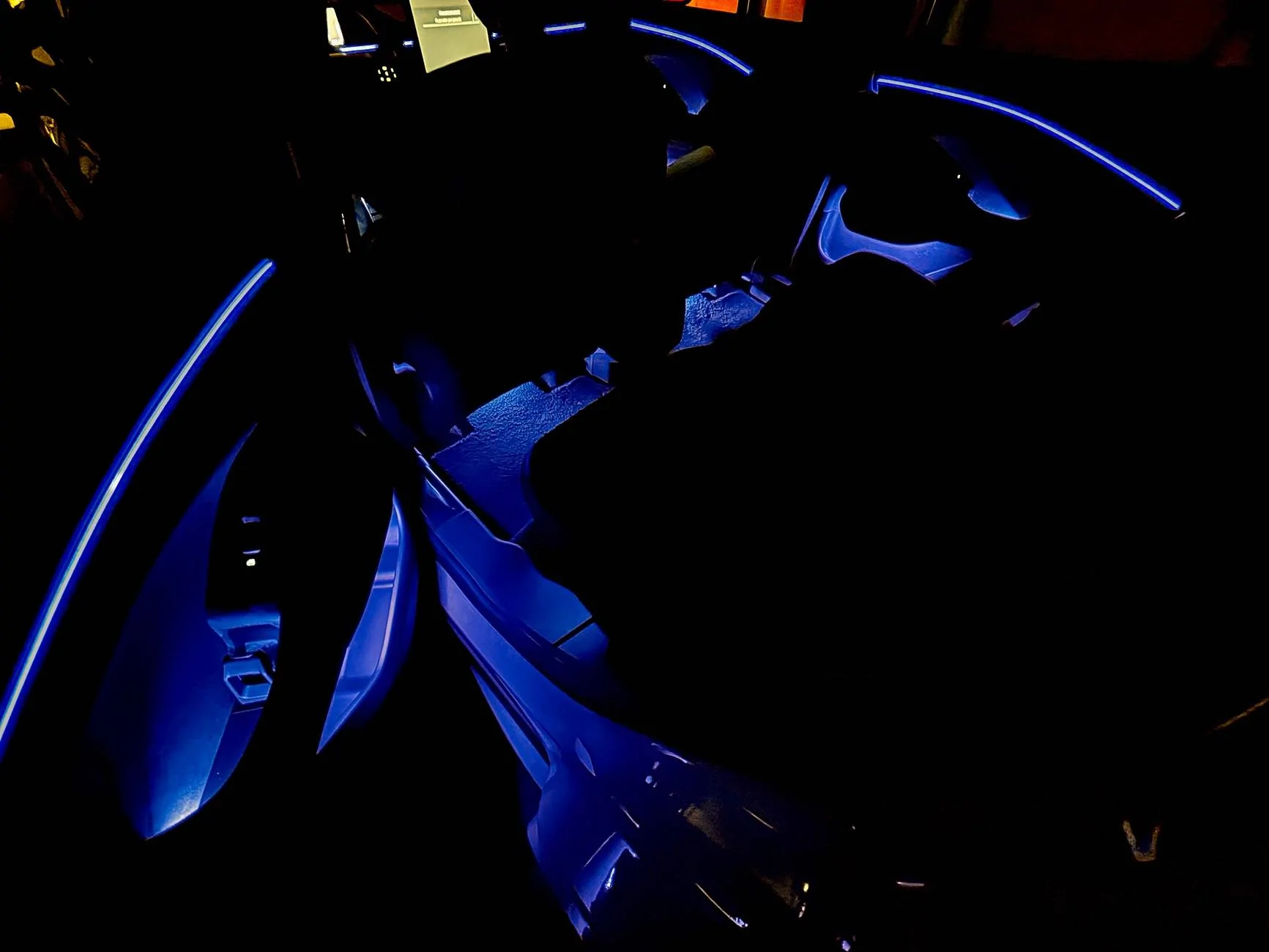

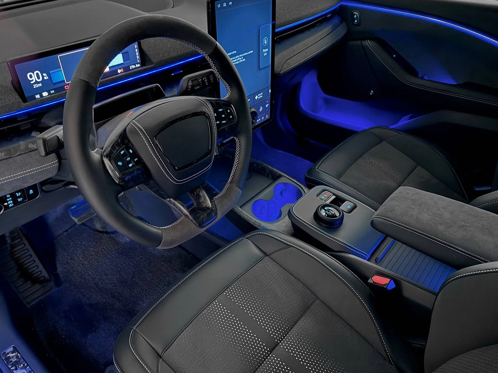

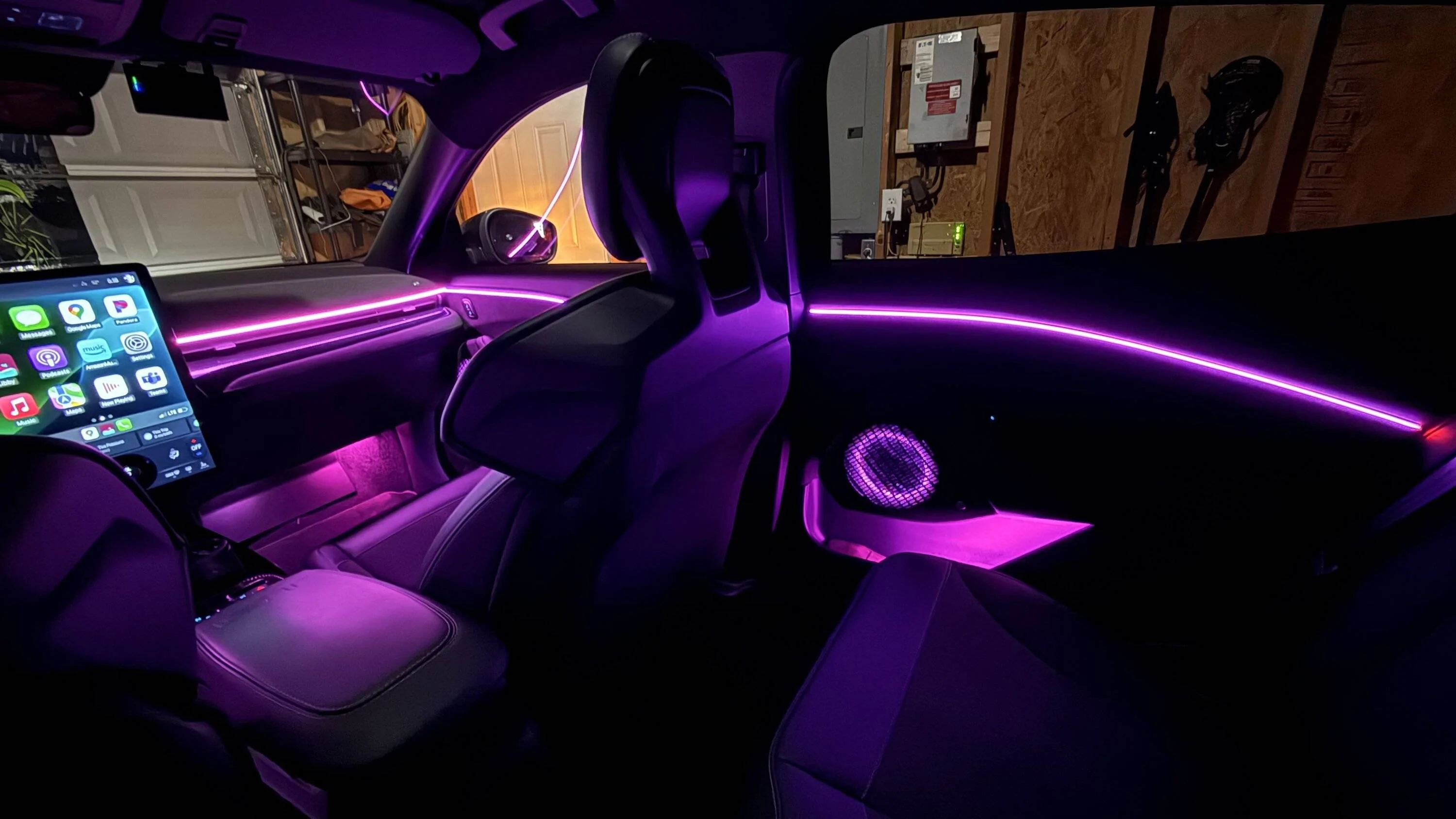

Hey Rod, I also installed their kit earlier this year. Replaced the OEM front door storage bin lighting with theirs. Added the cup holders, rear storage bins, under front seats for rear footwells, door latch handles in all four doors, glove box, etc. Only thing I didn't do were behind the speaker grills.
Best interior mod for sure not to mention working with Simon is always a pleasure.

did the EV-Vida kit come with all of that, like the cup holder lights, armrest etc? Did it it match the factory well ? Also where di you get the lit scuff plates?
I was not planning on doing the speakers. I guess I can contact them directly but does the kit come with that all of that?
Any issues matching up with the factory color or brightness?
The EV-Vida kit came with everything you see except the lighted scuff plates. In the kit are some individual LED's which I installed into the cup holders, door latch/armrest areas and glove box.
It matches the factory ambient lighting really good and brightness.
The lighted Mach-E plaques I had custom made and then customized the scuff plates for them to fit into.

Heya,
I'm working on installing the V2 of this kit on my Mach-E. So far everything is going well I have all 4 doors done, just need to do the front dash. @Murse-In-Airy @markboris do you have any tips/info on how you did the front dash in yours? The PDF guide doesn't talk much about removal and mounting other than a few (broken) links and the YouTube is the V1 installation and doesn't show any of it. That location is exactly how I want mine mounted on the front dash. Thanks!

Hey Stevo, I probably did it the hard way but removed that gray cloth dash trim that covers the tweeters, modified it a bit on the underside to fit the LED strips and then hot glued them on. Personally, I would hit up Simon (SimonT) to see how he does it when he installs his kits.

And I went the easy route and started the wires out be the edge against the doors, using some high test 3M double sided tape to hold the LED strip up where I wanted it.
