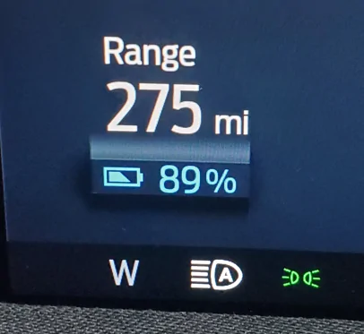

Since we are on the subject....
Like many others here, I normally charge to 90% overnight and only because the owners manual recommends that practice when possible. For me, this is totally possible as 90% still covers almost all my daily needs regarding range. Well, now it does. During the summer I was suffering a bit. This is because my range dropped so low during the summer months because I was remote starting my car throughout the day so the car would condition the battery and the cabin.
Here is a screen shot from June 2nd. Estimated range at 90% charge is 248 miles. Which is pretty close because I remote start the car off plug throughout the day and actually leave the car running while at job sites or running errands.
Ford Mustang Mach-E Another GOM Lie 1634750117834
Then in July, @macchiaz-o discovered a work around to allow the car to condition the battery while parked on plug. I started employing that method sometime in mid July if I remember correctly. So, by early August (8-10-21), all my range returned. I suspect this is because the car didn't have to cool an overheated battery every time I took it out for a drive. By cooling the battery on plug, I was able to use more of my stored energy to move the car vs cooling the battery.
Ford Mustang Mach-E Another GOM Lie 1634750447937
This continued all the way through Aug, Sept and into early October.
  • Aug 11th, estimated 281 miles @ 90%
  • Aug 18th, estimated 272 miles @ 90%
  • Sept 28th, estimated 284 miles @ 90%
  • Sept 30th, estimated 291 miles @ 90%
  • Oct 7th, estimated 275 miles @ 90%
Now it is getting much cooler in the mornings and I have been using the heated seats and steering wheel on my drive to the office. No E-Heat yet. IF cabin pre-conditioning continues to function then I may not need E-Heat very often. Yesterday I saw the estimated range dip to 269 @ 90%. Today it dropped again down to 263 estimated miles @ 90%. I expect this to continue as winter sets in.

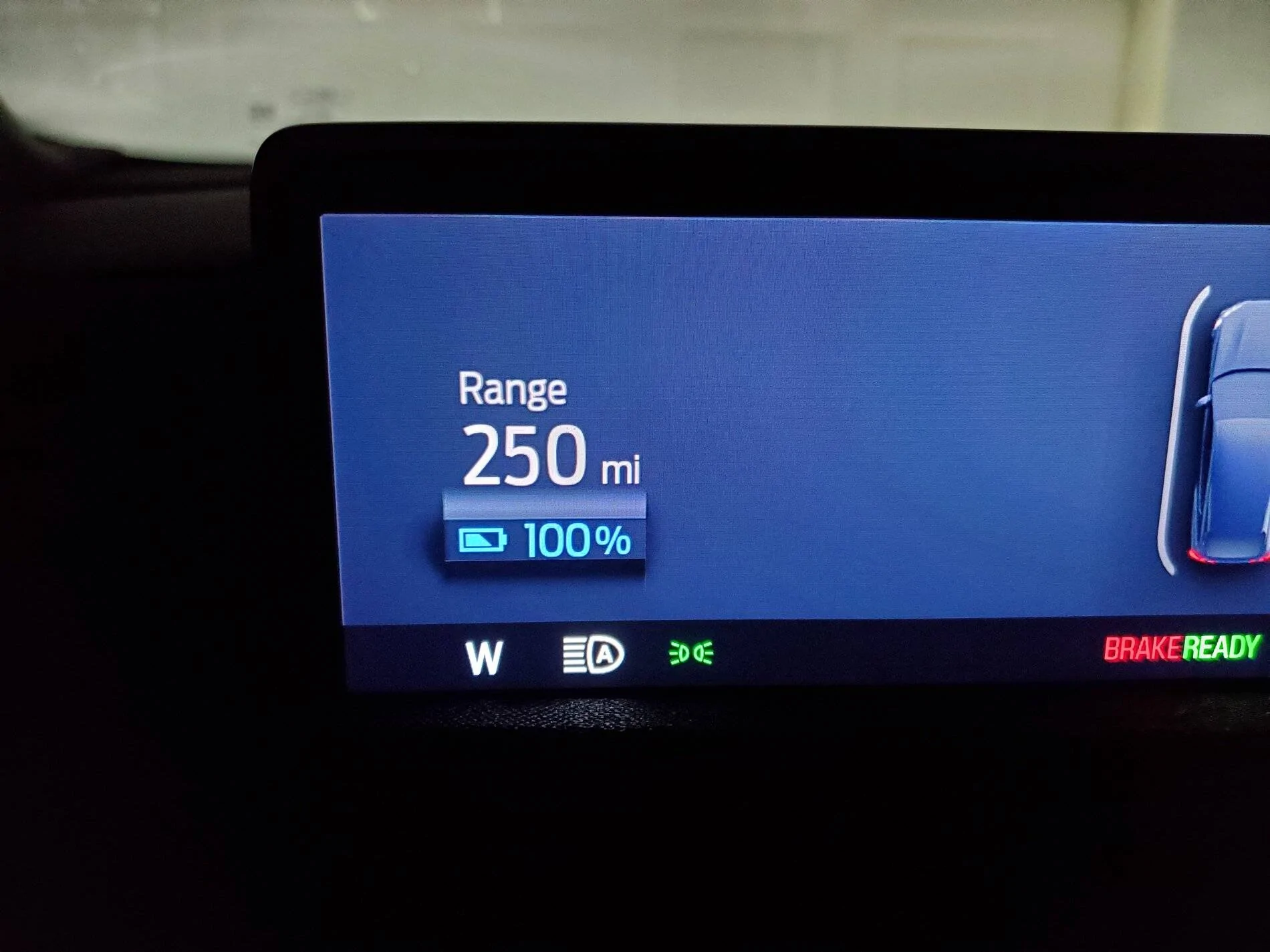

For some vehicles yes. For some others, it's very accurate.
Here is what my estimated range was the day after I returned from a road trip to San Diego.
I manually calculated my real life range while road tripping at 250 miles on a full charge and the GOM came up with the same number. In my car, it's really pretty close estimation.
Ford Mustang Mach-E Another GOM Lie 20210908_053658
