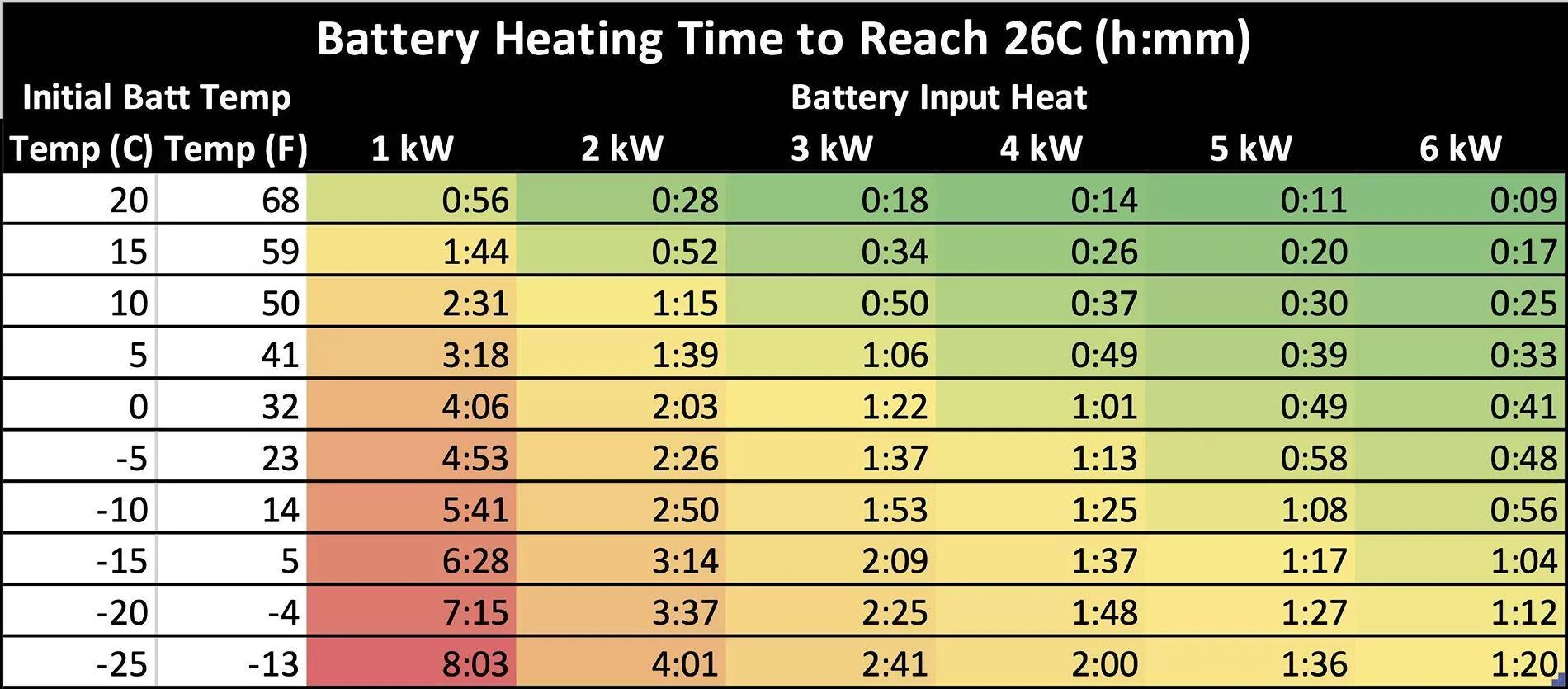

car is outside, but again, haven't had an issue all winter till now..... i understand by the above graph that it takes a few hours to condition at my charge setting... but thats like 2.5-3hrs tops, not 10hrs
Agree. Do you have an OBD2 scanner that can work with Car Scanner? That should give you some insight into where the power is going.
Do you have a way to monitor the power over time to see if it is a constant 20 amp draw? I see 2-3 spikes when it is cold while the car keeps the battery warm but I'm only -12-15°C here and I don't have a departure time set. I suspect it would be additional longer spikes of power if it were -30°C with a departure time set.
