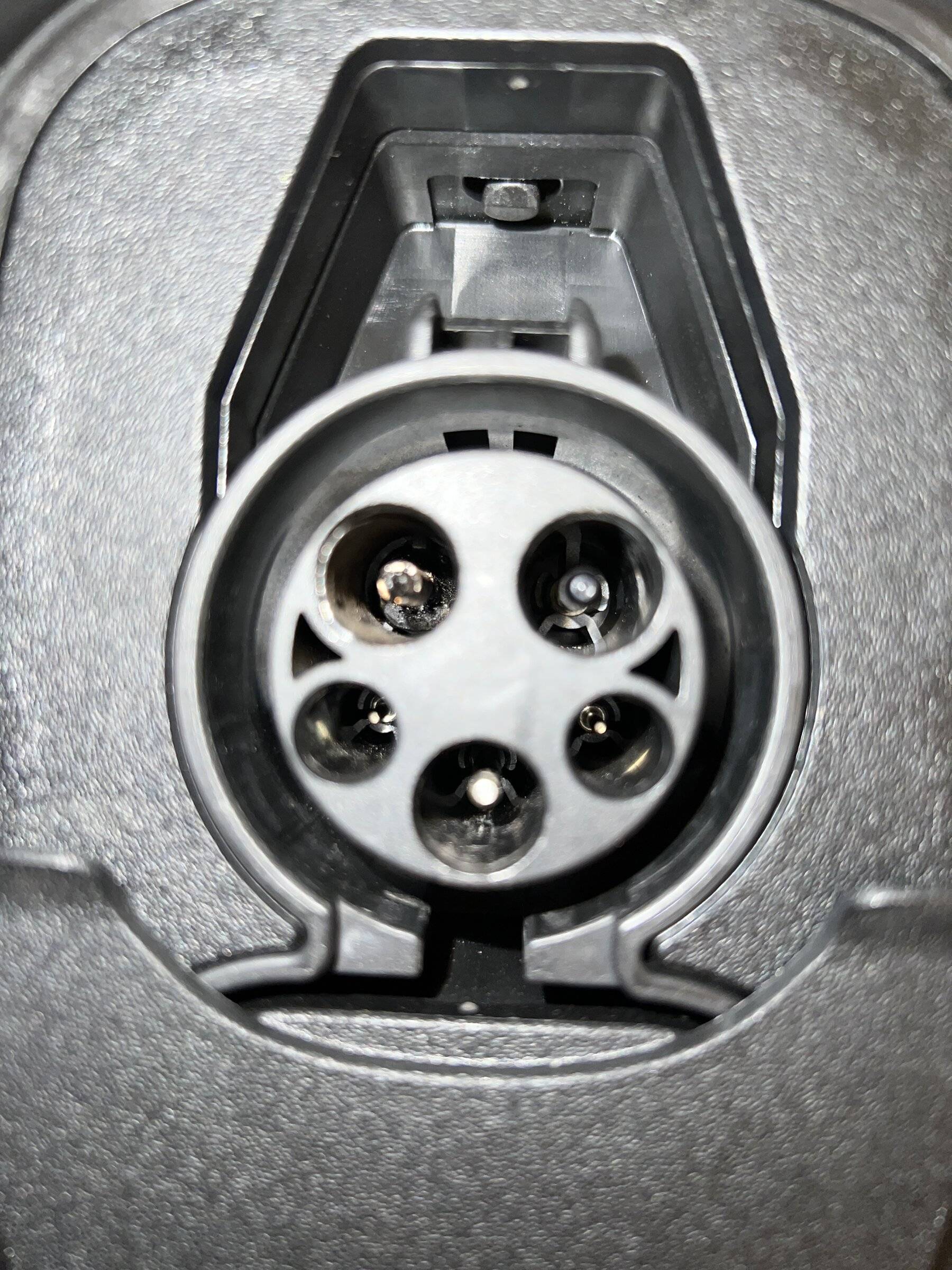

Anyone else experience a burnt/melted charging port?
JamieGeek
Dec 29, 2019
82
3,589
6,823
Southeastern Michigan
spareelectrons.wordpress.com
Dirty/worn contacts causing arcing at perhaps thousands of degrees.
At public chargers it's not a bad idea to have a look at the business end before hooking up.
No arcing is necessary to cause the melting, just a very small contact area forcing all the current to go through that point.

a poor connection between pin and socket probably started the arcing.... either incomplete connection, or a bent/worn pin or socket.
Since your end was new.... likely to be a worn plug on the public charger... and should be reported for maintenance.
1. visually check plug and socket for debris, water, or signs of previous arcing... especially at public chargers!
2. be sure to fully engage plug until you hear the click... especially if you are using an adaptor!
3. consider putting a TINY dab of (conductive) grease, vasaline or WD-40 in sockets occasionally to prevent wear and assure good contact, especially if charging outside. WD-40 is 'water-displacement formula 40', and not a lubricant... so grease is better.

The worst cases were the ones where the connector fused and the handle could not be removed.
Now that is a nightmare scenario.
Rolled up to a charger once in my Volt to find a Tesla adapter just about welded into the coupler. It put up a good fight, but eventually it separated. In retrospect, I probably should not have used that charger.
