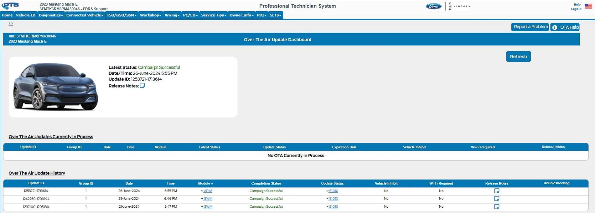

Just checked his config for BC on the APIM and IPMA and it looks perfectly in-line for his version of BC. His car is not reporting any codes that it wasn't reporting before the update.
Yes, stranger things have happened. In your case, whatever is causing BC not to work is not obvious. Not to me, anyway. OTA history shows you got 3 updates in a week: 24.2.4.9, 24.2.4.9.1 and then 6.14 a week ago.
Ford Mustang Mach-E Anyone else have issues with update 6.14.0? 1719954781478-d3
