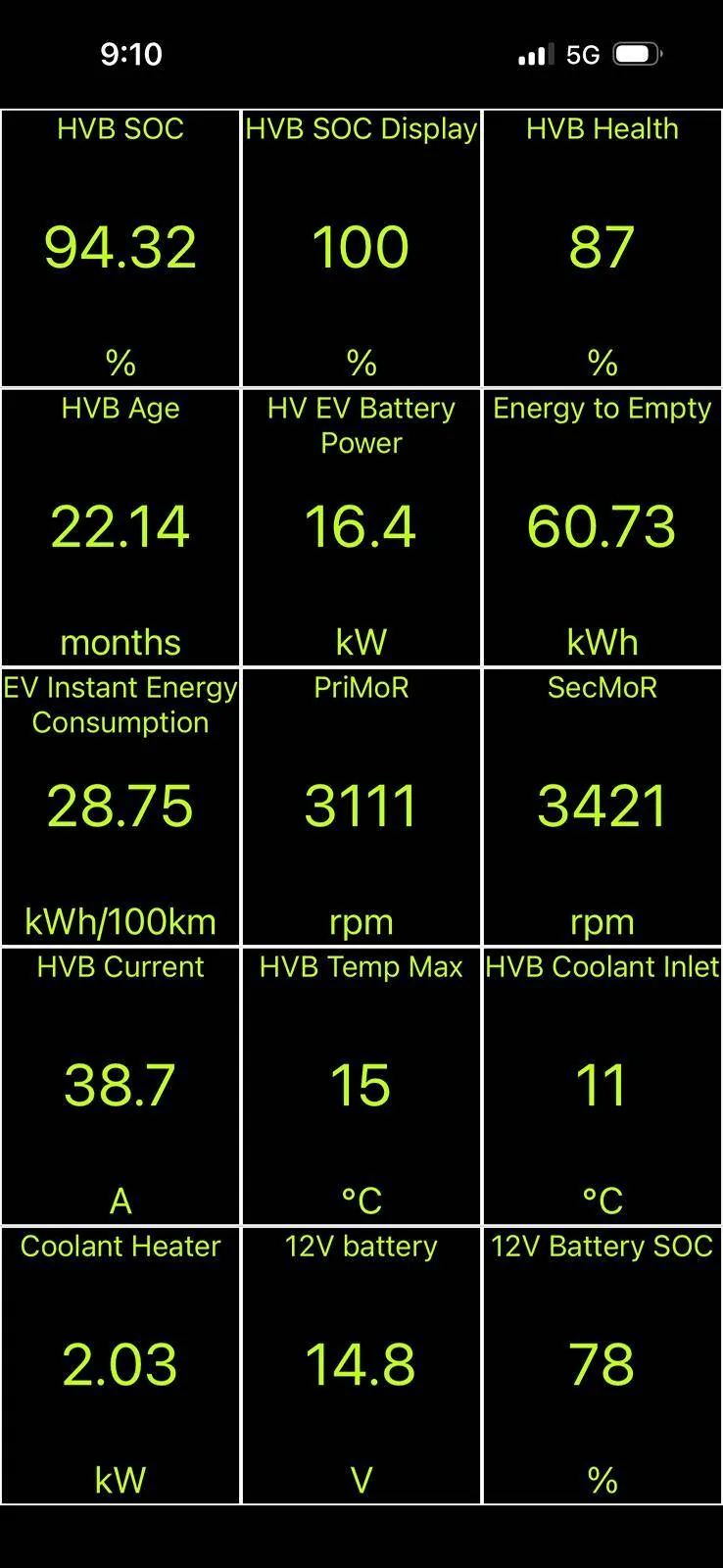

I did the first few steps and charged to 100. My energy to empty went up from 62kwh to 66kwh but the SoH is staying the same.

Sorry for the ignorance, but what is the max available capacity of your battery new? And if you divide 62 by that number, what is your real SoH?

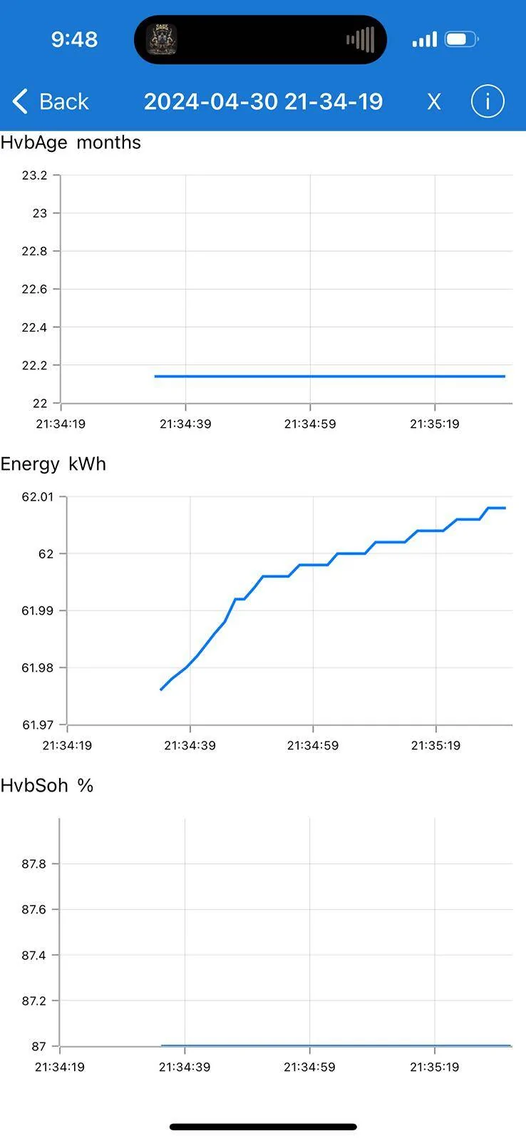

what made me nervous is once a month I check the battery stats with car scanner and I noticed a 10% drop in health in one month. So that’s why I got worried.

The sudden drop was due to a software update that changed how and when SoH was calculated. There was not sudden battery degradation. Performing the calibration several times should help the reading be as accurate as it can be.

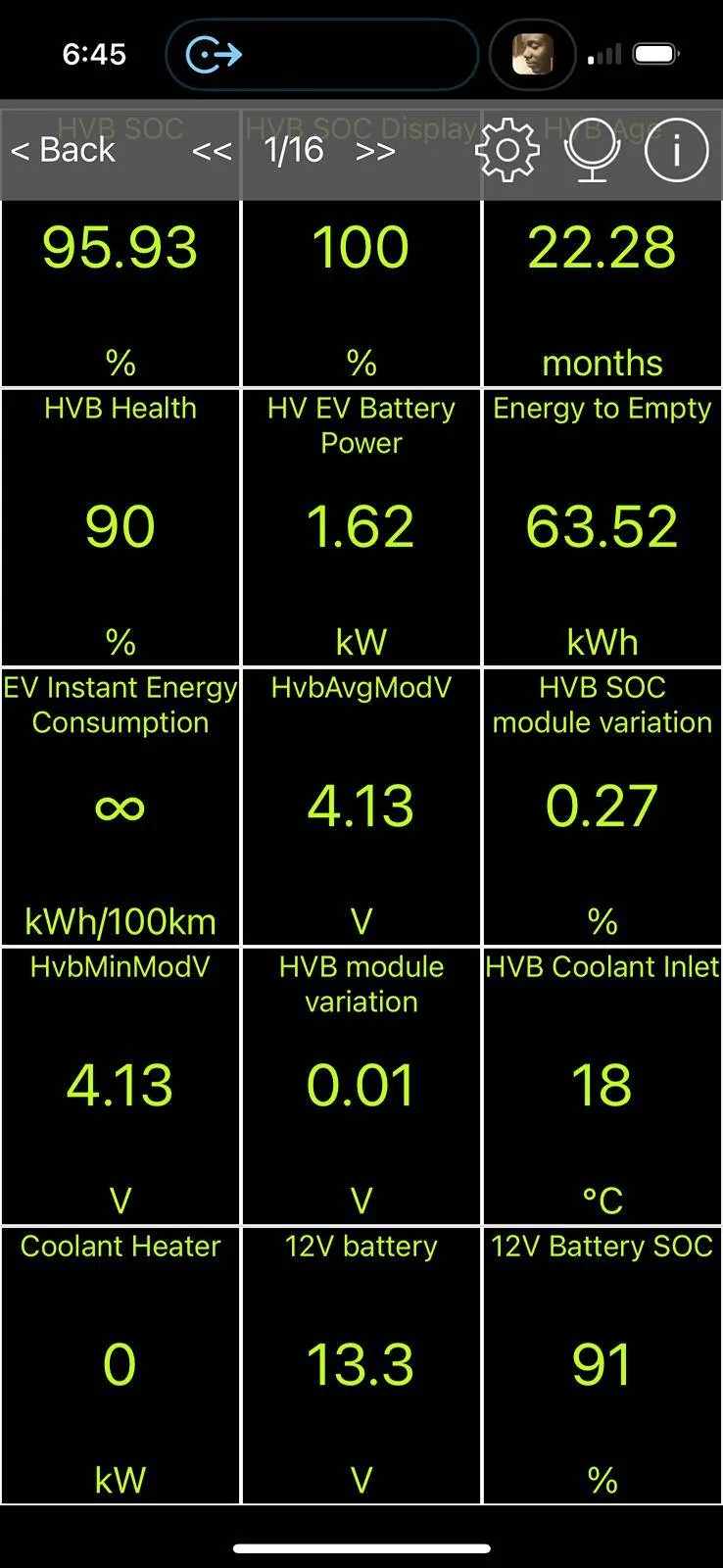

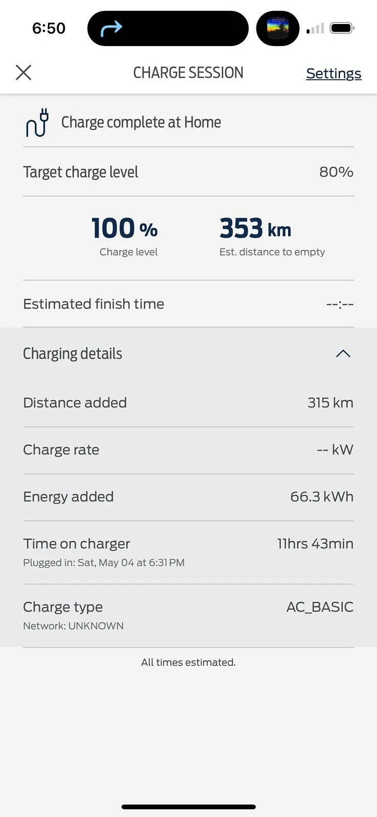

So after completing two rounds of the procedure @Mach-Lee mentioned my SoH improved to 90%. I still think it’s a little low compared to the average. One thing I found interesting was that the ford pass app range was wildly off from what was in the car. Almost a 30km difference. Also the energy added was larger than my energy to empty. I am wondering if that is excess energy to warm the battery as preconditioning was off.

Actually 90% isn't unreasonable for the age and mileage on your car. It is on the low side, but that is how it works. Some get better SoH, some get worse. You don't need to worry about it, IMO.
