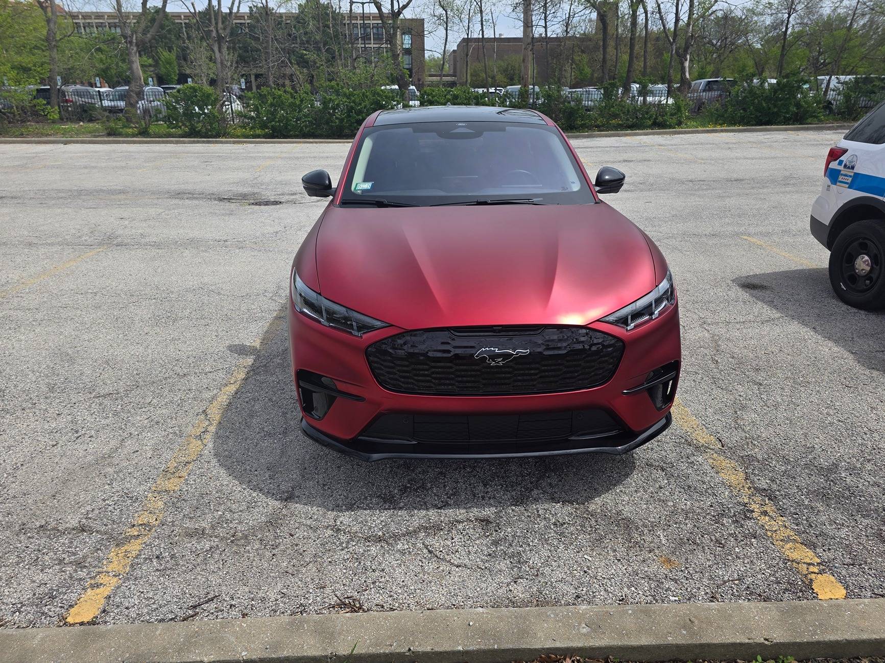

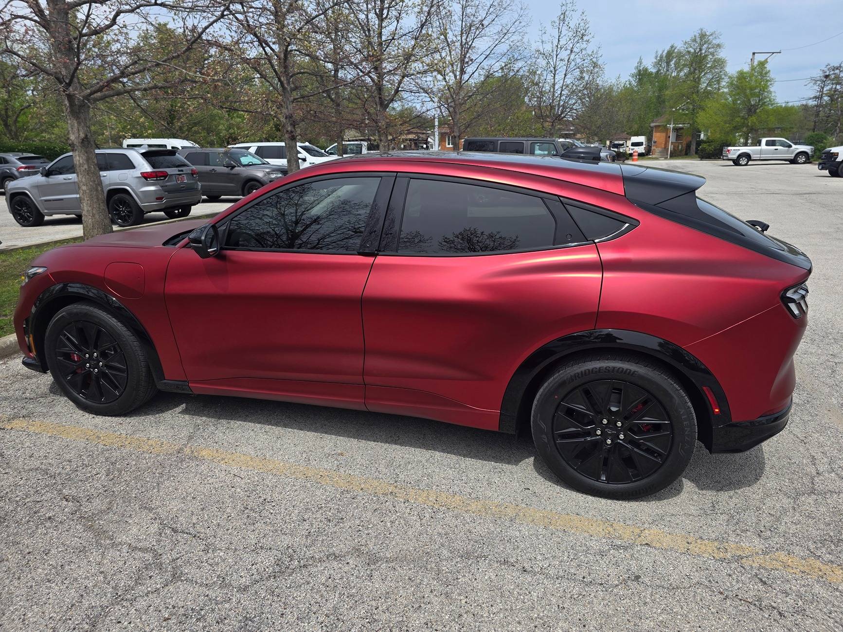

It looks nice ? I'm thinking about a blue mat ? seeing the photos now I understand your doubts about the parking sensors. You can't really see them ? Do you have versions without sensors or did they cover them up when wrapping the car?
I think they just covered them however they still work just fine.

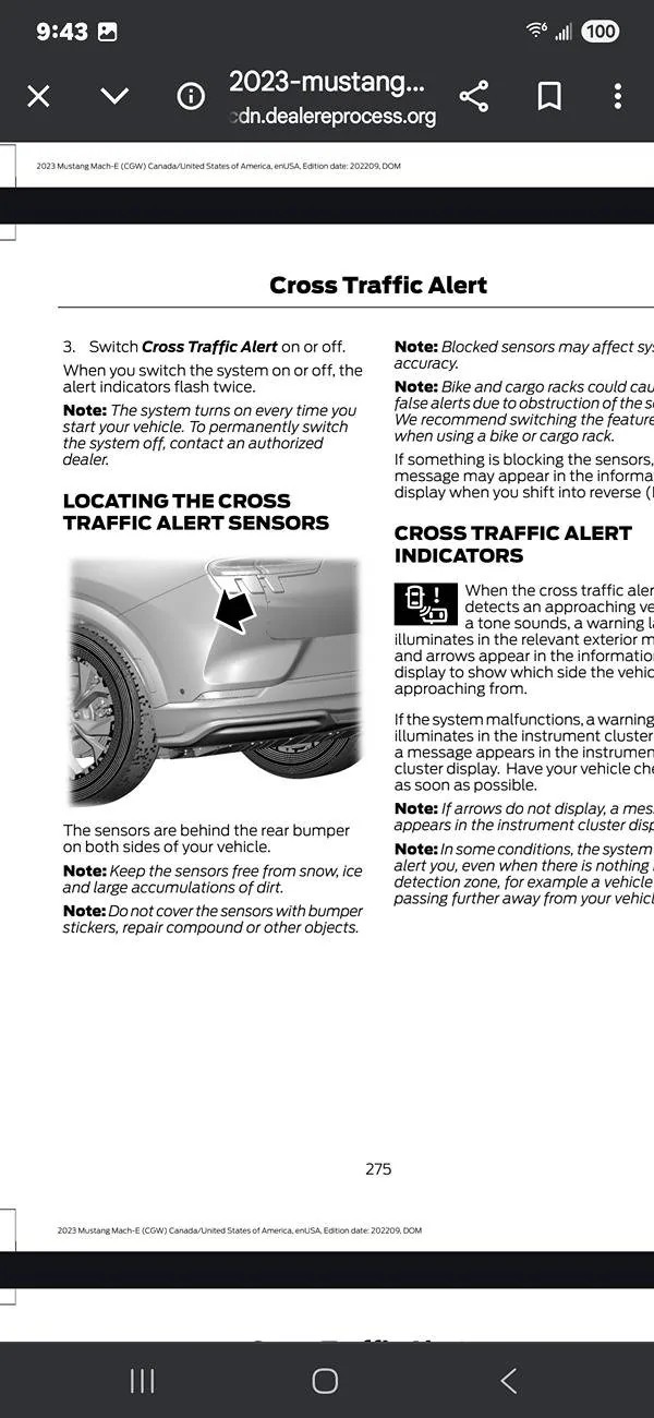

Anyone have issues with their blind spot sensors after wrapping their car? I just got it back today and keep getting the sensor error every time I drive. Doesn't look like any sensors are covered on the bumper.
What is the wrap made out of? If there is any metal content, it may interfere with the radar signal. Chrome, mirror, brushed metal, carbon fiber, metallic flake or color-shift / iridescent wraps may interfere with radar.
If there is metal content, the wrap will need to be removed.
