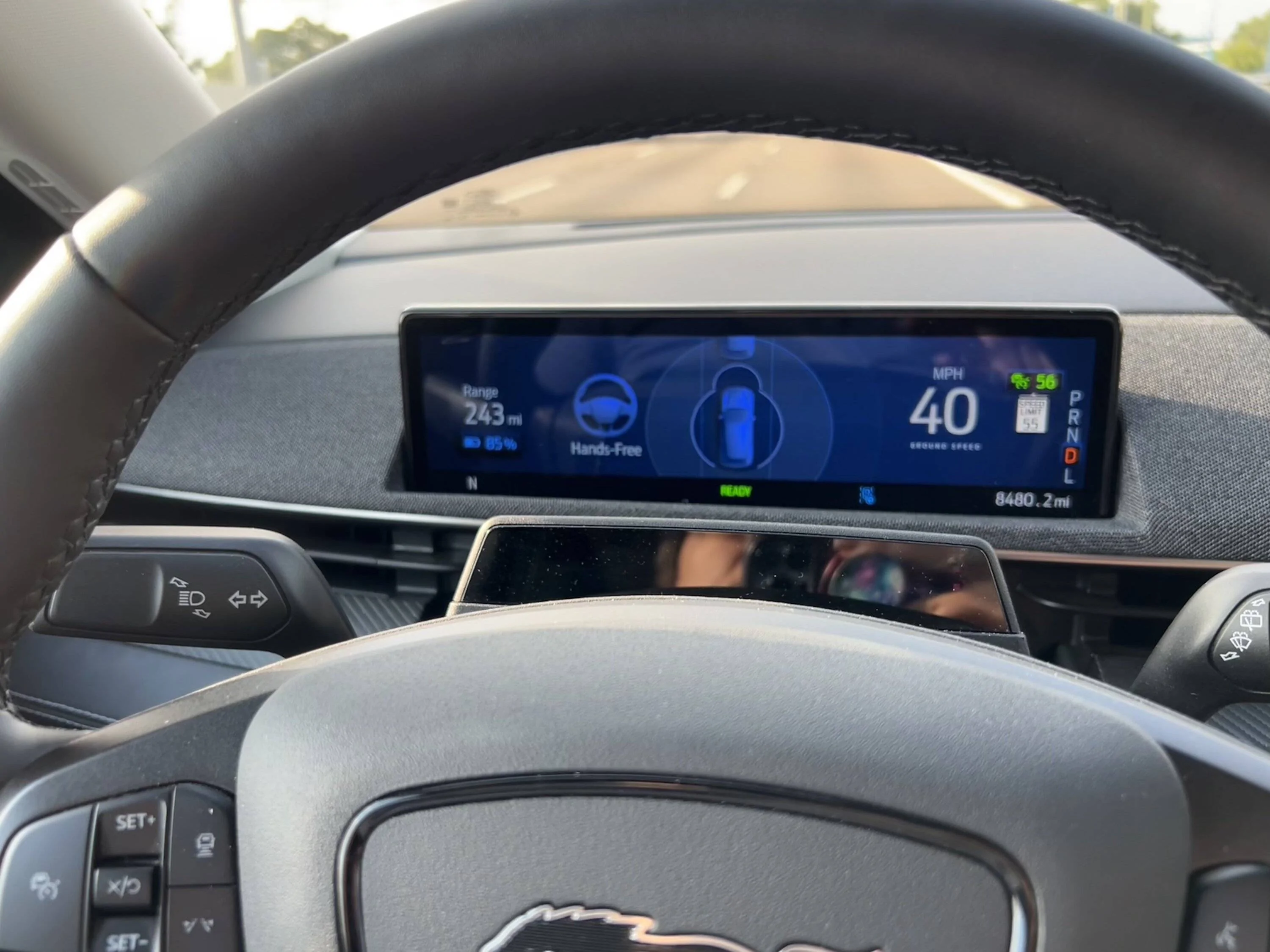

I just tried it out cause I got it OTA last week, and it worked really great on US-19 heading to Clearwater, didn’t notice the ping ponging.
