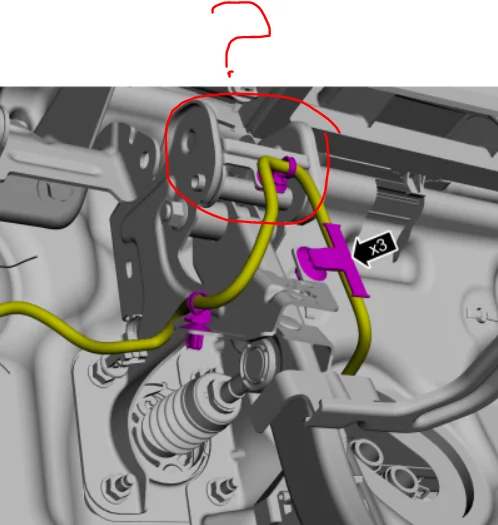

I'm guessing the brakes on the Mach-E work similarly to Ford's other cars with plugs. Probably very close to what the Focus Electric did which is described here:
SnBGC
Greg
Apr 20, 2020
46
5,962
9,778
Phoenix
Manager

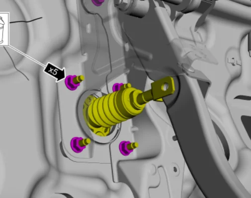

I think it's very similar still but perhaps a next generation design.
I don't see the elastomer spring so maybe they are using a torsion rod instead? Possibly up towards the pivot point of the pedal assembly?
Ford Mustang Mach-E Brake pedal input and regenerative braking 1629333088022
There still is a push rod though. So, whoever said the system was 100% brake-by-wire isn't totally correct. Was that Sandy Munro?
Ford Mustang Mach-E Brake pedal input and regenerative braking 1629333222207

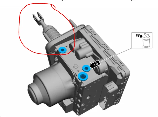

Looks like an electrically boosted master cylinder (vs vacuum boost in gasoline vehicles or hydro boost in diesels...)
I don't think total brake by wire would meet FMVSS. Many vehicles with ADAS use braking systems similar to this. Minus the regen braking of course.
11,379
25,066
I don't think there's a spring external to the HCU. There might be one on the input pushrod or internally. No brake-by-wire, more like indirect hydraulic with mechanical backup.
That makes sense and would be a good place to put the spring......inside the HCU.
