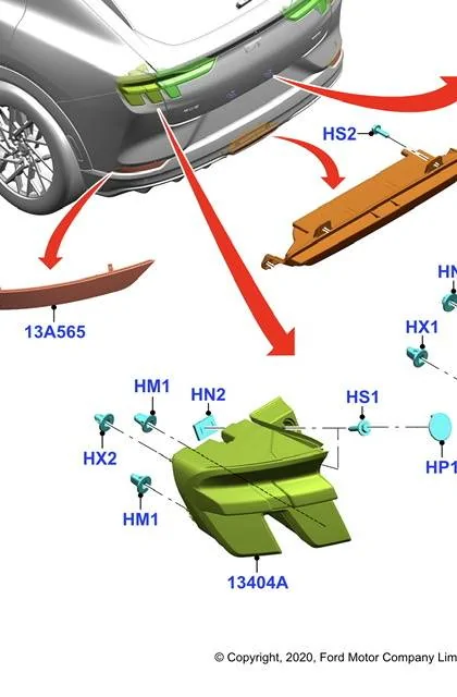

Did you have instructions on how to replace? I had a similar issue (wife met a mailbox and the light took damage), and I've ordered a replacement from EBay. But after taking off the 2 screws, I was unsure if I need to get to the back of the tail light by taking off panels in the trunk, or if there's some other way? Any help would be appreciated!

I replaced the taillight this past weekend and was also unsure how to proceed after removing the two side screws. After a few minutes wiggling and pulling, the light popped out. It's held in via four socket mounts (for lack of a better term) - here's a pic of the left side (the two rightmost holes are where the screws go).
Ford Mustang Mach-E Broken Rear Tail Light IMG_7302
Not sure how the light was damaged in the first place. My best guess is an errant shopping cart, as there was no other damage except directly to the light. Also found the replacement on eBay; the replacement was from a 2021 but it fit and works perfectly on my 2022.

I need to remove mine...
So it's just the 2 screws ?
It looks like from the picture other than those screws that the light then just pulls out of those location holes? I take it there are posts on the back of the light?
Have I got this pretty much right.

Yeah, there are some posts on the back of the light.
Remove the two screws, and then pull while wiggling. It took me awhile but it eventually popped out. There's probably a better way to do this but I didn't come across any other instructions.
