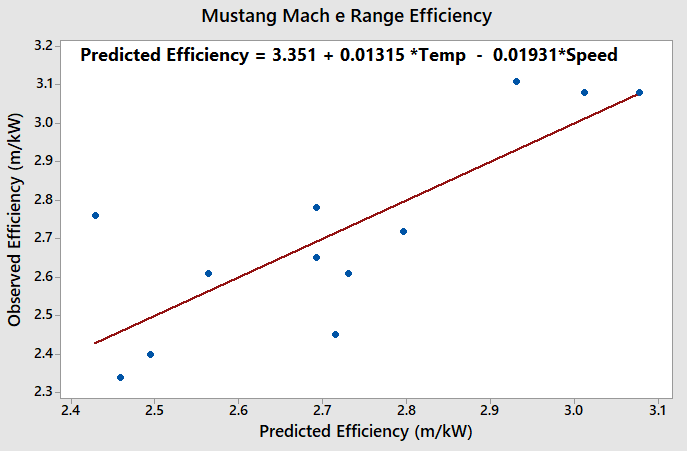

A recent post of a road trip report included a log of their observed efficiency (miles/kW) with the average temperature and average speeds seen during a stint of travel. I put their data into a multiple linear regression analysis to come up with an equation that will give a Predicted Battery Efficiency (miles/kW) vs Temperature and Speed as shown in the chart pasted below. This is only one small data set. A better model can be generated with more data. If others have data like this they can share I can add that to the database and update the results. This will give us all a better idea of the impacts of temperature and speed on range. From this initial data set for every 1 Deg F increase in temperature the efficiency goes up by 0.01315 miles/kW. For every 1 mph increase in speed the efficiency goes down by 0.01931 miles/kW.
Send me your data please!

I think the end result won't be useful, because there are a whole bunch of factors you're not including:
- Weight -4 passengers and luggage vs. 1 driver
- Altitude
- Wind
- Rain
Etc.

We can never capture all the variables but temperature and speed are by far the 2 largest. I personally will find it useful.

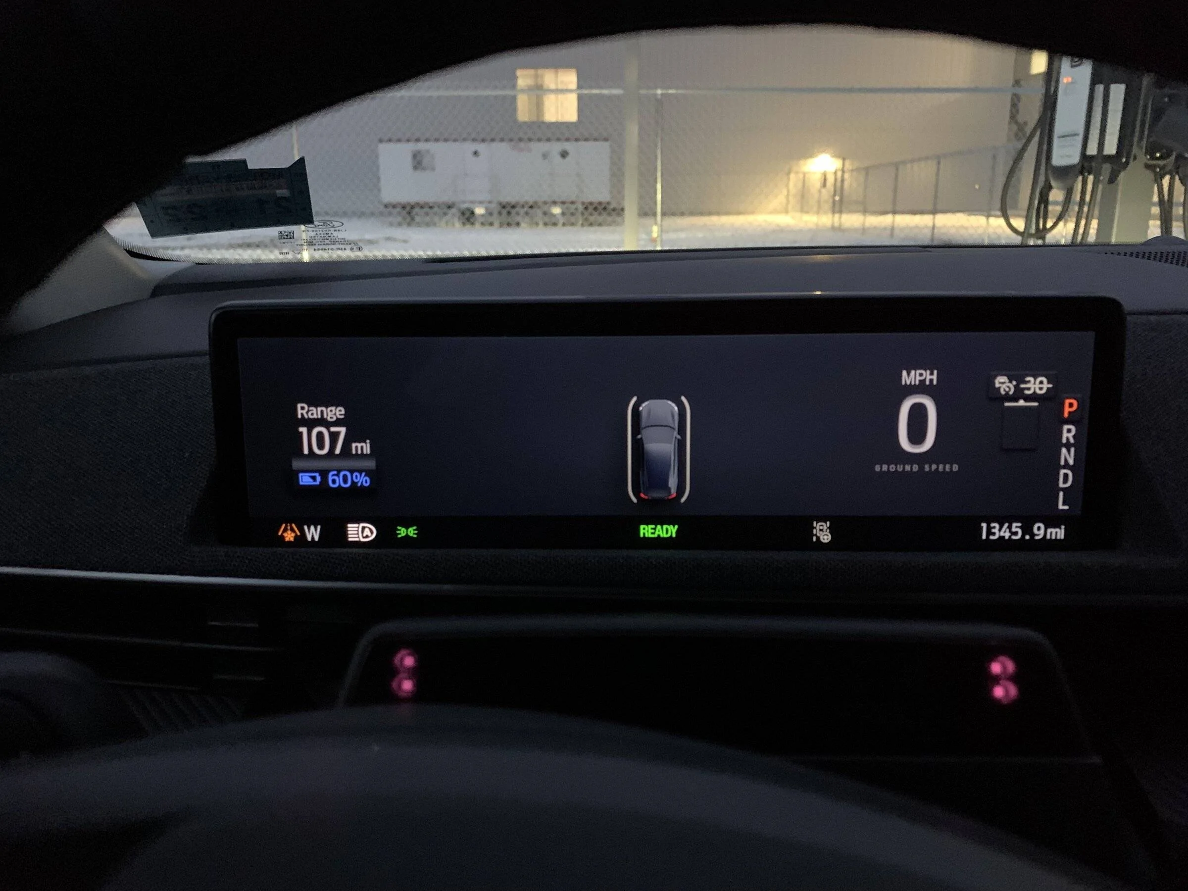

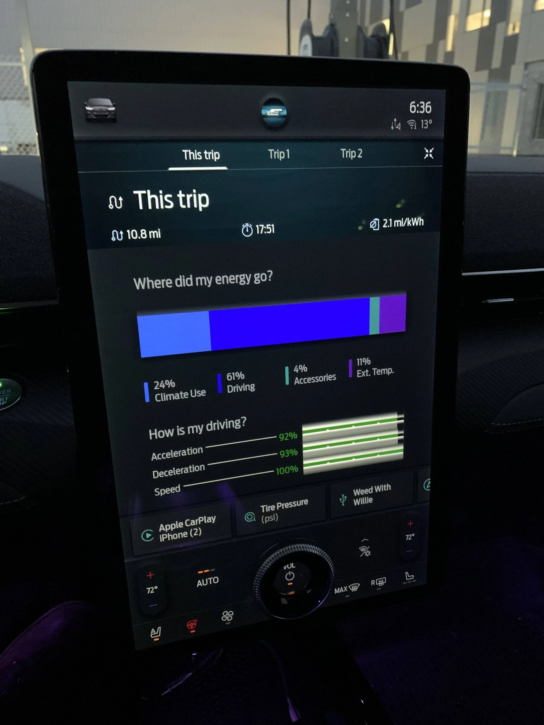

Today’s commute 12/10/21
Model. AWD ER
Preconditioned? Yes
Ambient Temperature Start of Trip 14F
Ambient Temperature End of Trip 13F
Continuous or broken (multi Leg) trip continuous
Climate mode auto-2
Climate temp setpoint 72
# of Passengers 1
(I suggest we ignore seats and wheel settings)
Fan speed auto
Miles start 0
Miles End 10.8
Time Start 0
Time End 17M 51S
Average speed calc. 36.3 MPG
Battery % Start. 66%
Battery % End. 60%
Vehicle Display Mi/kWh reset before trip? Y
Vehicle Display Mi/kWh after trip 2.1
CALC’d mi/kWh. 2.05
Fair weather, Rain, Snow Fair

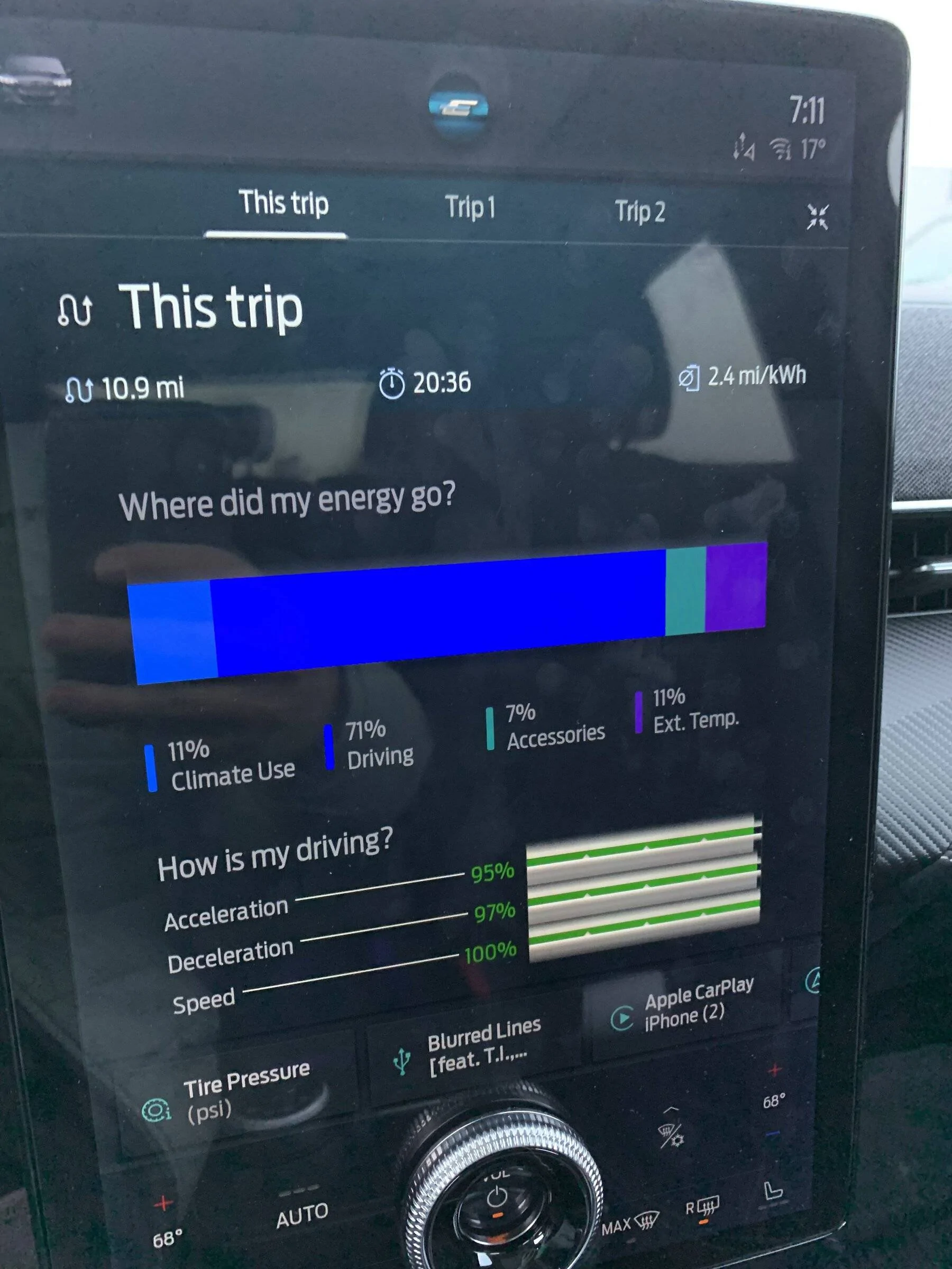

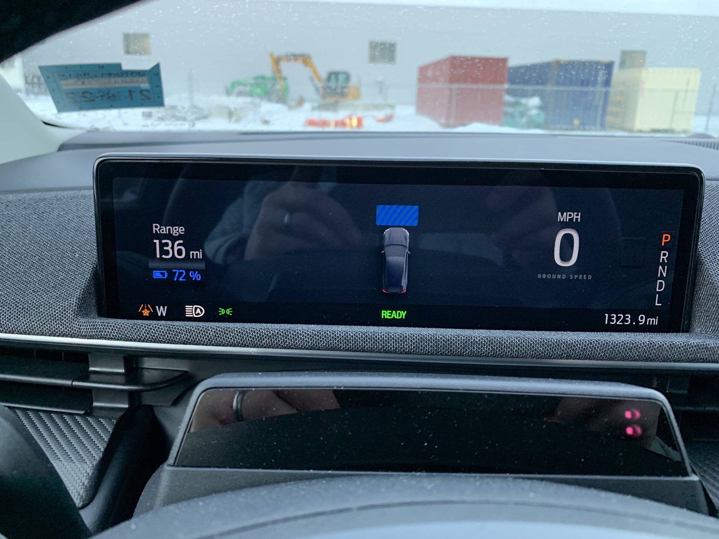

Yesterday’s commute 12/9/21
Model. AWD ER
Preconditioned? Yes
Ambient Temperature Start of Trip 24F
Ambient Temperature End of Trip 17F
Climate mode Manual defrost and lower vents
Climate temp setpoint 68
# of Passengers 1
Fan speed 2
Miles start 0
Miles End 10.9
Time Start 0
Time End 20M 36S
Average speed calc. 31.5MPH
Battery % Start. 77%
Battery % End. 72%
Vehicle Display Mi/kWh after trip 2.4
CALC’d mi/kWh. 2.47
Fair weather, Rain, Snow SNOW
