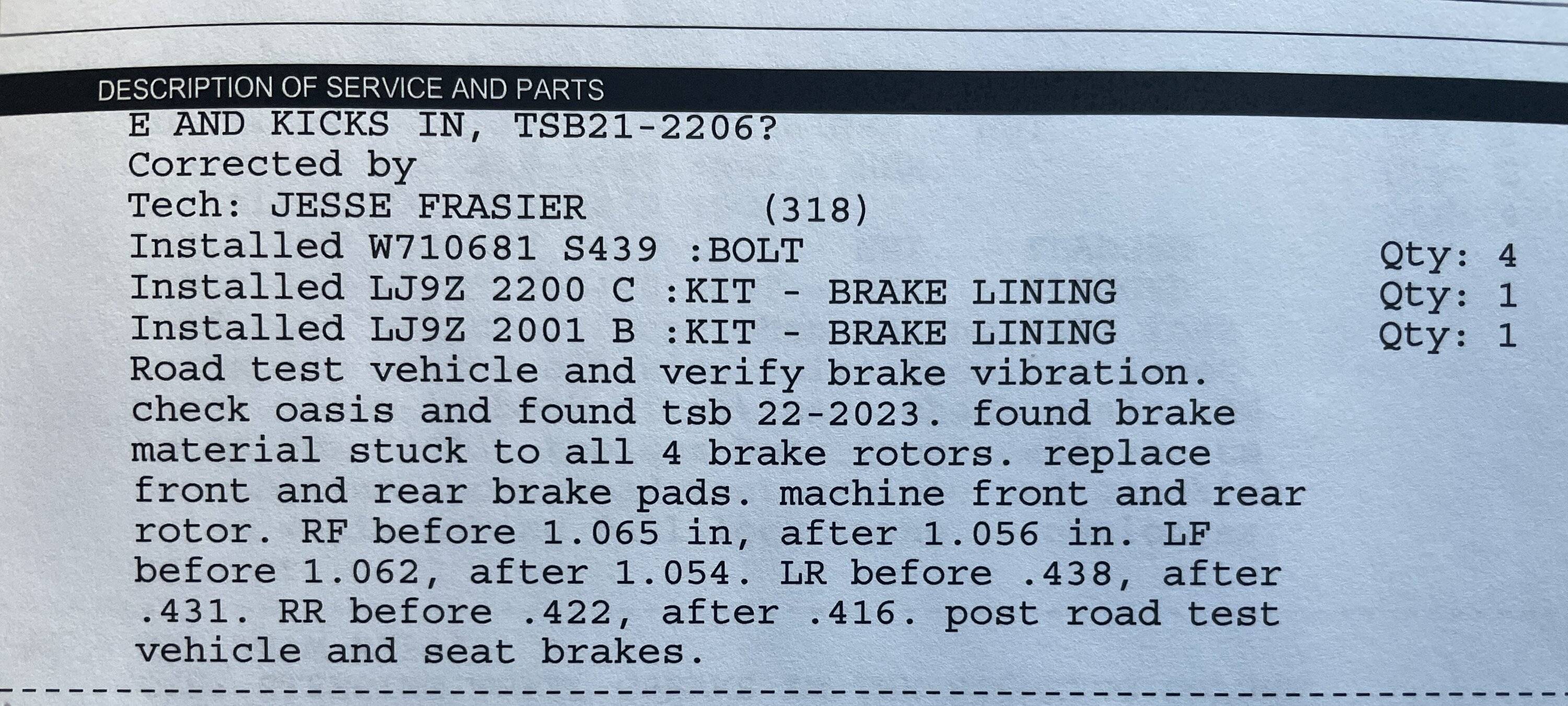

Dealer has replaced the pads and turned all rotors about 250 to 400 miles ago. Today i was once again spending quality time with my Steeda Front bar and when I pulled the tire off I found this.
