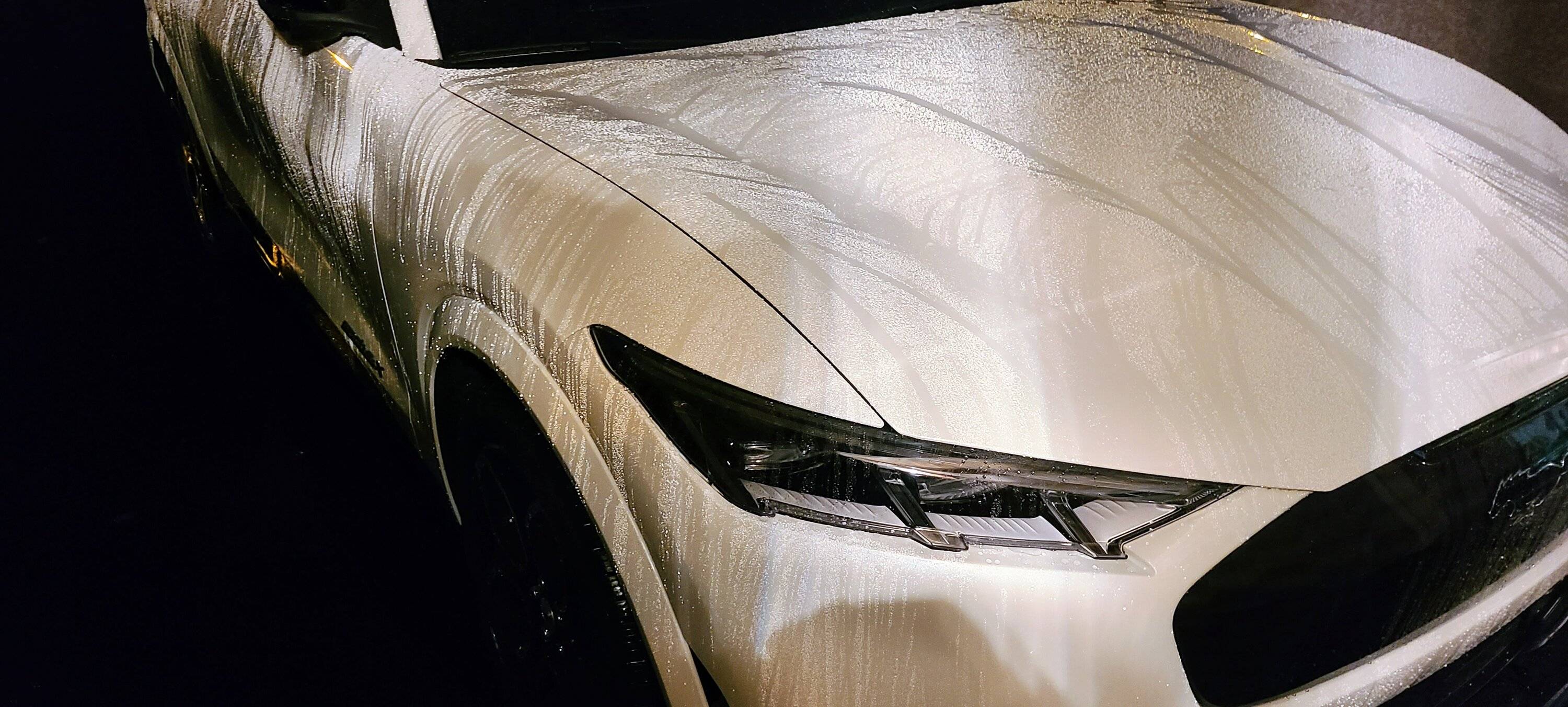

I did Adams Graphene Ceramic myself. The key is prep - I did an iron remover, clay bar, then a quick touch up polish and prep spay before applying. It's hard to capture in pictures how good it looks (particularly in Star White). It hurts to look at in direct sunlight without sunglasses and it glows at night under light when water is beaded. Can't comment on longevity yet, but time will tell.
