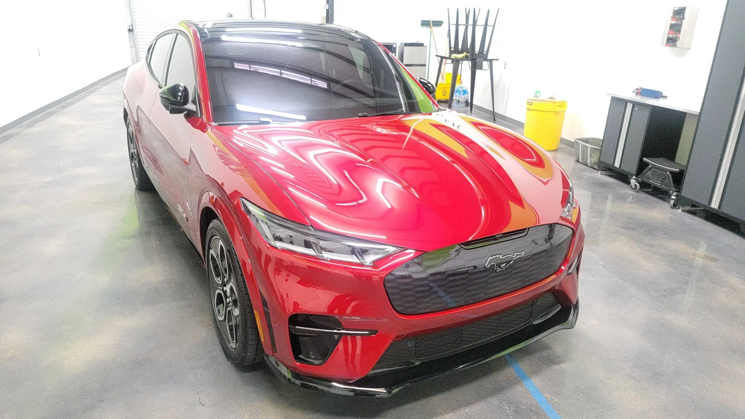

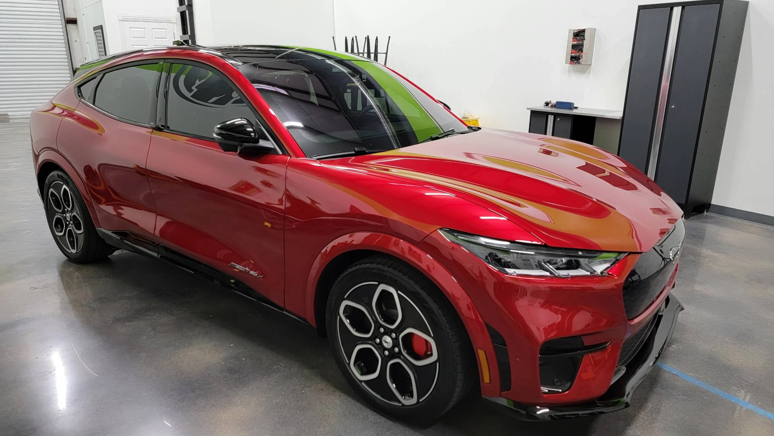

On the way to pick up MME GT. Can't wait to see the final product. Took delivery Saturday. Tint front d/p windows and front windshield, plus ceramic.
Congratulations! Hope you love it as much as we do. :)
