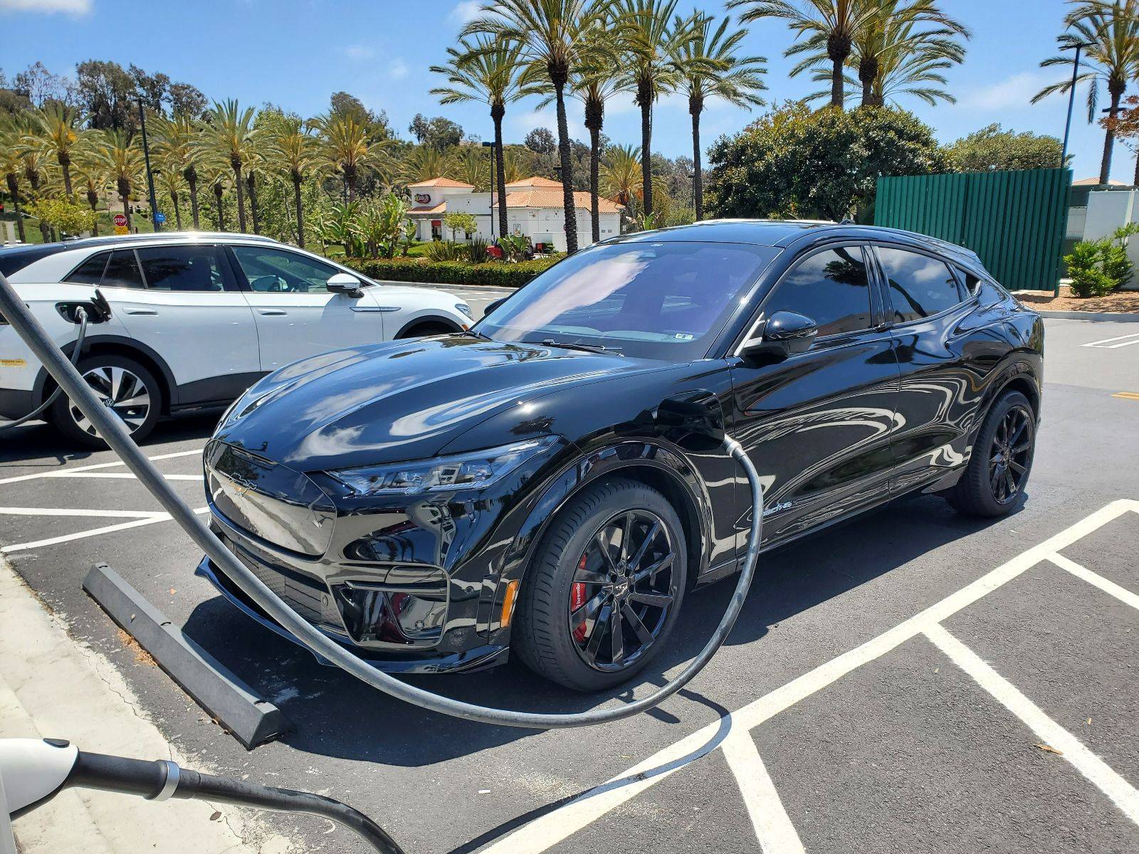

I'm a body shop guy... with 3 collision centers... I think it's an expensive wax... pay the extra money for the clear bra... and make sure you get the headlights and GT grille done... painting the front end is about 2000.00 but, the headlights are approx. 1600.00 each and if you have a GT the grille it is another 1800.00... I don't believe any applied coating is going to hold up after several washes... Lastly, most insurance companies will pay for the clear bra/PPF clear decals if they need replacing after an accident... Just my 2 cents...
I don't think I've ever seen a car this shiny. It looks like a mirror. Beautiful!
