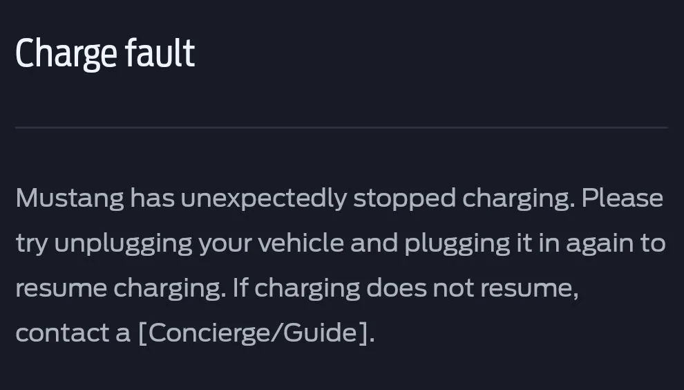

Hello everyone,
I’ve been experiencing a recurring issue with my 2022/07 Mustang Mach E. The “Charge Fault” error pops up when the car reaches its target charge during the night (e.g., at 1 a.m.) and a departure time is set for the following morning (e.g., 8 a.m.).
Interestingly, if the car reaches its target charge closer to the departure time (e.g., an hour before), the “Charge Fault” error does not occur.
Some background:
  • My target charge is set to 80%. When this issue happens, the car shows a charge state of 79% when I check in the morning.
  • This is my third winter using the same charger, and I’ve only encountered this problem since I started using the departure time feature for preconditioning in cold weather.
Here’s what I’ve tried so far:
  • I’ve been to the service center twice.
    1. During the first visit, they updated the charging module, but the problem persisted.
    2. During the second visit, the car was in for three weeks (partly due to a minor accident repair), and they updated all the firmware. However, the issue occurred again shortly afterward.
I’m looking for suggestions on what might be causing this issue and how to resolve it. Could it be something beyond firmware updates, like a hardware fault or a specific settings adjustment? Has anyone else experienced this with their Mach E or a similar setup?
