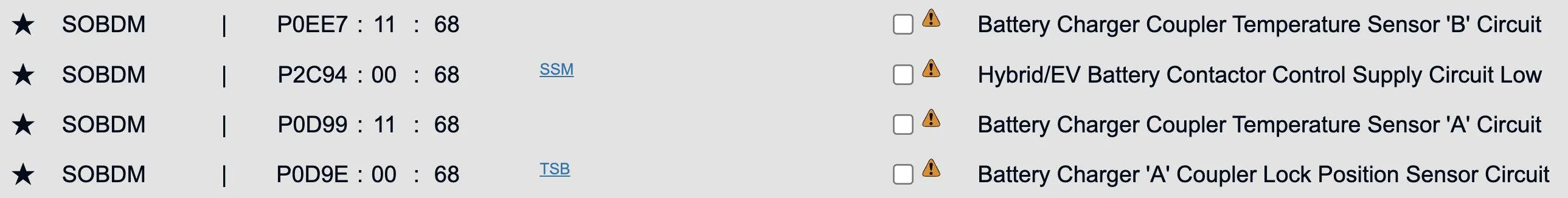

Just another update as mine seriously must have been caused by dirt/debris in the charger connector and/or port. Since blowing them out I have fully charged half a dozen times, two while on a 500 mile trip using public superchargers and it has been flawless. Just saying if you are having trouble atleast try to make sure connector is clean.
263
11,458
25,323
For posterity, here were the codes triggered. These circuits are not part of the J1772 connection, so potentially what's happening is the bad connection is causing the SOBDM to glitch and reset, and setting these erroneous codes even though the circuits are fine.
Ford Mustang Mach-E Charge Fault Dirty Charge port codes
P0EE7 P2C94 P0D99 P0D9E
