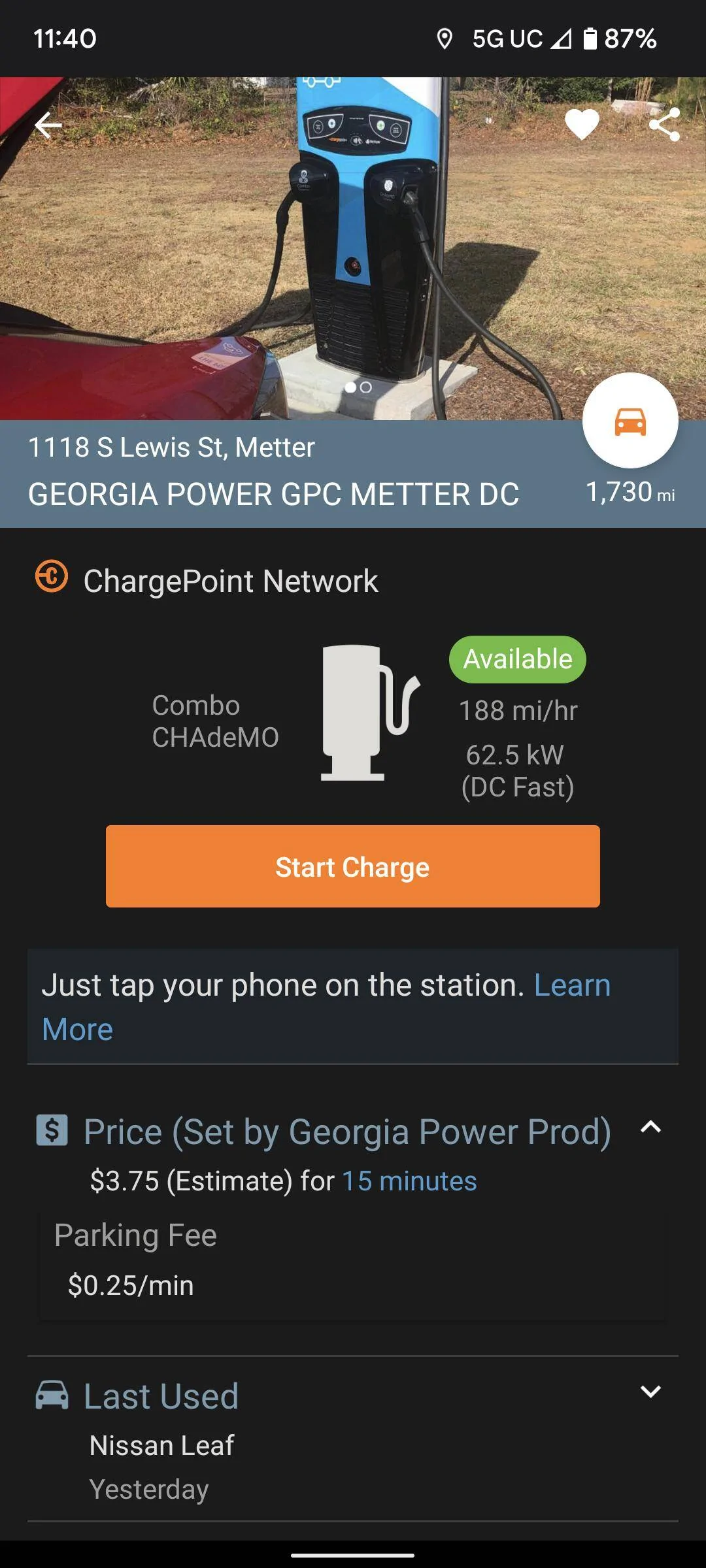

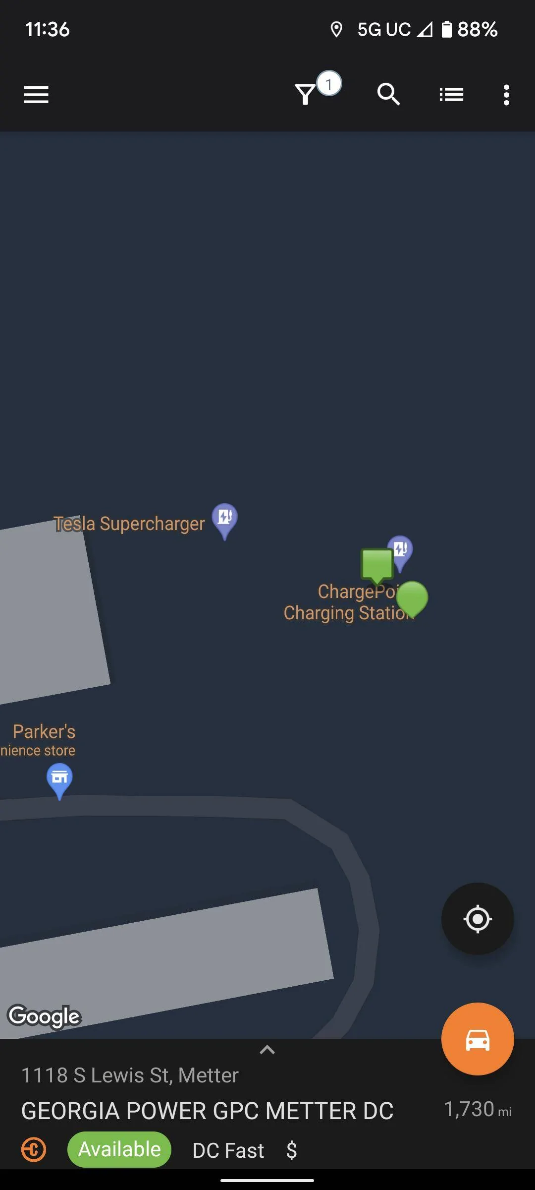

Update - PlugShare app says that was a Tesla SC site so my question remains?

I'm not sure I understand your question?
Sometimes Supercharger locations are nearby everyone-else locations, like this:
Ford Mustang Mach-E ChargePoint crowding? Screenshot_20220406-114018
Ford Mustang Mach-E ChargePoint crowding? Screenshot_20220406-113643
But they probably aren't in any way network-linked to one another.

Coincidence? That site in Metter is where I was. I will keep closer watch on the Ford Pass app. I assume, 8 MMEs trying to charge at the same time might cause the same result.
