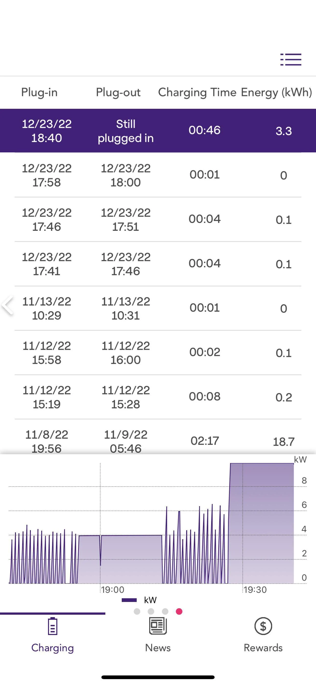

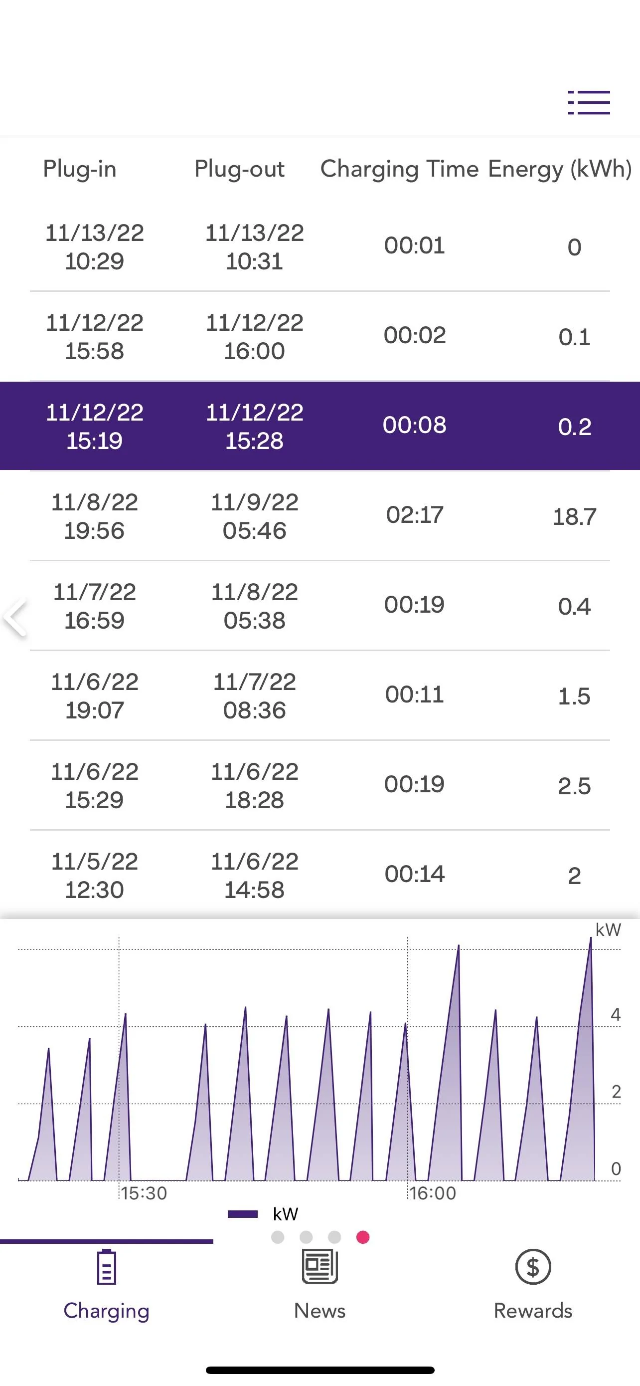

So since I originally posted this and it sorted itself out the car has charged normally on the ford charger ever since. Today, my garage renovations were finally completed and my JuiceBox was reconnected. Plugged it in, the car made a rapid clicking noise and then the behavior started all over again. Would start charging, get to around 20amps and stop. The car would restart and try again over and over. Tried the ford charger and same behavior. Went back to the juice box and lowered the max amps to 16 and it stopped. Car sustained charging on 16 no problem. Any time I tried to raise it, same behavior. I finally put it on 40 and just let it sit there doing it. After a while it sorted itself out and fixed itself again. At this point I have no idea if it’s a software issue or a hardware issue, but it seems like every time I plug in a different charger than the main one it sets the car off on a frenzy. Then it sorts itself and is fine. Any ideas? You can see the behavior in the attached.

Yeah, it's not getting past the initial current ramp for some reason. Maybe you should send me your VIN so I can take a look.

Yeah I'm not seeing a whole lot, this is a strange one. Could be a software glitch or could be hardware, I'm not sure. You might have to take it into the dealer for this. A reminder if you get a charging error, shut off the car, unplug the charger from the car, and wait 5+ minutes before trying again. I guess just try to deal with it until it resolves or a fix can be found.
