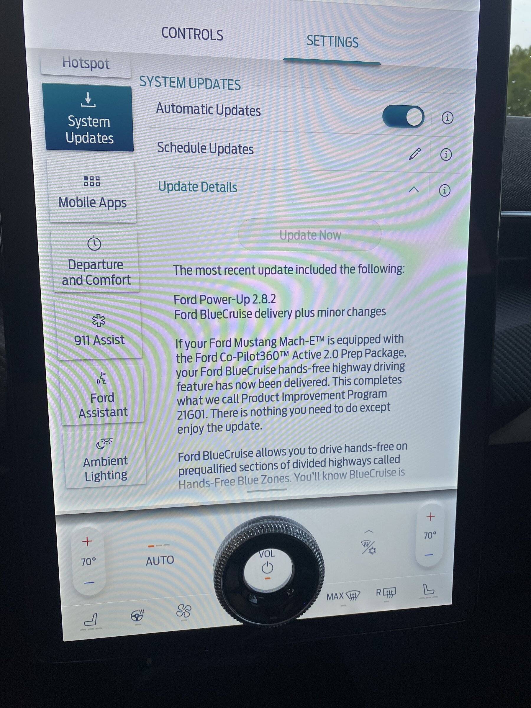

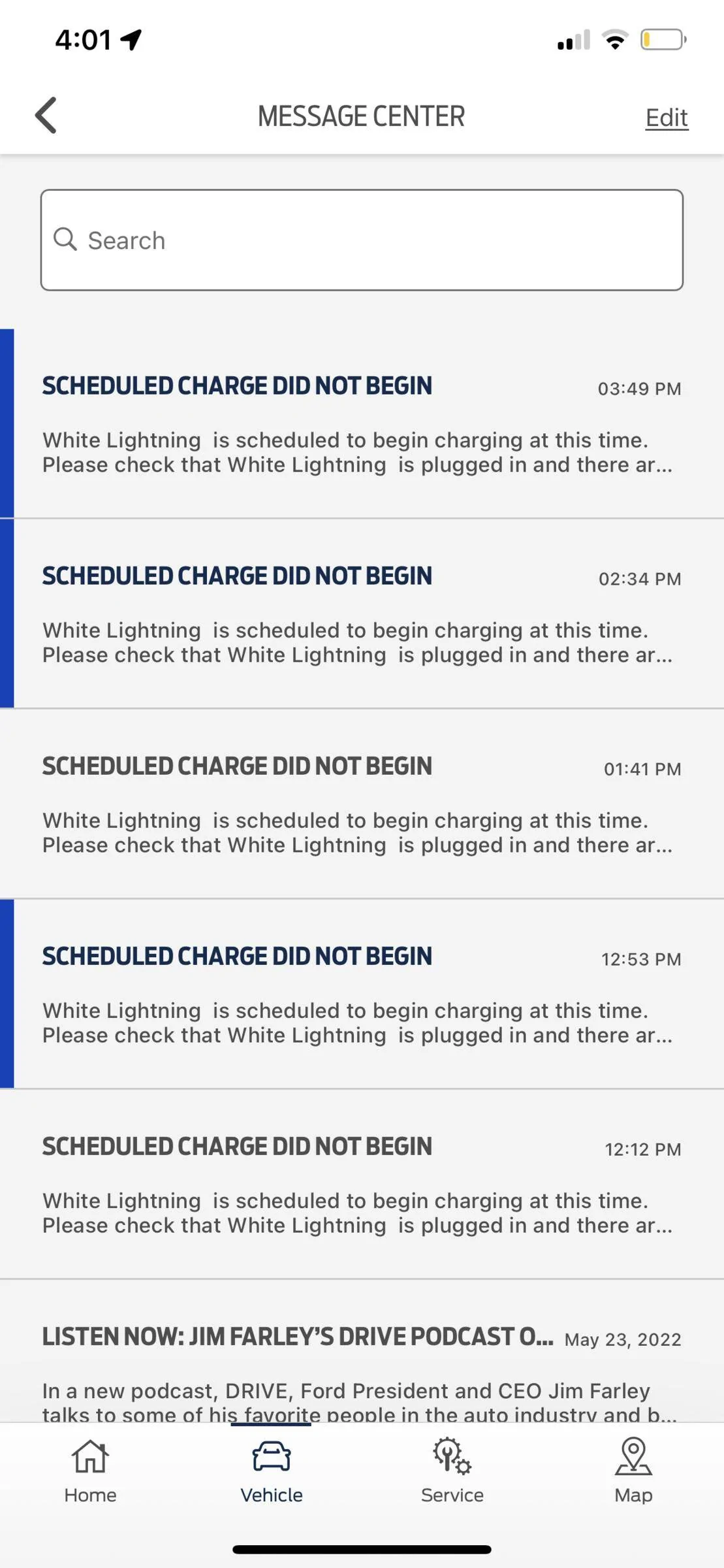

Hello all,
After being stuck on 1.7.1 since November of 21, my dealer updated my car to the latest update. This took a few days but they got it. That was in April. Fast forward to this past week and my car for the first time since November received a OTA. Now I’m no longer able to charge above 32 amps. Sometimes it will charge for a few hours, or for less than an hour. I first noticed this at work and thought maybe there was an issue with the charger. It’s a 80amp ChargePoint. I reset it and still got the message. The car just freaks out over 32 amps. I came to this conclusion because at home I have the Ford connect charger and I can adjust the amps. I love this car, but at this point I’m exhausted on the glitches and dealer visits. I’m hoping this can be fixed by another OTA. Thoughts or experiences with this? @Ford Motor Company

Can you clear your schedule settings and location settings in the charger and also on the car? And set it to Charge when plugged in and see if it still happens?

I originally thought this was the issue as well. I deleted it and it still does it. Just doesn’t like 42 amps or above now. I haven’t tried DC.
