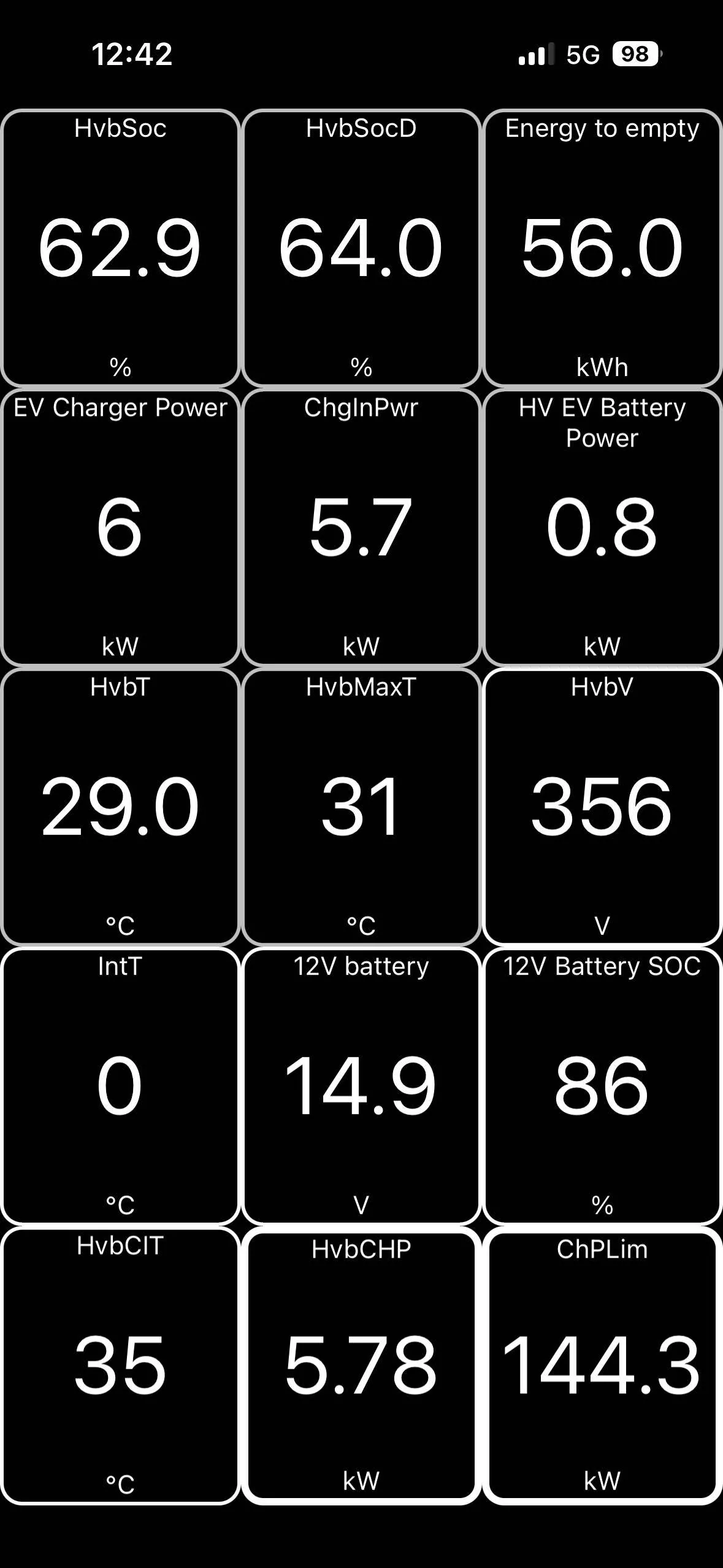

Like the majority of us, my 2021 Job 1 was stuck on 6.1.0. Two weeks ago the new OTAs started arriving.
in order : 6,2,1. - 6,3,0. - 6,4,0. - Priority Update 23-PU0722-DC-CHG3. - and then, 6,2,0 ??
During the 6.2.0 update I received two charge anomaly messages. Once the update was completed, charging seemed to have resumed normally. But that really wasn't the case.
Now, as soon as I plug into an L2 charger, the car consumes more than 5.5 Kw to heat the battery and keep it between 32C and 35C. And as it is winter here, the cold means that to maintain this high temperature the car consumes more energy from the battery than what the charger delivers. Therefore, the battery charge decreases during the period the car is plugged in.
Yesterday I received OTA 6,7,0 I hoped that would solve the problem. But that didn't change anything.

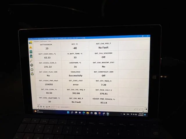

The car also acts the same strange way during fast charging. Which she has never done for over 2 years.
I reset Sync, cleared charging preferences, tried different chargers, nothing seems to solve the problem.
In short, it's currently impossible to charge on a L2 charger
Has someone already had this problem?
Do you have any suggestions?
