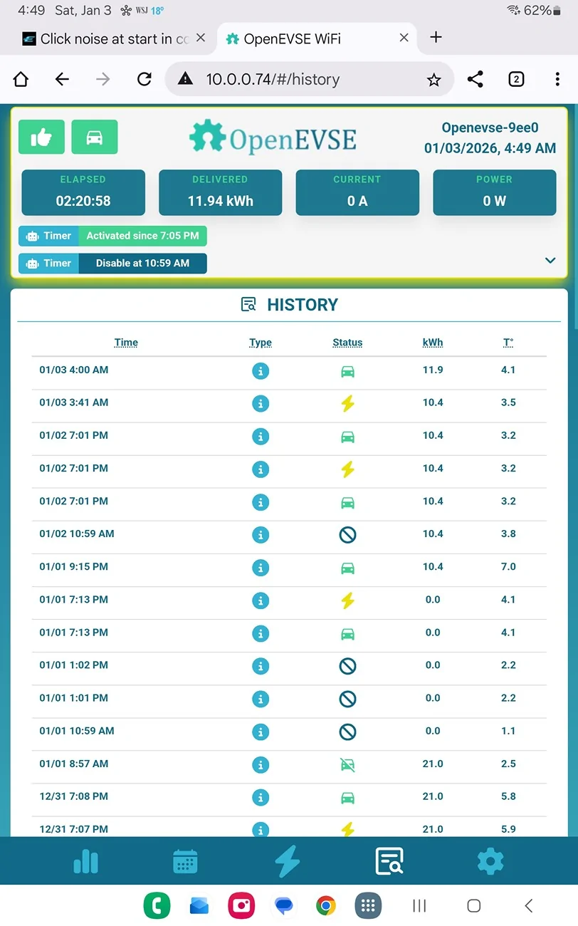

My car warming itself for 19 minutes overnight. 1.5kWh.
