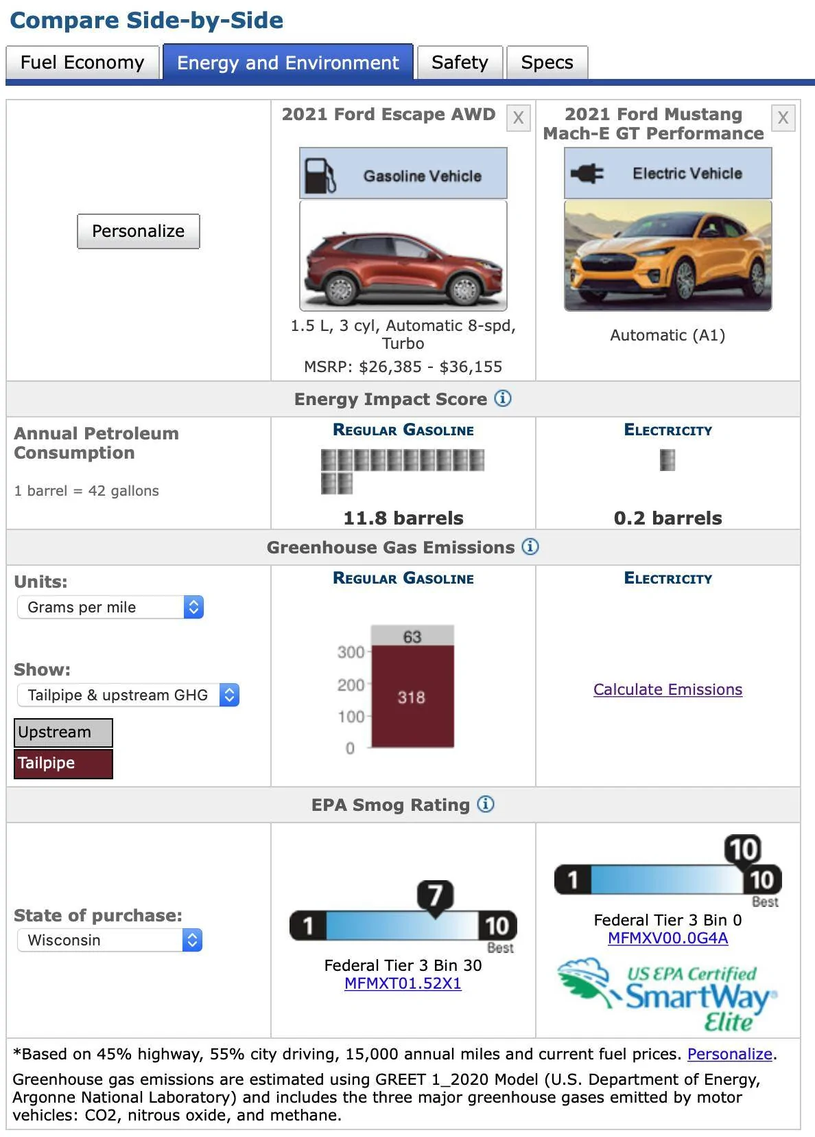

What I've always found astonishing is that it's almost impossible to find g/mi numbers for gas/ICE vehicles. Why aren't these numbers published like the EV numbers are? My guess is because if you look at the ones published by some of the mfgs you'll see that higher mpg vehicles can achieve 50g/mi in emissions (cited). Of course there's other impacts such as refinement and drilling etc that one could argue and boiling a number down to a gallon seems hard to find. Additionally, since we derive NG and LPG from refinement how much of the refinement GHG actually account for the per gallon of gasoline number? I would love for someone who has that data to present it in a non-biased way. I think education and truth behind the data is fascinating.
8.78 kg of CO2 per gallon of gasoline is emitted (source). So you could do your own math with the fuel economy. FuelEconomy.gov also lists grams of CO2 per mile for most cars.
Ford Mustang Mach-E Climate Impacts - No extremism will be tolerated! Screen Shot 2022-02-13 at 1.09.24 PM
If you click the Calculate Emissions link then and enter your zip code it will show you your CO2 per mile with your local electricity mix (seems based off regional operator data spanning multiple states). Your total Todd would be 110 g/mi, so about 4x better than the Escape. This doesn't account for CO2 emissions from production from what I can tell, which are much higher for EVs. So there's this idea of a "carbon break-even point" when the total lifetime carbon emissions from an EV would be less than a gas car, which depends on your electricity mix and vehicle. For you in CA, I think it's probably only 30k miles but for me where most electricity still comes from coal, it is more like 60k miles before I'm saving the planet. Buying a new car every couple years isn't good because of the upstream emissions, you're best to try to drive every car you buy for as long as you can before getting a new one if you want to be really green.
I posted a couple times in later posts that I missed it, but it's been pointed out to me a few times.
Yeah here's my issue with that number and why I feel there's a lot of deception. In California and a lot of states we are encouraged to charge at night. Even if we aren't encouraged to, most people are at work during the day. At night the energy mix is far more carbon intensive and the numbers online are averages throughout a 24 hour period. It's like saying it's 80 degrees all day, when that's just the high and it's actually 35 at midnight.
