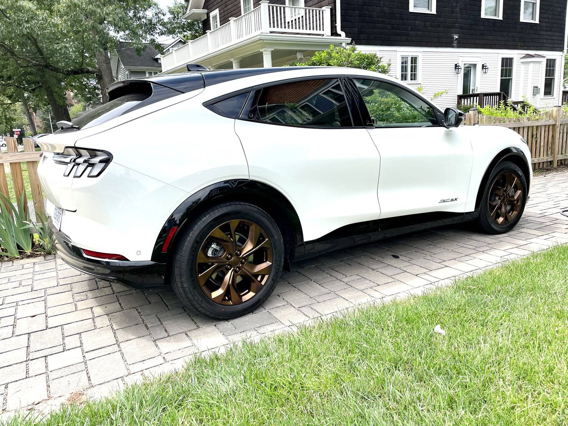

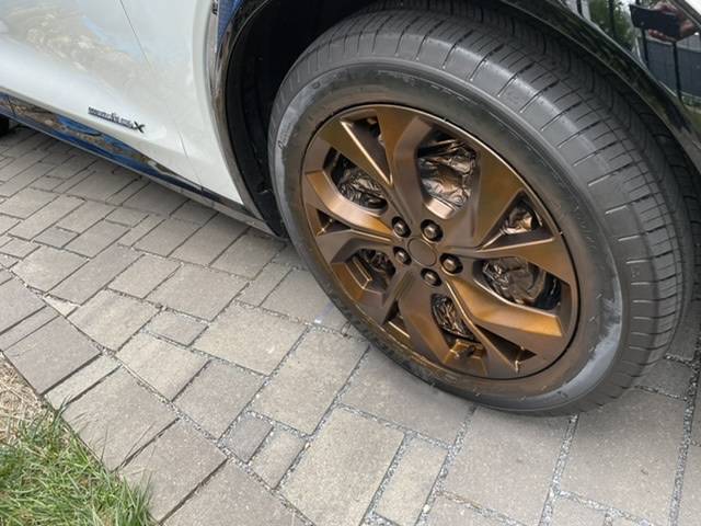

So I didn’t pull the tires. I masked the brakes and calipers with plastic sheeting (the kit comes with strong clear garbage bags but a plastic drip cloth from Home Depot works just as well). The kit also comes with dip release—rub that on the tire and the dip won’t stick well to it. It peeled off almost by itself. Just make sure to consciously overspray onto the tires to get full coverage.
One thing I would have done differently would be after 3 or so coats of plastidip, get in the car and move it one foot forward or backwards to rotate the wheel a bit before the last couple coats to make sure I got all of it.
Also: super important: whatever road dust you leave on the wheel will interfere with the plastidip adhering to it. It’s pretty inconspicuous, but there are a couple spots that peeled away due to dirt. I’ll address those at some point, or I’ll just cut them off.
FWIW it was your avatar that made me think copper on star white. It’s a really great combo with the black trim. Im also enjoying the chunky look of a solid copper wheel as opposed to the two toned original.
I’m also thinking I will dip the pony emblem on the back and the Mach-e emblems on the doors in copper to match. And if I’m feeling frisky, I might add copper racing stripes on the hood and back, but that might be overkill.
