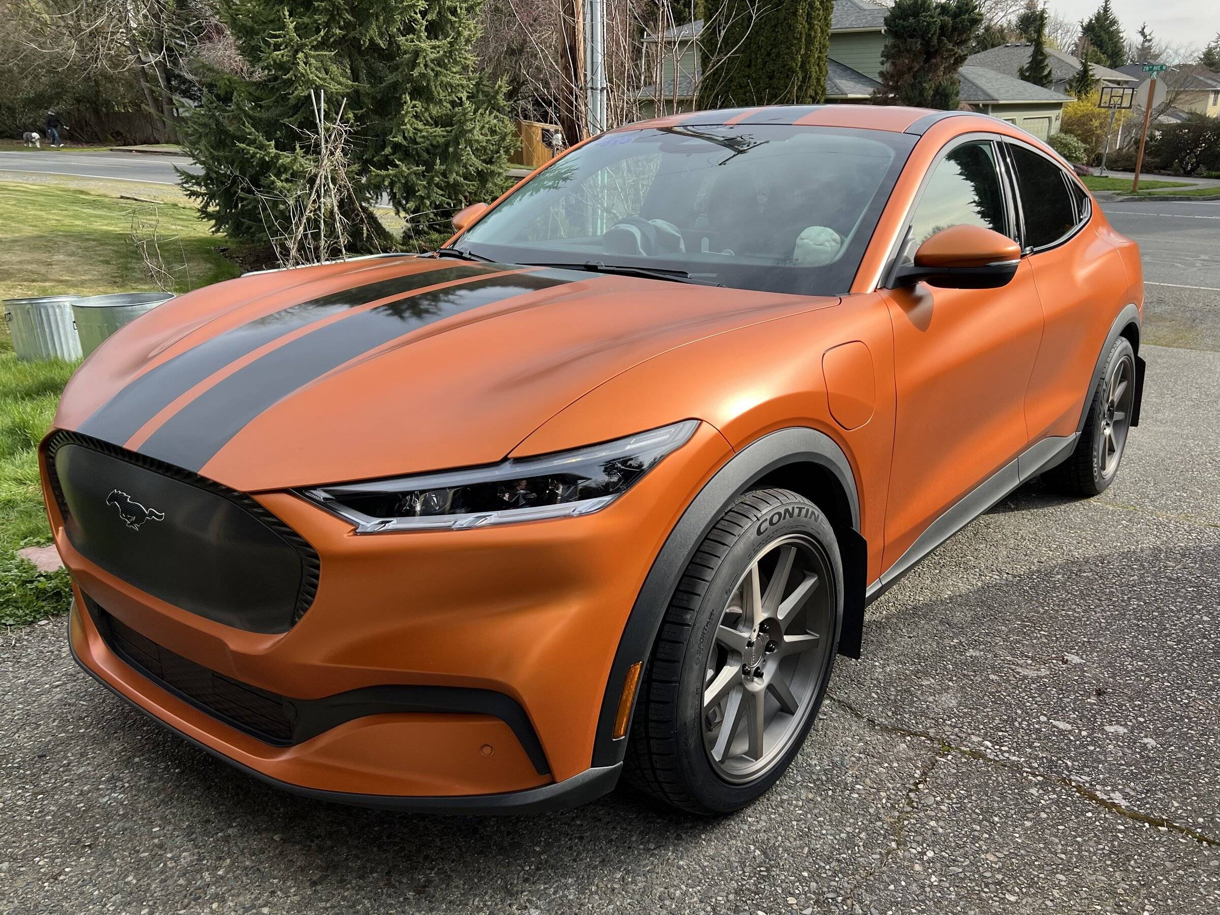

Satin Verde Wheels - mounted up last night and ceramic coated this morning. So happy with the finish matching up with my wrap.

Looks great! How is the poke with 35mm offset? Did you need centering rings?

I’ll measure tomorrow for numbers - but no poke with the 245 section width.
The shop didn’t have rings to fit between my bore and the wheel bore - so they mounted and torqued while on the lift. I’ll probably buy some myself for when I eventually pull the wheels for some other issue.

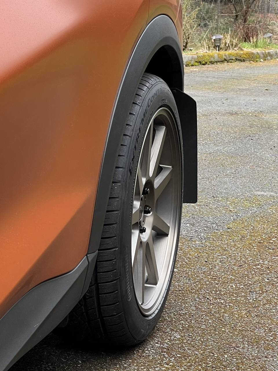

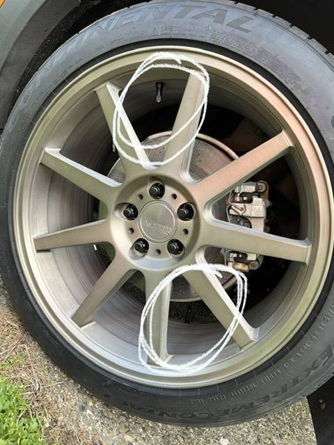

What really gets me is the two valve stem holes - one inbound and one outbound in at opposite radius.
Shop put the tpms on the inward side as it allows the sensor to sit flat on the rim and the standard non sensor stem is on the outward side.

Thanks for the measurements and the closer photos, the Verde VFF01 or 02 have been on my list, though I was unsure about the +35 offset. I see they are also available in an 8.5” width with +40 offset, which would probably work too.
Why would it have two valve stem holes? Not sure what the reason for that would be…

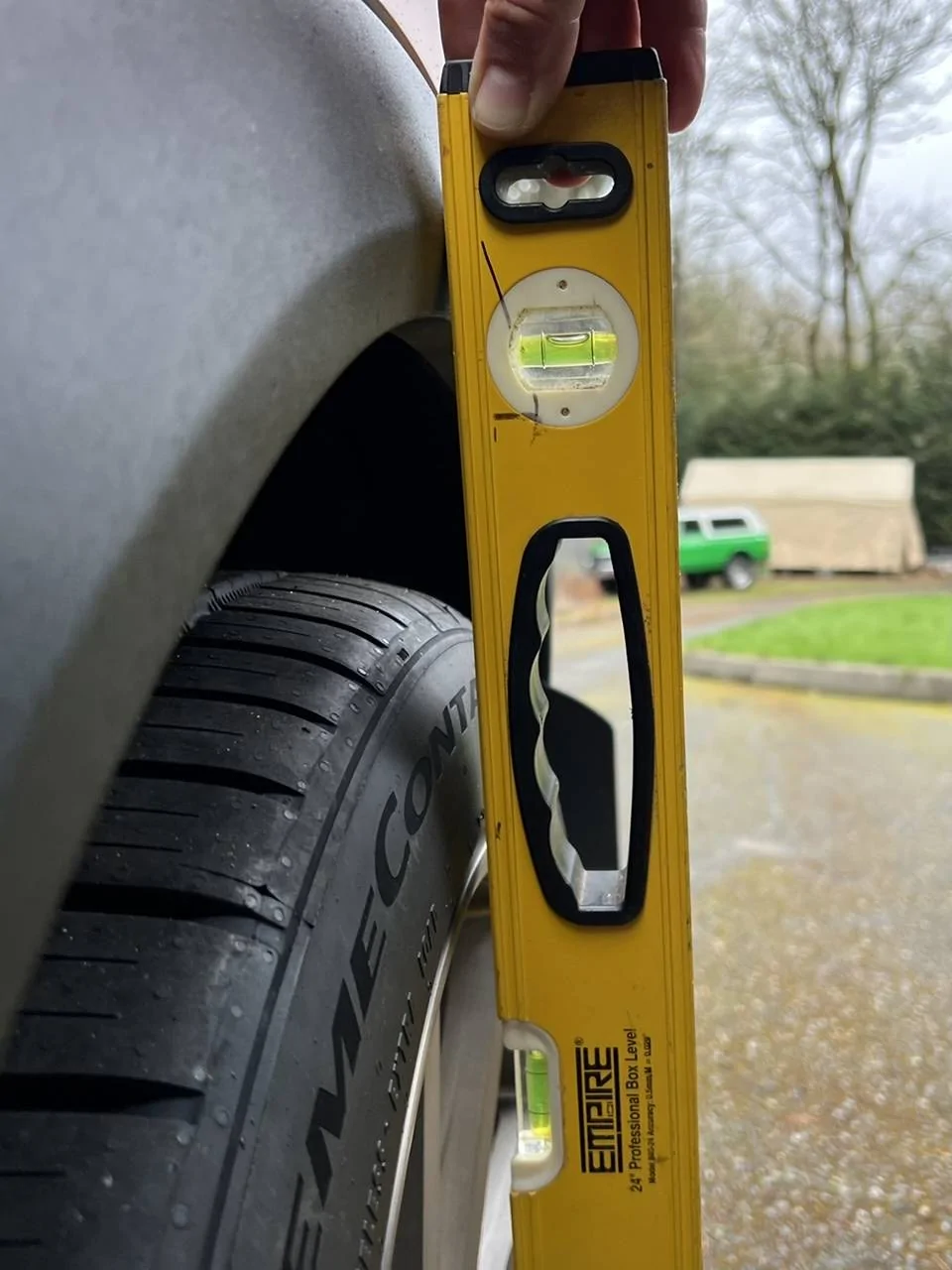

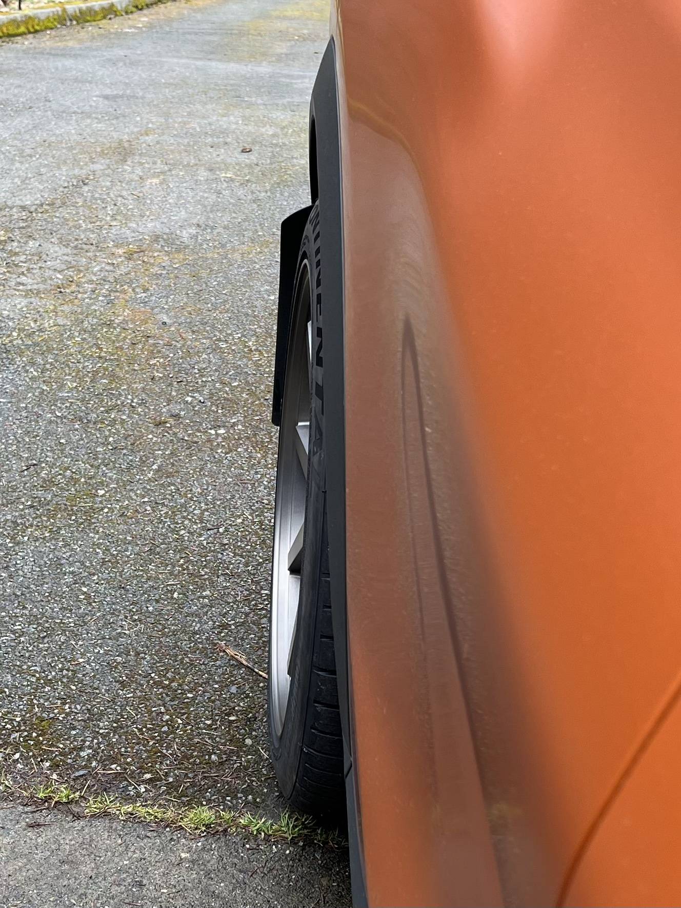

Here ya go - hope these help -
Thats perfect, thanks! Looks like the 9” with 35 offset is just about the max you can go on poke without getting past the fender flares. I love the look and that helps narrow things down for me a lot.
