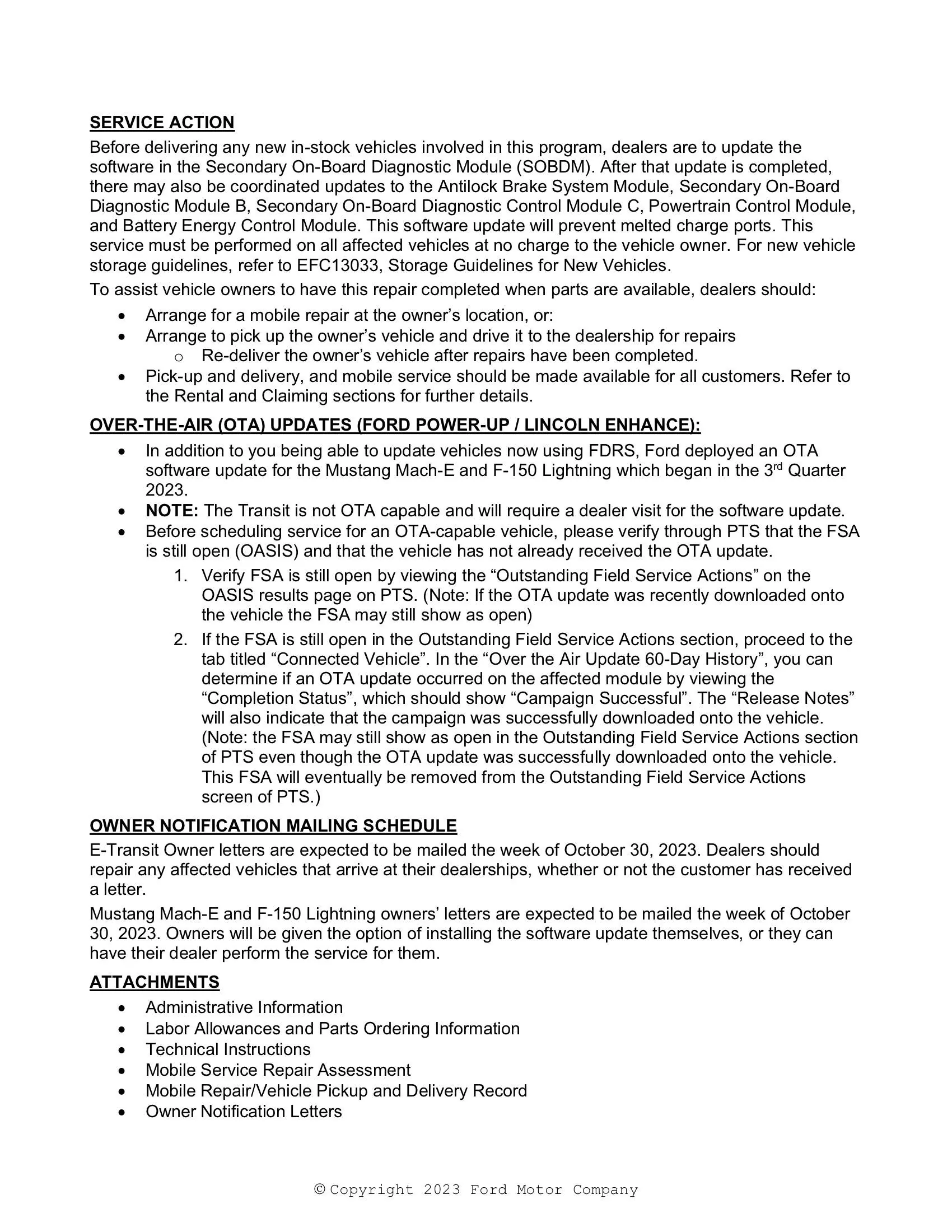

2021 AWD Premium:Back on November 17th, I used FDRS to update the SOBDM, ABS, SOBDMC, PCM, and BECM modules, all of which should have brought me to PowerUP 6.6. Additional updates were done on January 25th for SOBDM, SOBDMC, and PCM modules.
However, as of today, CSP 23B50 is still showing as needed for my VIN.
Can someone post the exact file versions I should have in these modules to clear the CSP from my VIN? I realize I can take the car to the dealer but if possible, I'd like to avoid that hassle just to clear the CSP.
Thanks in advance for any assistance you can provide.
