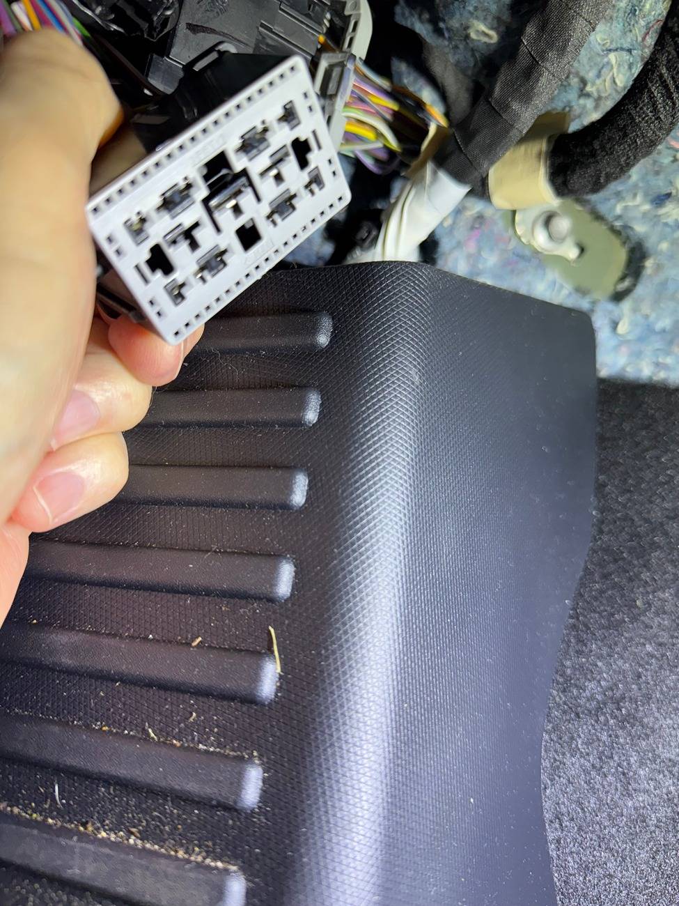

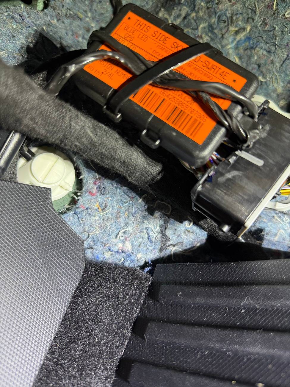

Son of a b*tch. Looks like I found one of these trackers under the dash, and there is a connector into a cable harness, but it's not an OBD-II connector that it plugs into. There are two wires, red & black, which have vampire taps on the back of the OBD, and that appear to be power connectors to that orange device. Can I cut the wires?
I did know that the dealership had something because it showed up in FDRS when I got the car, but when I went in a day later, it had been disconnected (at the server side).
and there is a fuse in line with those power wires. I am going to pull it and see what happens.

Well crap! The car is bricked now. Once I pulled the fuse, I started getting a bunch of errors, the car asked if it was still plugged in, and it is completely locked up. I tried replacing the fuse -with great difficulty - but no luck.
Tomorrow, I'll try disconnecting the 12V battery. Otherwise, it will have to be towed back to the dealership.
