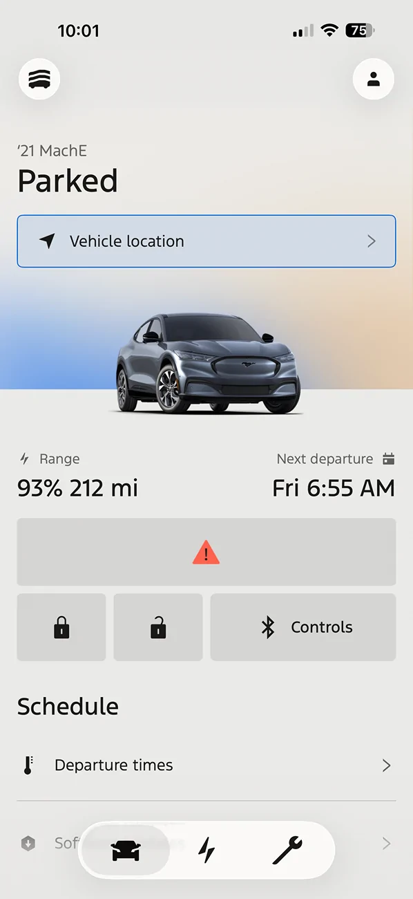

SOLVED!
TLDR: Try disconnecting the 12V battery for 10 minutes and then reconnecting. If that doesn't work, try the process below, and then the battery process again.
Posting my resolution here in case it helps someone else. Ford Support installed the tokens on my car and I submitted the issue multiple times, but I never received any guidance or troubleshooting advice. I appreciate they are active on the forum, but actual guidance from the support team is very lacking.
Symptoms:
  • Remote climate start failed from FordPass (yellow warning triangle after “Starting…”)
  • Lock/unlock worked normally
  • Vehicle status refreshed normally
  • Charge % and location updated correctly
  • Departure conditioning also unreliable
  • Onboard Modem Serial Number was blank in the vehicle settings at one point
Here’s what I tried (in order):
Full reset steps attempted first (no fix):
  • Removed vehicle from FordPass
  • Removed vehicle from ford.com account
  • Deleted all driver profiles
  • Removed both phones from SYNC
  • Reset Phone-as-a-Key
  • Factory reset SYNC
  • Re-added vehicle and reactivated
  • Verified Remote Start settings enabled
  • Verified Connected Vehicle settings enabled
  • Confirmed hood / doors / liftgate closed
  • Reset remote-start counter
  • Alarm reset sequence
  • Climate baseline reset
  • Moved keys away from vehicle
Still failed with same warning triangle.
Then I noticed:
After doing a TCU sleep reset (turn off car, move both keyfobs >25 feet away, then restart), the modem number came back — but remote climate still didn’t work.
Final fix that solved it:
Disconnected the 12-V battery in the frunk:
  1. Disconnect negative terminal
  2. Wait ~10 minutes
  3. Reconnect
  4. Start vehicle normally
  5. Turn vehicle off
  6. Lock vehicle
  7. Retry remote climate
Remote climate started working immediately after that.
Conclusion
Looks like the TCU ↔ HVAC authorization state got stuck after the modem reset. Even though FordPass connectivity worked (lock/unlock/status), remote climate still failed until the 12-V reset forced the modules to resync.
If your modem serial number disappears or comes back during troubleshooting, I’d try the 12-V reset before going to the dealer. Fixed it instantly for me.
