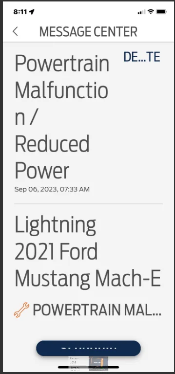

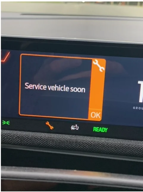

I received this warning on the car and the Ford Pass App this morning after pulling out of my driveway on the way to work. I did charge last night (Level 2) - Juice Box. The funny thing is I really don't drive this car very hard. She's more my "Baby" than my muscle car. ( I get my "thrills" from the 67'). So, it has not been DC Fast charged in about a year and she is really never been driven "hard" as I have read from a lot of the members with HJVB failures.
I have an appt. with Ford Service on Friday. It seemed to drive ok to work, but I did park her nose out just in case.

I'm a Job 1 car. My car was ordered and pick up July 2021. Exact build date can't recall off the top of my head. If I had to say April 21' jumps to mind as build date, but don't quote me on that. Premium Long Range. No OBD reader. When I called the dealer this am he says there are a bunch of "communication error" codes that started yesterday.

Unfortunately without knowing what codes are stored it is impossible to tell for sure. I know a lot of people relate the SVS message to a failed HVBJB, but since there are so many other reasons for a SVS message, I wouldn't always jump to HVBJB.
It's cases like this that illustrate why with a car like this it is almost mandatory to have a simple code reader.

No, it literally did this on the way to work. I did call and the Service guy did see multiple codes.
I believe we have forum members who will run a VIN and can get the codes...Any takers? DM me.

Sorry I didn't see this yesterday. Looks like just the gearshift bug, it appears to be fine today after a restart. Not HVBJB.
Thanks, it took 2 days to for the message to clear from the car. Dealer said there were still a lot of "communication error codes" and wanted to keep it. So, I'm riding the electric bike to work today. Good thing the office is just a couple of miles from the house.
