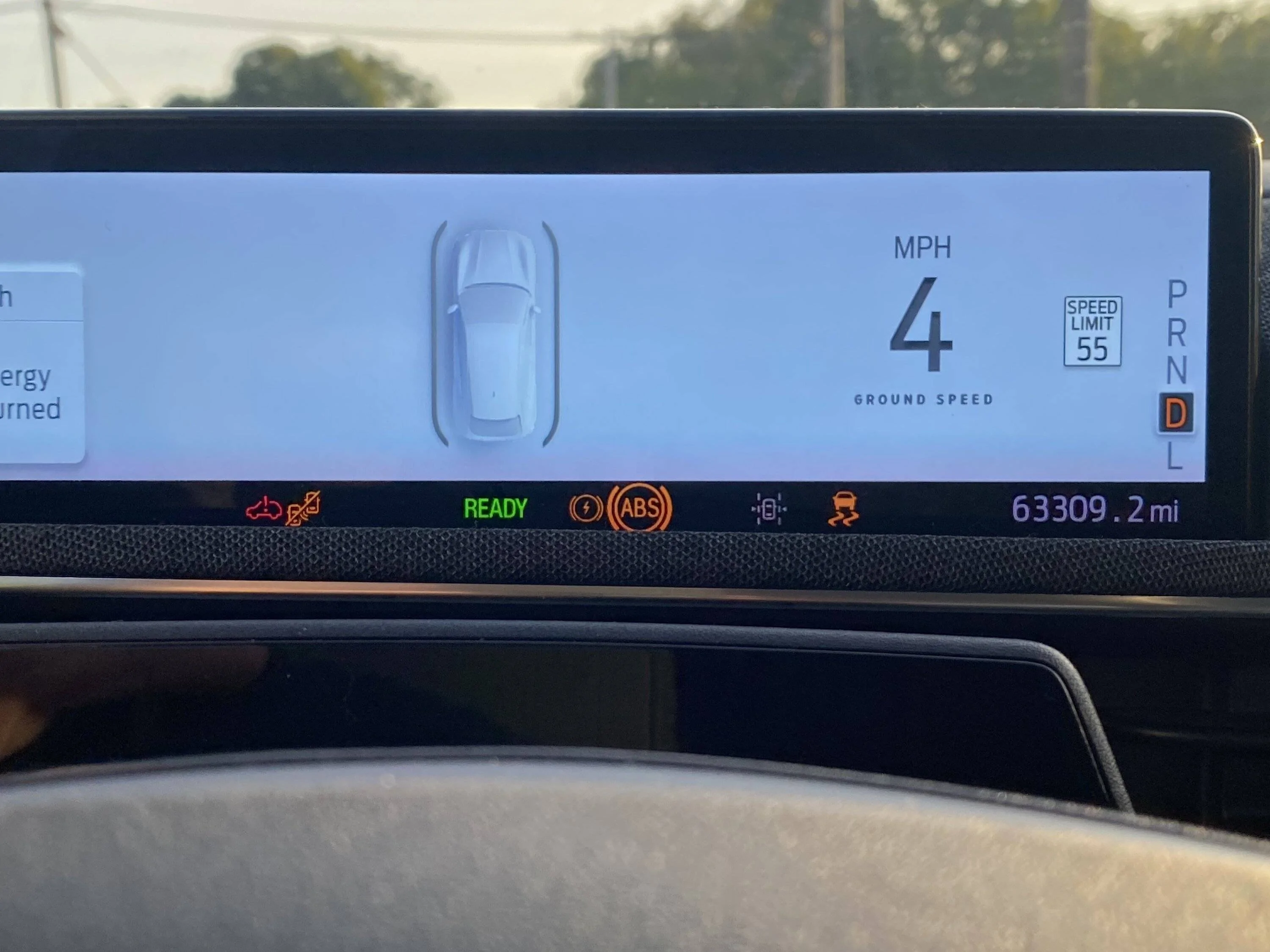

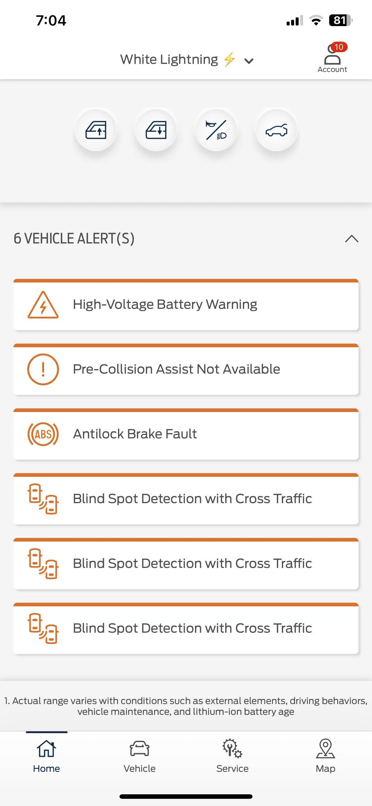

Possibly my first HVJB after 63k
jrdelong1043
Joe
Feb 19, 2021
38
Chillicothe, Ohio
2004 Honda Civic
Utility Arborist
Honestly I thought I would skate by. I commute 120 miles a day to work and average 60mph. I drive like I’m 90…. But I may have been wrong in my thinking of just drive her easily, I couldn’t avoid this. Today the dash was yelling every warning it had at me. The car wouldn’t go over 35 and weirdly would accelerate all by his self without touching the accelerator. I love this car but honesty it’s been a lemon for me. I have a lightning and have been fully investing in Ford EV adventure. Hopefully my troubles will only make their EV better. @Ford Motor Company

With all those warnings, that looks more like a 12V battery issue than a HVBJB issue. HVBJB normally just shows a powertrain malfunction and “service Vehicle Soon”.
JohnFoxeSheets
Jan 29, 2022
28
3,415
5,514
San Francisco
johnfoxesheets.com
Retired Engineer
I agree with Rod. If you share your VIN on the FDRS thread someone with PTS access can look up the status of your car to see what's going on.
Good luck.
