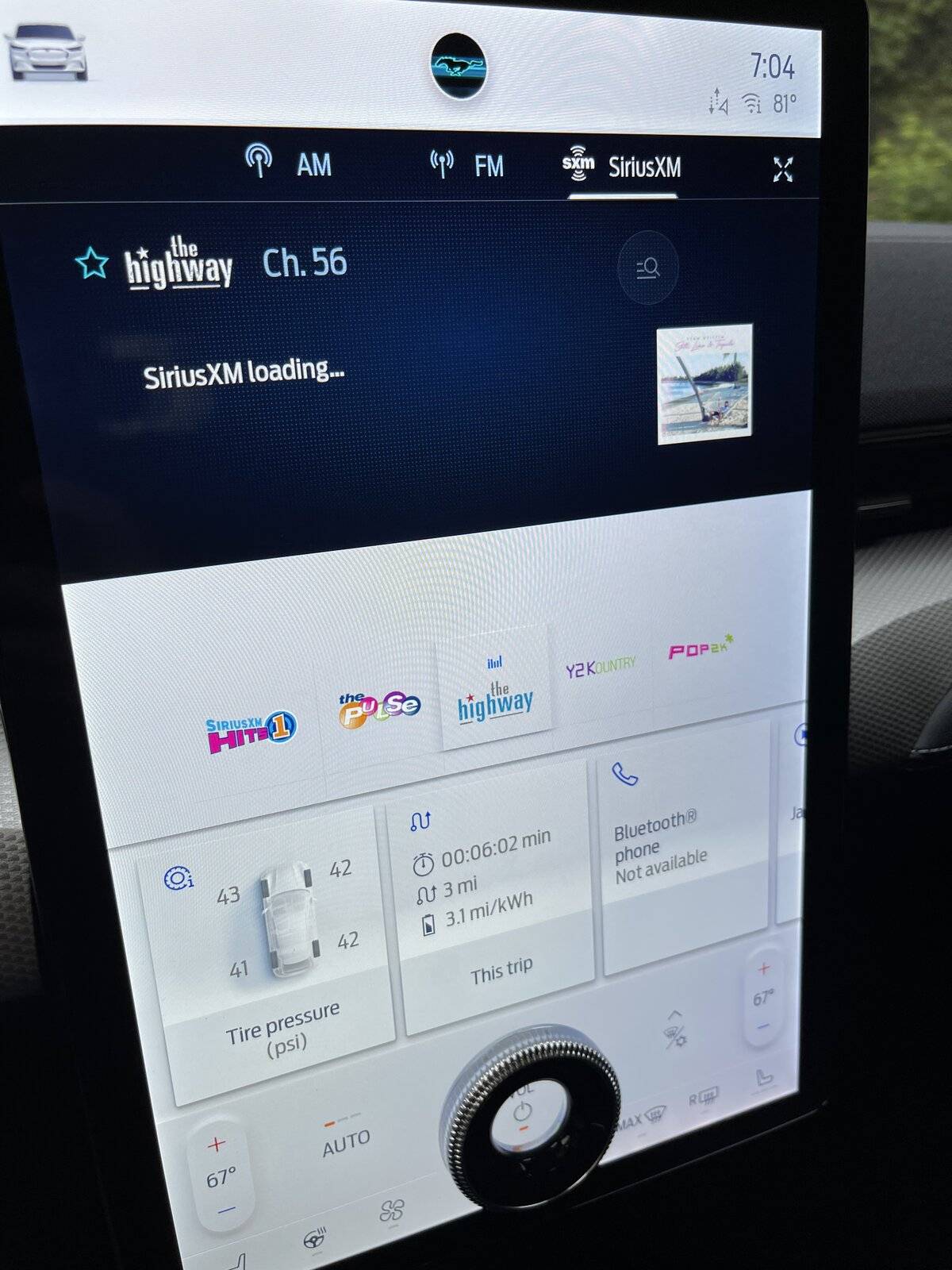

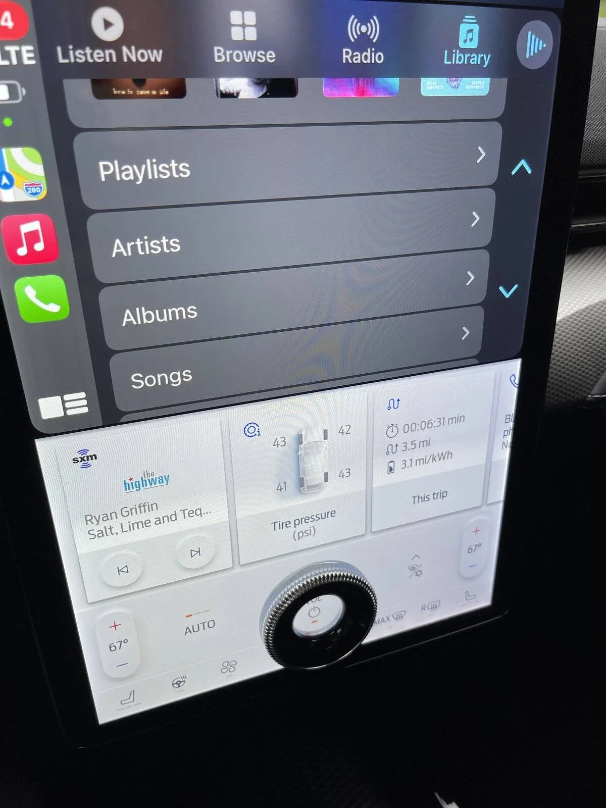

Hello,
just curious if anyone has experienced this issue of the radio info not loading (artist and song name). But will show the info if your in another screen.
Common bug? Fix? It’s hit or miss sometimes I get in the car and it loads up no problem.
Thanks

Hold down the next station > and Volume - buttons at the same time.
When it reboots, it should work better for a while.

Hi guys, just wanted to see it seems that the latest update has fixed this completely. Haven’t had an issue since.
