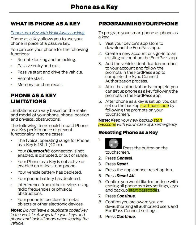

the car does have a start code which is different than the door code you get with the car. You should be prompted to create a start up code when you set up PAAK. It's in manual under PAAK "programming phone"
If memory serves, PAAK isn’t a thing in the UK.

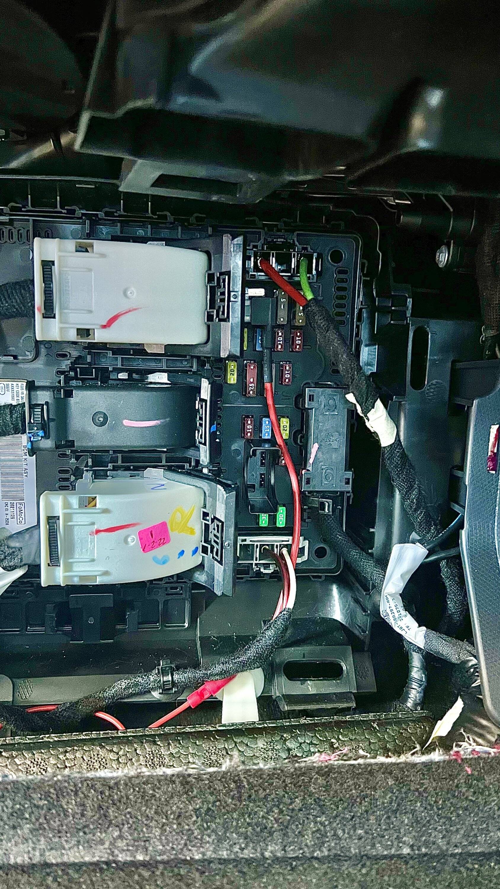

Code is printed on the Body Control Module Sticker which is located in the fuse box. The fuse box is in the passenger footwell on our RHD cars. If you zoom the attached pic you can see the label with the code on the far left.
If you don’t fancy getting on your hands and knees the dealer can retrieve the code electronically by plugging in their FDRS laptop in about 10 secs.
The key code doesn’t add more security, but it will allow you to open the vehicle without the physical key and also allow you to open the frunk and boot using the door panel.
