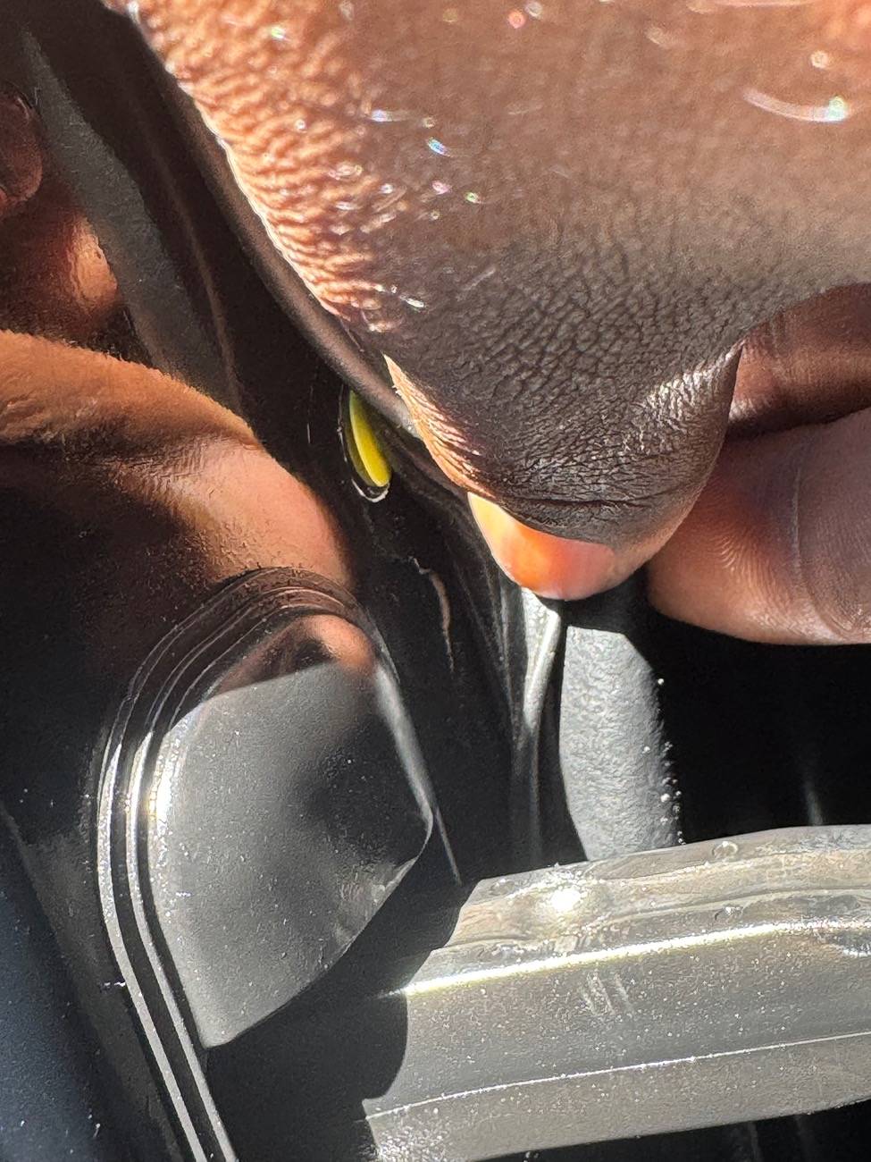

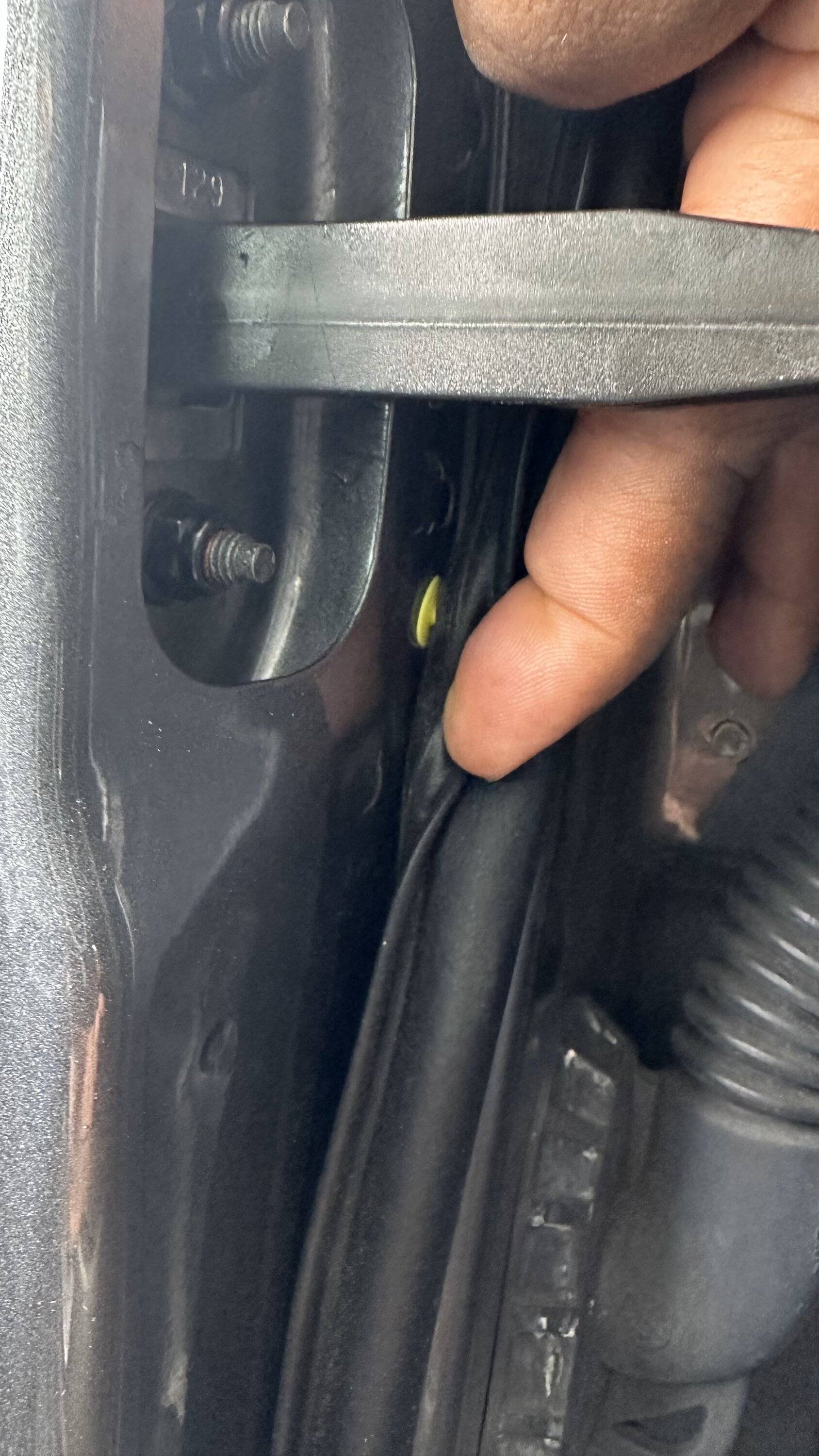

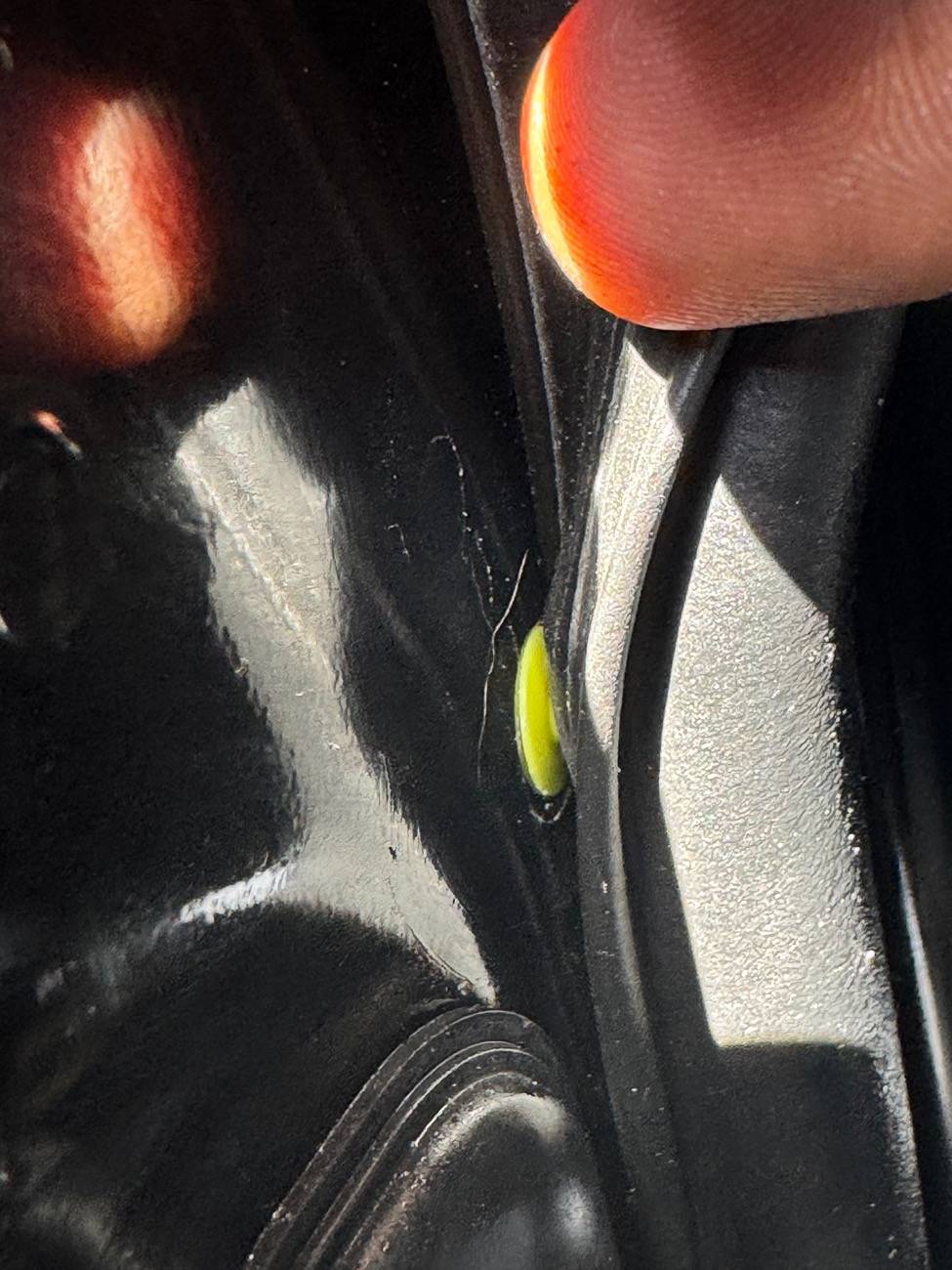

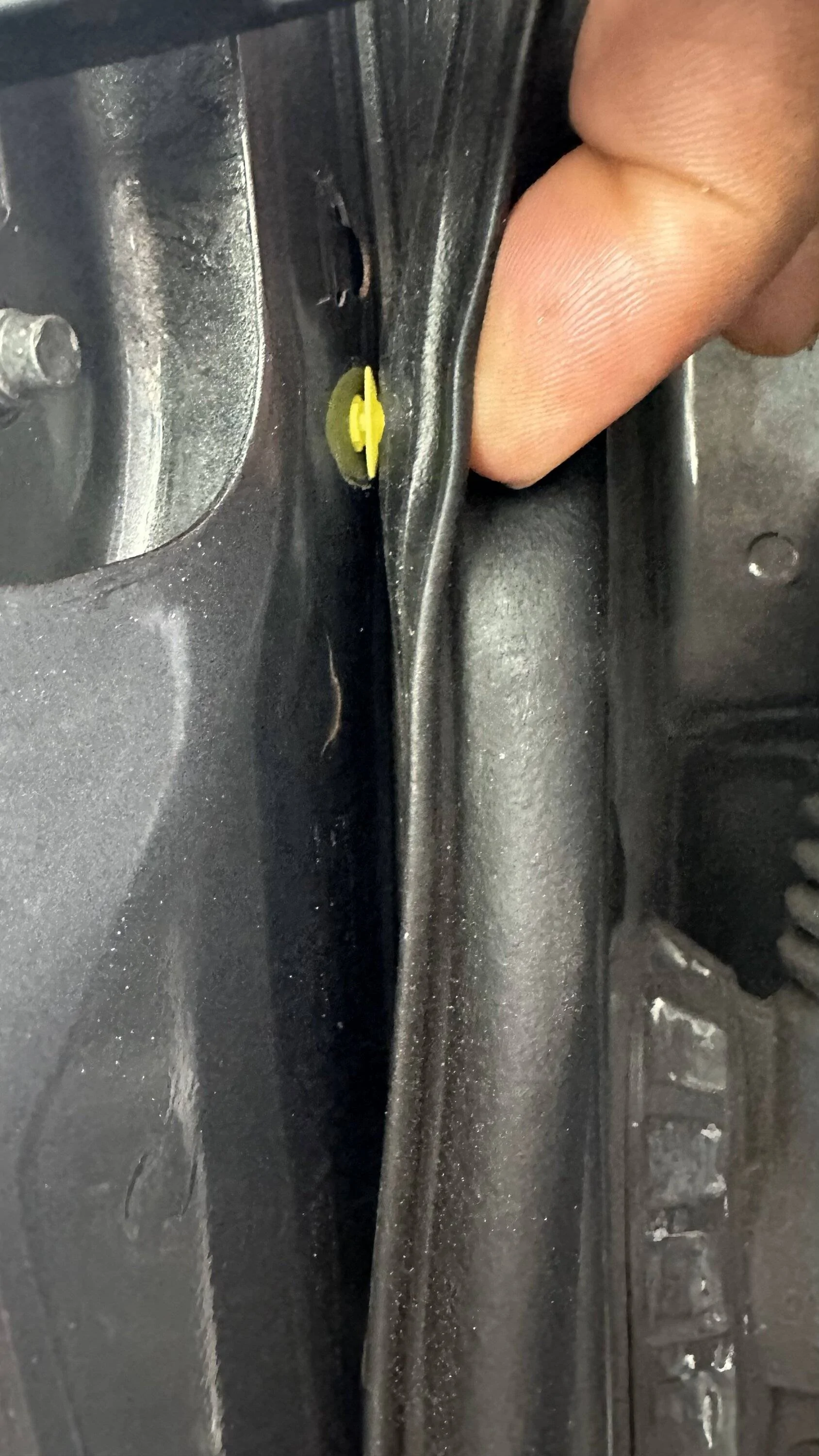

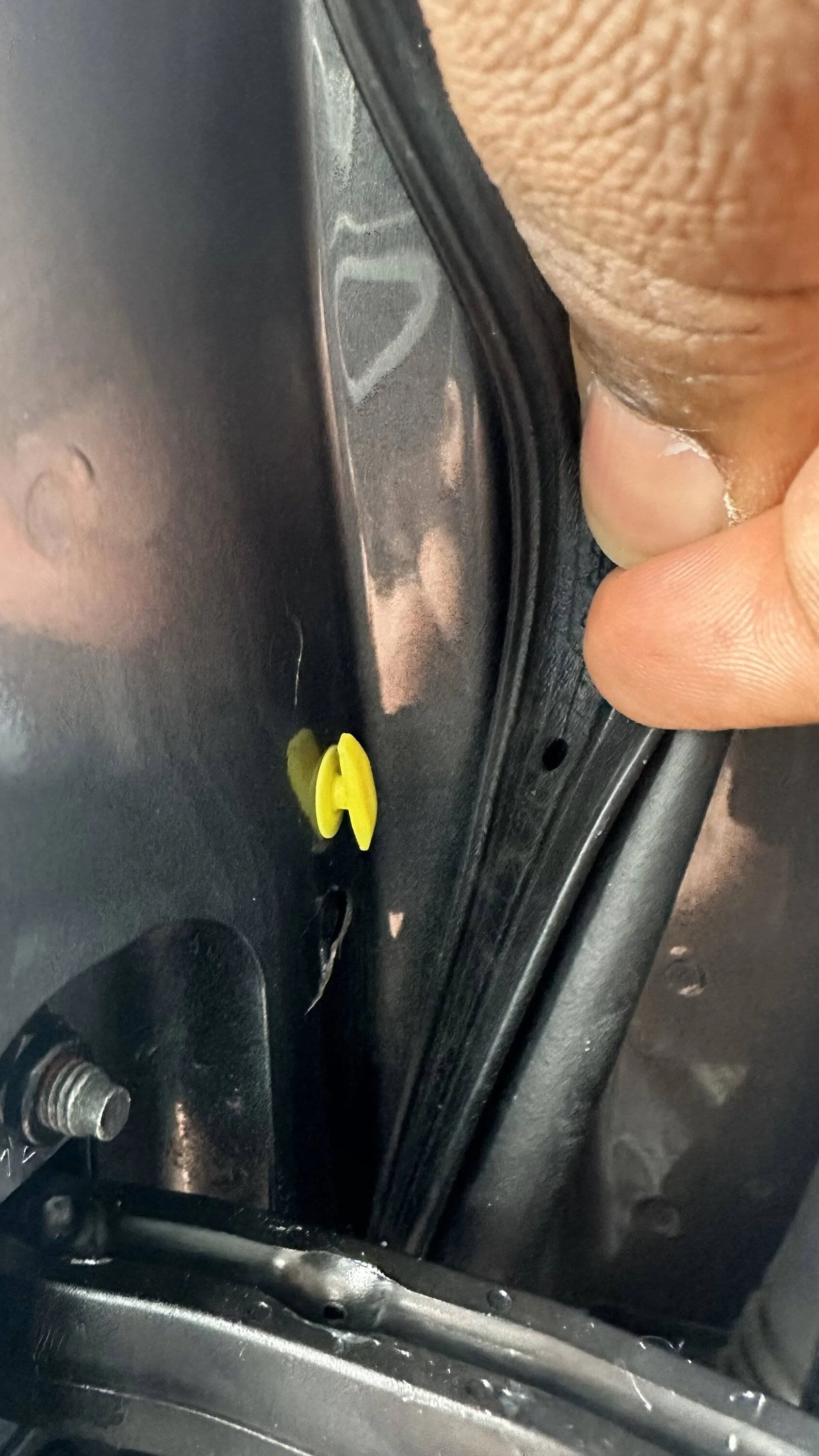

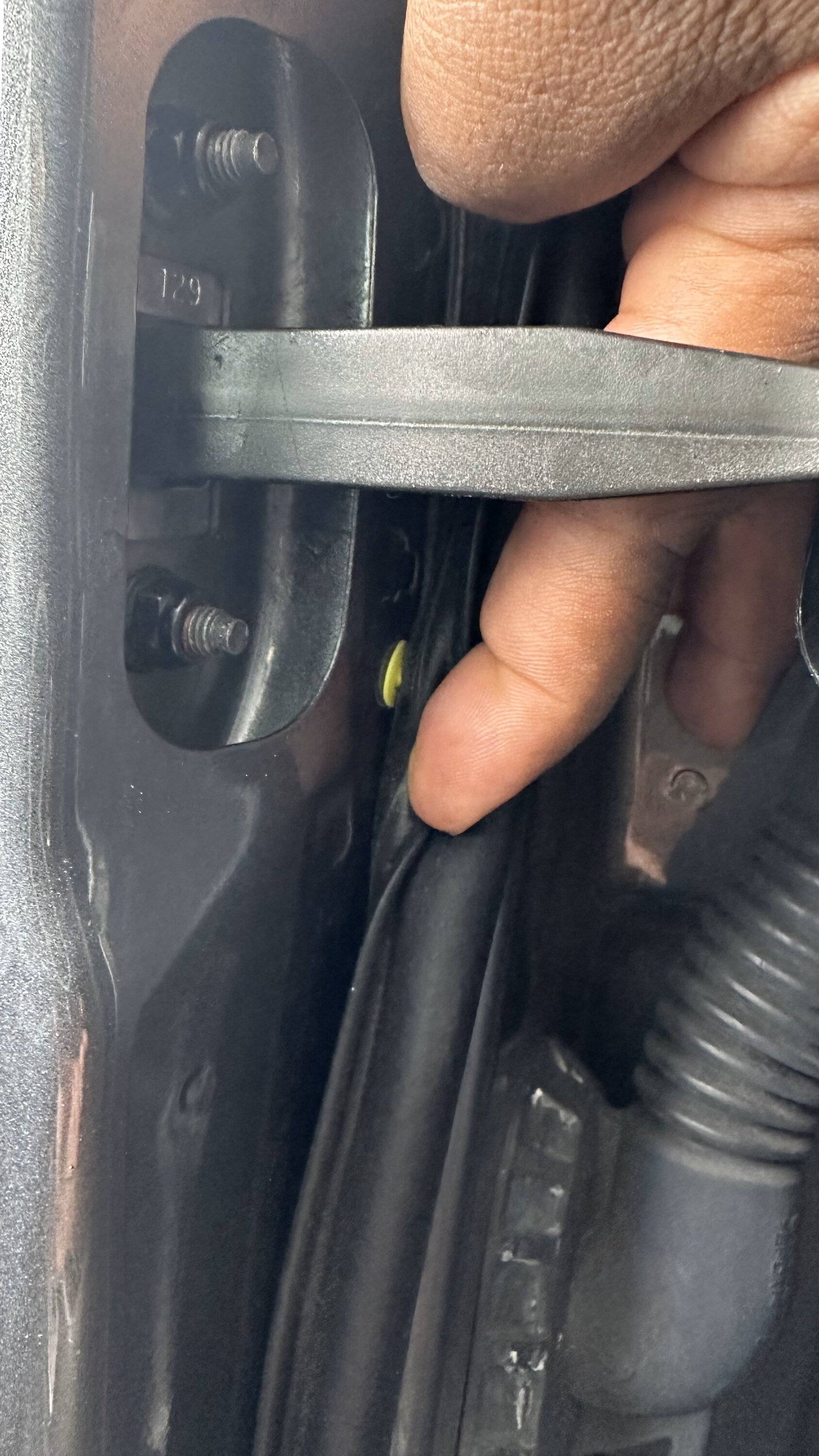

My door creeks driver side 23 gt. After reading and noticing nothing lubes it to stop. I looked under seal and door is cracked. Anyone get this fixed I am still under warranty but also tired of things going wrong with this car.

It's a known issue, here's a couple threads for more info...
Hello all...
I wanted to post this and see if anyone else is having the same issue....
I was hearing a creaking sound inside my driver side door when I open it to get out. Upon further investigation, there are small cracks in the metal near the post that stops the door from swinging wide open. they are not near any hole or spot where a bolt may be. They appear to be defects in the metal of the door. I am attaching pics of it below. I am sorry if it is not clear from my pics. It is a tough thing to get a picture of, but you can see the cracks.
Anyone else experiencing this as well?
@Ford Motor Company Is this normal?

I got it checked by my dealer. Fortunately I don't have damage to the door itself.
I was quoted $300 to replace the door check.
Going to live with it for now.

My door check 'surround' is what makes the cracking noise. Little more dust built up on it and it doesn't wobble and make the cracking noise. Must be my reward for keeping my door jambs clean.
